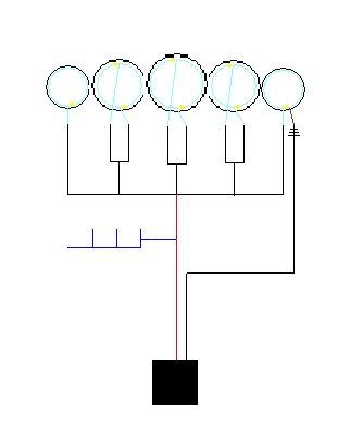

DRACO A5OG 04-06-2009 08:32 AM
Thanks Speed, Safe Journey and Hurry Back!
Here is diagram of my EL-Wire plan:
http://img.photobucket.com/albums/v5...ireDiagram.jpg
With generous report from Speed about entering both sockets on the three center gauges, I decided to split the center EL-Wires so the wires can act like OEM bulbs emitting light thru the sockets and gauge assembly's body. I will test and post.
Each wire would cover half of each radius and end capped.
The gauges are set up looking from the trunk. Clock on the Left, Fuel/Oil Level to the right where the Ground will be connected to the extra Male Spade Ground.
:D Where the hell are my EL-Wires?

DRACO A5OG 04-07-2009 11:29 AM
That is an alternative but the idea would be to use the existing wiring harness that is hooked up to the OEM dimmer light switch, the blue diagram to the left middle of my crappy non-EE diagram.
