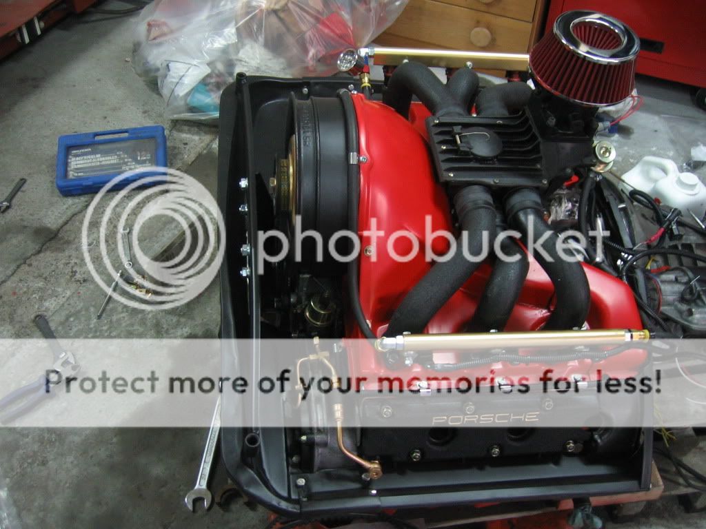

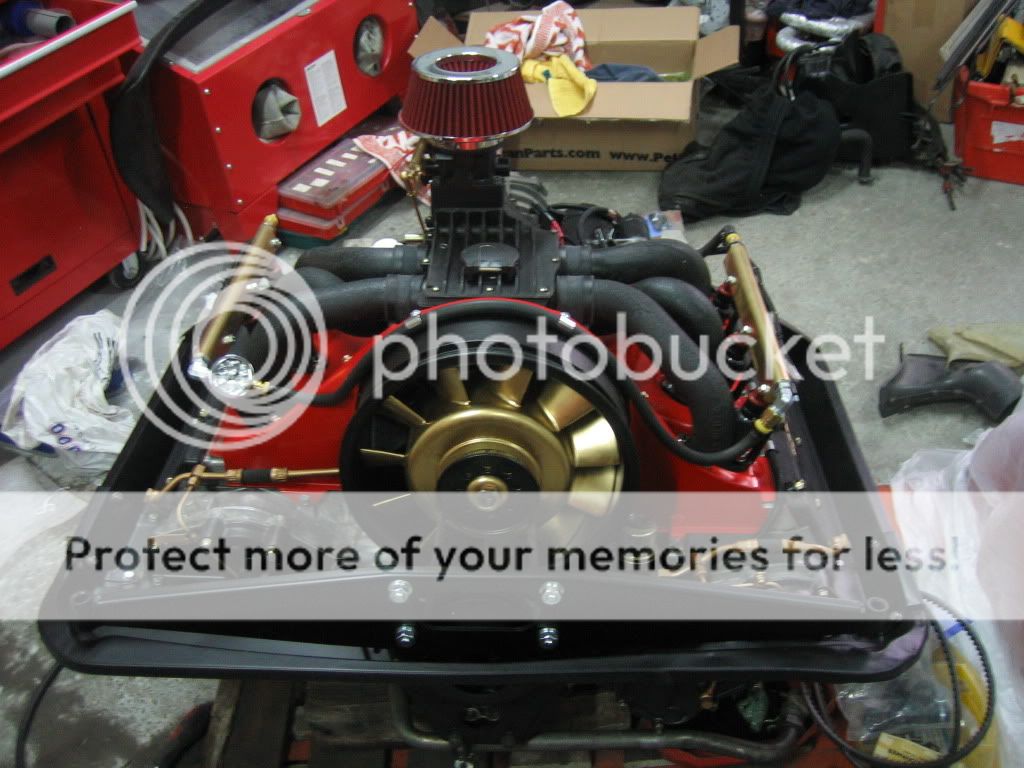

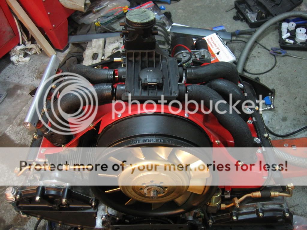

pjo046 04-19-2010 10:15 AM
I went with tBitz. As for ignition control, I opted for an Electromotive HPV 3b. That's an old version of the current XDI ignition Electromotive sells. It is fully programable, so it should work out nicely. My car is at the painter right now, but it will be done by the end of this week. So this weekend I will be starting the installation.
Here are some pictures of the engine as of now. I am going for a clean install, so I remove everything that isn't necessary, and try to route the wiring as discretely as possible. :)
http://i396.photobucket.com/albums/p...n/IMG_1046.jpg
http://i396.photobucket.com/albums/p...n/IMG_1040.jpg
I would highly recommend the tBitz kit. It is great value for the money.
I will post updates as the installation begins, and a video when it is all up and running. SmileWavy

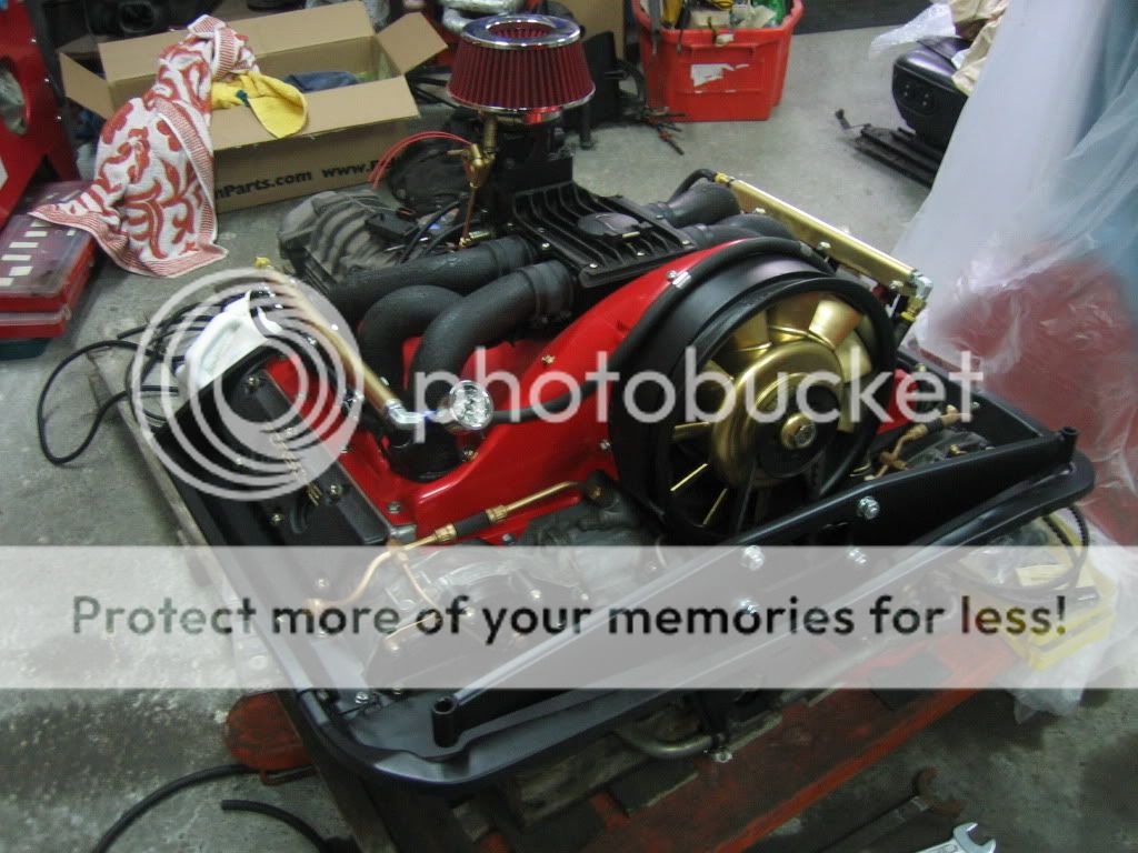

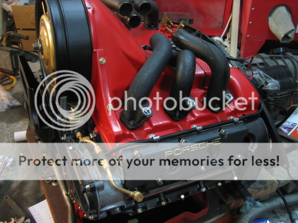

pjo046 04-25-2010 11:51 AM
Now the engine is mostly done. I just need some new cush-washers for the oil lines, new spark plugs and wires, new oil on the transmission, and then it is all ready to go into the car. :)
http://i396.photobucket.com/albums/p...n/IMG_1169.jpg
http://i396.photobucket.com/albums/p...n/IMG_1170.jpg
http://i396.photobucket.com/albums/p...n/IMG_1171.jpg
As for Bitz vs other options: I got the injectors and FPR for cheap, and the same with the Electromotive ignition. So the total wasn't bad at all. I reckon it will be good once installed.
