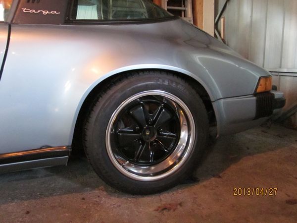

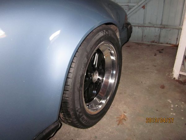

Easy-Off Heavy Duty oven cleaner (yellow can) worked for me, but my results were not consistent. I bought a second-hand set of 16x8's, and did those first, followed by the original 16x7's that came with the car. I was only polishing the rims of the wheels, so I only sprayed oven cleaner there. It took 4-5 applications, leaving it on about 30 min - 1 hour, wiping and sanding the resulting grey sludge off, rinsing and repeating. Use the oven cleaner in a well-ventilated area and wear rubber gloves and a face mask.
For some reason I had a harder time with the 16x7's, and had to sand (hard) with 220 grit paper to get all the remaining anodizing off. If the surface looks a bit speckled, then all the anodizing is not off yet. Change your sandpaper often at this stage, as it dulls quickly. Once that was done, I moved on to 400, 1000, 1500 grit, then polish. I used Mothers mag and aluminum polish with the red foam polishing cone in my drill, and it worked well. Then I masked and sprayed Tremclad (Canadian version of Rustoleum) semi-gloss black.
It was a lot of work, but I am very happy with the results. It's not flawless, as I probably would have gone crazy trying to get a perfect mirror finish, plus it will eventually gain some scratches from normal driving and have to be re-polished. I like it - I think it compliments my particular paint colour well, better than the dull anodized finish did. Center caps are next...
http://i1195.photobucket.com/albums/...ps4db0d49c.jpg
http://i1195.photobucket.com/albums/...pscf22fc0c.jpg
