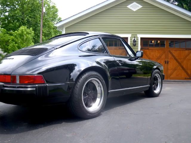

Add photos...
Mine: 25-1/2" at all four corners.
