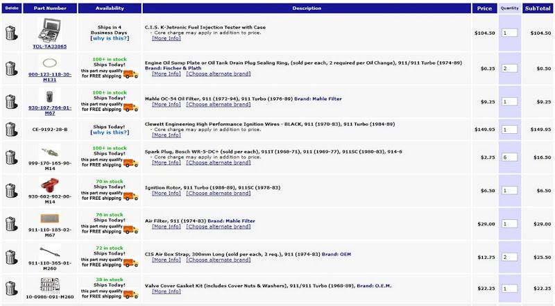

I have now ordered everything I need to do some proper work, save for the dizzy cap which was out of stock. From the view of owning a classic Porsche, living on the northern fringe of Europe really sucks, parts being faster and cheaper to get from the US than locally! ;)
http://lh3.ggpht.com/_NvY1POYdICY/TG...Order_crop.jpg
