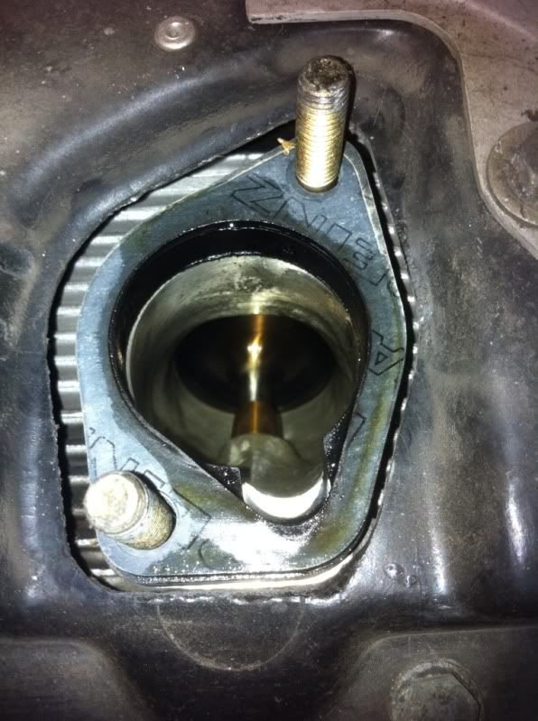

cgarr 01-30-2011 12:03 PM
Just pulled the engine because its winter and nothing to do and still wanted to check the lean condition and why I am still using oil with a rather fresh rebuild! This may be the lean condition, see the pic of the crack gasket on #2 Left side and note the excess oil in the #6 intake. Will report as soon as I get the cylinders off.
http://i30.photobucket.com/albums/c3...1/ec39856a.jpg
http://i30.photobucket.com/albums/c3...1/43d52971.jpg
