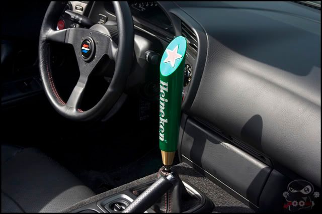

What about a Hurst T handle. ha.
Danny_Ocean 01-03-2011 07:29 PM
http://farm4.static.flickr.com/3239/...1e064202_b.jpg
http://image.importtuner.com/f/10019...shift_knob.jpg
http://i218.photobucket.com/albums/c...ics/tst_18.jpg
