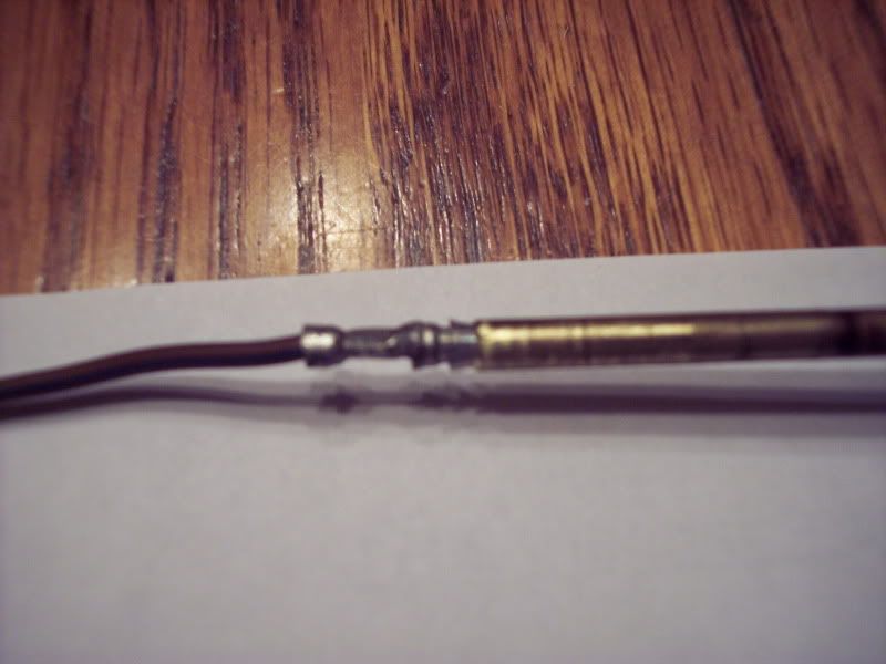

I found an old plug, not the best pic but here are the tabs you are trying to compress with the tube, you have too push it in good and snug.

guys, that helps a ton. and nice photo.
once the pin has been sleeved does the wire/pin slide out easily? i've heard of folks breaking them trying to get them out.
PCA member since 1993
Old 01-16-2011, 03:44 PM
abit off center
cgarr's Avatar
Join Date: Feb 2002
Posts: 7,311
mine pulled out very easy. You will kind of hear the took click in when it goes and don't pull on the wire until the tool is in place.

looking at the pin it appears the flare at the wire end would make it even easier to replace the pins, (assuming you remember where they belong), when you put the connector back together, is this right? do you even need the tool to reassemble them?
and you can see why a screwdriver would have a hard time doing the job.
Old 01-16-2011, 04:04 PM
abit off center
cgarr's Avatar
Join Date: Feb 2002
Posts: 7,311
They just push and snap back in, no tool needed.

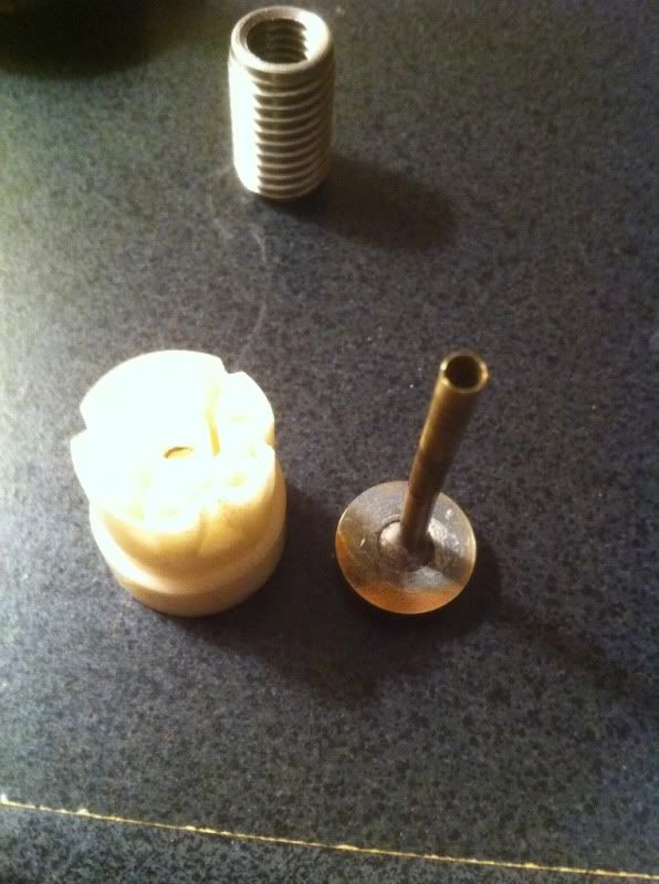

Old 01-16-2011, 04:05 PM
abit off center
cgarr's Avatar
Join Date: Feb 2002
Posts: 7,311
Here ya go!

Old 01-16-2011, 04:16 PM
Science is NOT optional
rbogh901's Avatar
Location: West and further west
Posts: 1,979
Well done, Craig, that pretty much puts this one to rest. If it wasn’t already dark and snowing I’d want to go right out to the garage and get on it myself. I’ll have to wait but thanks a ton. It’s really very helpful.
