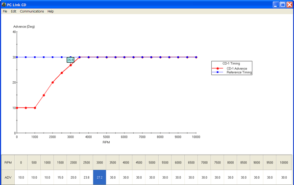

Old 02-08-2011, 05:02 AM
In maintenance phase
daniel911T's Avatar
Join Date: Apr 2010
Location: Jacksonville, FL
Posts: 806
Smile
Originally Posted by Grady Clay View Post
Here is Mark’s image with some annotation.
Firing order 1-6-2-4-3-5.
Best,
Grady
Grady,
You are absolutely amazing! Thanks for more great info.
You always give the comprehensive answer, clearly.
You've helped me out a lot with other problems, and this kind of thing is SO valuable to the community.
THANKS AGAIN!
Dan

Here is a sample of an advance curve that can be programmed in. This sample is not 911 specific.
