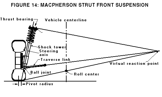

jluetjen 09-24-2011 01:14 PM
Looking specifically at the suspensions designs on a 911, first the front end which uses a struts suspension.
http://1.bp.blogspot.com/_FoXrzNJ_K0...600/fig-14.gif
All other things being equal, increasing the track width will actually increase the roll center height slightly, which will make the front end act as if it is stiffer in roll than the same suspension with the same settings, but a narrower track width.
Looking at the semi-trailing arm rear suspension, the same is true -- widening the track (all other things being equal) will slightly raise the rear roll center, making the car stiffer in roll.
http://www.bevenyoung.com.au/fig13-1.jpg
So let me correct myself -- widening the track tends to raise the roll center at that end, which will make the car stiffer in roll and thus load up that end of the car faster. This is compounded by the fact that since the track is wider, and the distance from the center of the car greater, that the tire with a wider track will get a greater load transferred to it since it's lever-arm from the roll center is greater.
Flieger 09-24-2011 05:36 PM
I always do roll centers at the intersection point which should be centerline static, but when the chassis rolls they change.
I was widening the track with a wheel spacer which I suppose raises the roll center a little bit but the jacking force goes down since the slope of the line decreases.
Anyway, if one isolates the effect of an increased track width, it is to add grip since there is less weight transfer on the tires. It doesn't necessarily do anything for body roll. That depends on the suspension specifics. The roll couple distribution is affected by roll centers, roll stiffness (springs), and the track width. A wide track can counteract for a stiff anti-sway bar and is good to have a wide track on the heavy end for stability.
