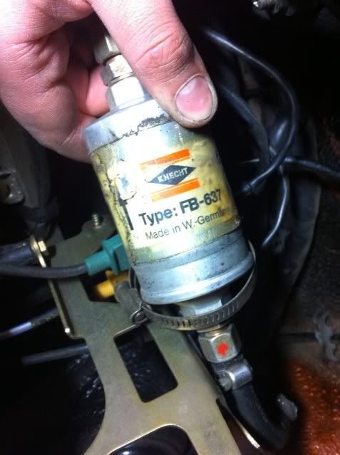

Finally wrapping up my 23mm MC install and went to test drive the car after it sitting for about 3 weeks and its down on power big time! Feels like a misfire but its hard to tell. The fuel filter looks pretty old so I am going to change it. Pelican list Mahle filters but Im not sure which one replaces this one:
Photobucket
going to pull the caps off the distributor tomorrow. Other than checking that, any suggestions?

Mine uses the Mahle KL 21. $20.

Did the fitting sizes change much over the years? I'm not sure what year the filter is for. I have a 94 motor and a 75 s car. Don't know which to order.

Based on what I can find online this should fit? Anyone have insight here.
Pelican Parts - Product Information: 911-110-176-02-M14

Can't help you there, mine is an 83 with a 91 motor. I guess you could call Pelican and ask....

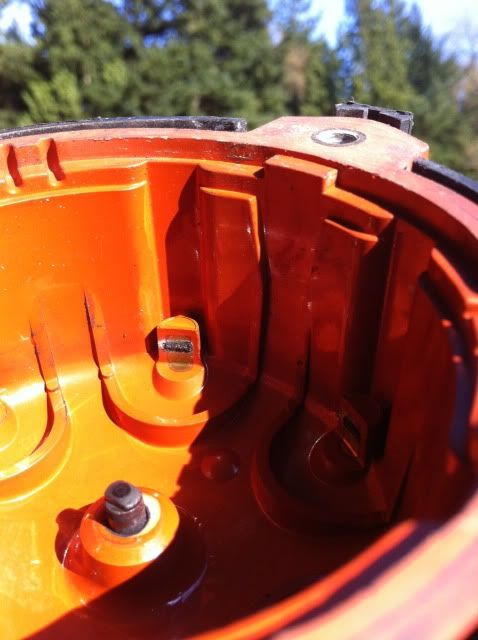

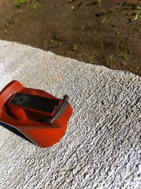

So I pulled the cap off my secondary distibutor and found that my rotor looks pretty beat up (maybe its just me)
Photobucket
Heres the cap contacts
Photobucket
Do they need to be replaced?
also my belt is fully functional, Im pretty sure that its the fuel filter. I started up the car and gave the filter a shake or two and the idle smoothed out and the motor could rev freely. I ll have to look through the PO's reciepts but I swear the work done in 2008 showed that the filter was replaced and that was only 600 miles ago. Im picking up a filter (dont know the brand yet) tomorrow at my FLAPS and will use it till my bosch filter comes in. should I order new caps and rotors too?
