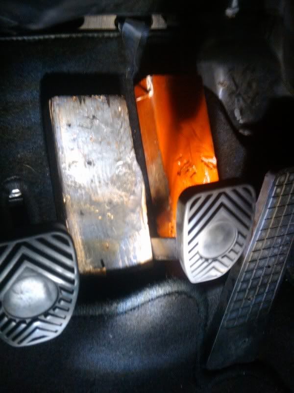

UPDATE
1st:
http://forums.pelicanparts.com/support/smileys/pray.gifhttp://forums.pelicanparts.com/support/smileys/pray.gif Dr RUSNAK http://forums.pelicanparts.com/suppo...s/smileJap.gifhttp://forums.pelicanparts.com/suppo...s/smileJap.gif
This is no FLAME on the Motive or DIY Motive Knock Off Pressure Bleeder. I have one too and works as designed for a one man job when wife is pissed at you :( but it could never replace the OLD SCKOOL 2 Man Team :D "OK, Pump!"
http://img.photobucket.com/albums/v5...720_183217.jpg
I did exactly what Rusnak stated but with a twist, I placed two pieces of 2X4 (one was actually 2X2, for you OCD types) and after 3 rounds I turned on the car to utilize the Brake Booster, then another round off.
1. Place the blocks so the pedal will not go to the floor.
2. Pump 10 times hard like your life depended on it, where good sneakers/boots helper! HOLD down.
3. Very quickly open and close the valve, Helper CHASE that PEDAL WITH EXTREME PRESSURE! NOTICE THE CLOUD OF BUBBLES COMING OUT? :eek:
3.5 Don't forget teh fluid, Watch Fluid Levels on each caliper.
4. After the 3rd release the fluid came out clear. (I was really insecure, so I did it 10 times., Nice Golden Clear Color)
The best thing is, this method uses very little fluid, I had about 1/4 of a litre left over. Never did that before ever. I've alwasy end up using 1.25 to 1.50 litres in the past. The Vacuum Hand Bleeder at the valve used 2.25 litres :eek: allot of waste.
RESULTS:
MUCH SUCSESS
Humbly,
Jim
Thank you Dr Russnak!
