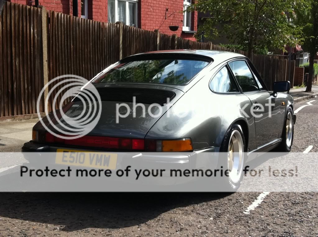

Mine on 205/55/16 Front, 225/50/16 on 7 and 9s- with a hefty lowering. The 225/50 fit fine on the 9s, have run them for 10k miles plus with no issues
Shirish

thanks for the pic! that's just what I was looking for. looks great.
