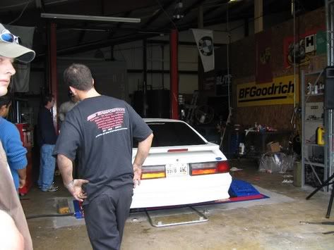

i have a dyno dynamics dyno and it will compensate for inlet air temp --probe inserted into coupler at throttle body-- , air desity, --inputed from weather station at time of runs-- , humitity --also from weather station-- , ambient air temp -- again weather station-- , drivetrain inertia --calculated from a loaded ramp up and then pull down from dyno-- , runs on saddled 8.5 in rollers that weigh 85 lbs not the typical 4k to 6k that dynojet and mustang dynos use so tourque numbers are realistic not skewed by the inertia of the rolling drum, as far as slippind goes we just had a dyno day and we had a 1575 hp chevy truck that put down 827 on motor and 2 stages of 500 hp nitrous with no wheel slip only on our traction bar stap setup which consists of 2 big straps and we used 2 small ones for saftey and thats it, no crazy cross straping and like 20 sets of straps and still have wheelslip, threr is allot of misinformation on dynos out there,
here a pick of our dyno the bar that runs arround the back of the car holds the strap system 2 staps run under the car over the axle or bannana arm and attach to that bar and thats it.
