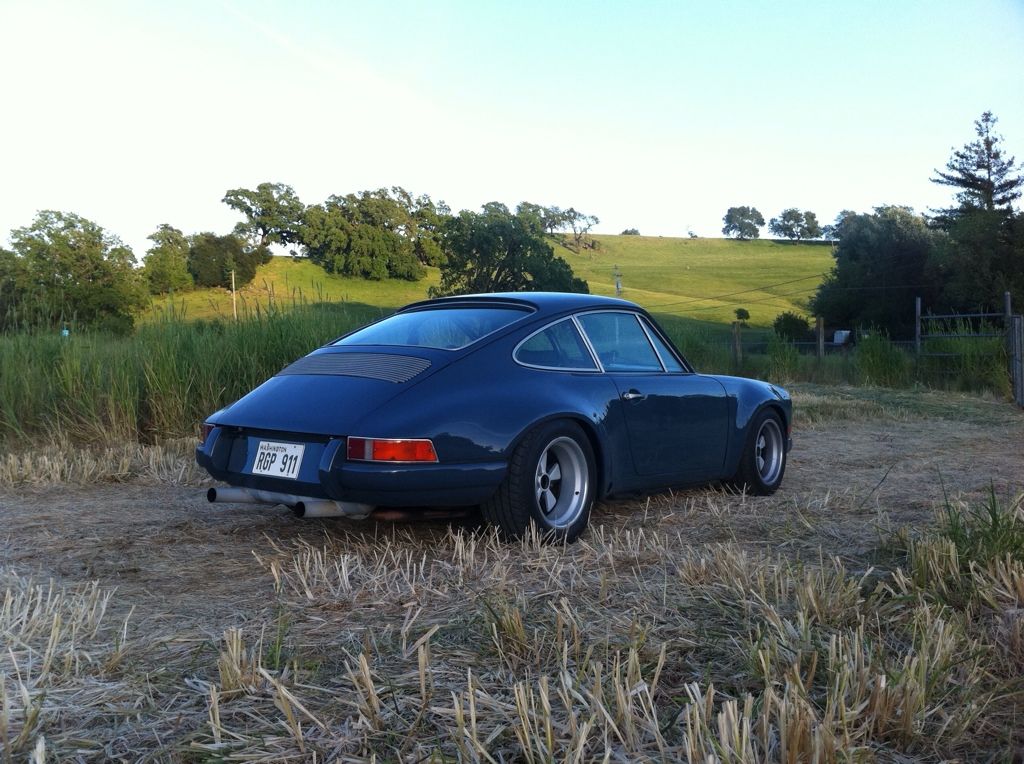

Before:
After:
All undergone cleaning and repair and couldn't resist getting the RPM rebuilt and converted to 10,000 rpm.
I'm out in the garage and just looking at it, wife thinks I'm crazy, but your guys will understand
Thx. Olsen911

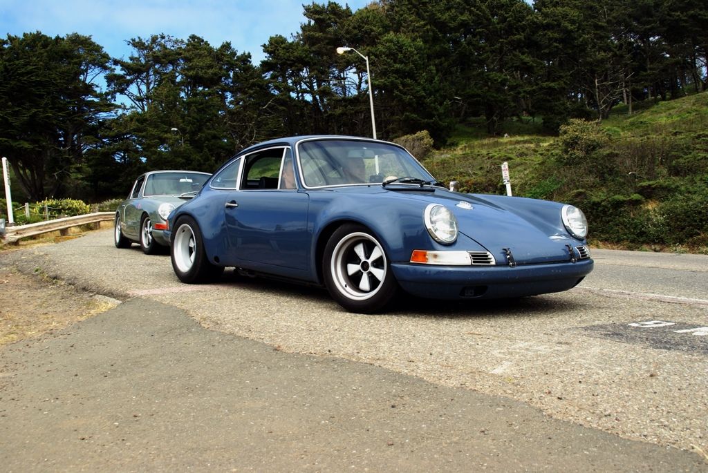

Here is mine... '70 911T chassis. All steel original factory bodywork. Built about 10 years ago. 3.6L with PMO's...fantastic fun!
