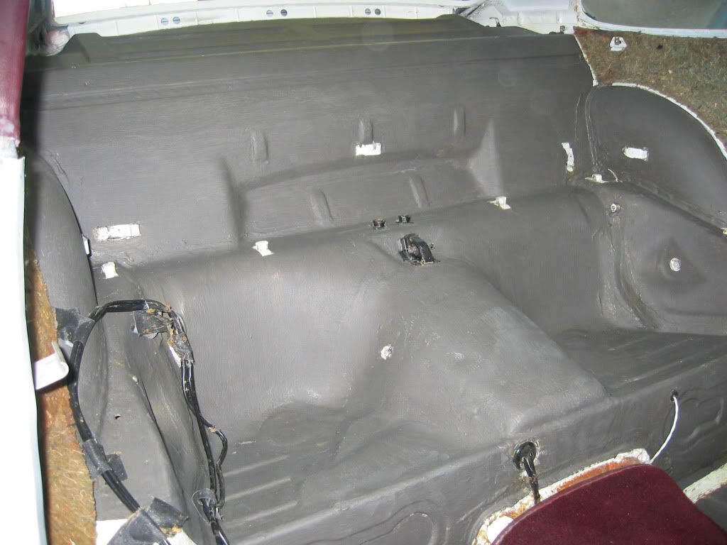

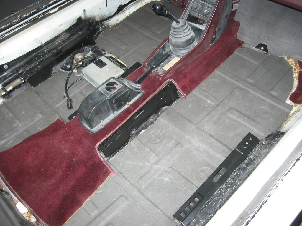

I removed what was left of my engine pad and scraped away all of the old glue (used orange oil glue remover). Then I coated the area with Quiet Car sound deadener...it works great and looks factory in a dark grey. Water soluble, no fumes and it weighs almost nothing.
Noise & Vibration Damping Coating for Cars, Trucks, SUV's and RV's
I also used it on the inside to reduce noise under the carpet.
http://i369.photobucket.com/albums/o.../IMG_17881.jpg
http://i369.photobucket.com/albums/o.../IMG_17891.jpg
The carpet and inside noise damping works great and the engine area helps as well.
