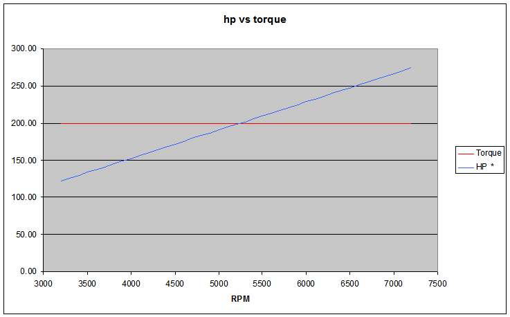

Maybe somebody can explain this?
I was at a dyno one day and a Honda had a flat torque curve. Pretty much straight all the way across. But the HP curve was as one would expect. Is this even possible with a mathematical model?
Also: I have always wondered: wouldn't changing tire diameter effect the dyno results? Why or why/not?
depends on whatt you mean by expect
hp is a quantity which is calculated from a measured quantity, torque
the calculation is
HP = (rpm x torque)/5250
here is a result based on a totally imaginary engine w/ 200 lb-ft of toque at every rpm from 3200 to 7200, the hp curve will constantly rise, now this never happens so any variation in torque will cause a consequent variation in hp
http://forums.pelicanparts.com/uploa...1331159809.gif

Bill Verburg 03-07-2012 02:43 PM
Originally Posted by j911brick (Post 6607264)
Thanks Bill. I probably could have figured it out if I sat down and did the math, but thanks again. Big help.
That graph was posted by mistake, it shows the hp curve of a modified engine from one data set but the torque curve from a theoretical engine, I corrected the mistake
