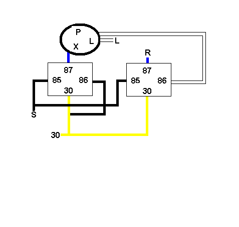

OK, I've got workaround figured out with modern parts.
One of the goals was to design something that could be easily repaired/replaced in the field. I was originally considering, for example, a Bosch DPST headlamp relay, like that found on an old BMW motorcycle. However, those are somewhat rare, and about 10x the price of a $1.79 40A Bosch SPDT relay.
So here's the plan.
The original SWB switch works by grounding the can- power flows from 30 through the thermal flasher to ground. In the ground position, a relay wiper is also pulled into contact, which is a double pole (you must have isolation between both poles of the wiper, otherwise both turn signals will flash when you only apply one). The thermal element heats up and breaks the contact. Mechanically, the thermal wiper moves back into the closed position and it starts all over again.
Now, the modern fix uses a pair of Bosch SPDT relays (terminal 87a omitted for clarity) and a Tridon EL13 Electro-mechanical flasher unit. When the switch is pulled, terminal S is grounded, which allows current to flow through the flasher unit to terminal 86, which energizes both relay coils, allowing current to flow from terminal 30 into the turn signals. When the flasher unit breaks the contact, the coils are de-energized and the current flow stops.
The reason for using two relays is that you must have both left and right signal circuits isolated when off. Rather than use a DPST or a bigger DPDT (like a Hella or the rebadged MSD) I chose the cheap, redundant route-- Bosch icecube relays are plentiful and can be had at most parts stores.
Also, everything should be small enough to fit in a metal box or can similar to the size of the original unit. I suppose if I really wanted to go crazy, I could fit everything inside the original can, but that would require different components.
Any thoughts?

Well, the above didn't work.
Here's what did.
The circuit logic of the earlier workaround was flawed: the current flowing through the relay coils was not enough to get the flasher unit to work, even though it is a variable-load type.
This second iteration was an attempt to put two 32cp lights and the associated wiring in the "L" or load circuit of the flasher- that would certainly get it to operate. I had originally considered using two flashers in the 87 terminal outputs from the relays, and tried it, but ended up with different flashing rates-- it looked like a circus car. So then it hit me, I could drive the second relay's coil input with a multiple from the flasher's output, and run them simultaneousy, while retaining electrical isolation between the individual turn signal circuits.
Remember, the reason to do this rather than just hooking both turn signal circuits to the "L" output of a flasher is that if you did that, you would get both turn signals operating when you just wanted one. The factory can had a DPST relay inside, along with a thermal flasher-- small and effective. In later years, they went to a grounded, electromechanical type that ran both turn signals and hazard, and the changeover was in the hazard switch.
I also took the opportunity to FIX a major error that some PO had done, and all subsequent PO's missed-- the front turn signals were wired to the bulbs for the parking lights. So rather than a big 32cp lamp at the corner of the car flashing, a wimpy 2cp bulb in the small square next to the horn grill signaled your intention to turn. Not very smart in today's modern traffic.
Anyway, it's done. . . not easy to reverse-engineer the Germans of 40 years ago. Attached are pictures. With apologies to those who would have demanded the DIN spec for the wire colors, these were the sockets I had!

Old 06-19-2005, 04:23 PM
Join Date: Dec 2005
Location: Bedford, TX
Posts: 430
BMW 2002 turn signal relay- might work?
John,
Do you think the attached picture of a BMW 2002 relay might work without the added relays?
My '68 911 has a bad turn signal relay and I'm just looking at options.
Thanks,

Mike, that 2002 relay would probably work in the 69- LWB cars, but I doubt it would function correctly in an SWB. Plus it's about $45.
As you can see on the side of the can, the terminals are 31 (ground) 49a and 49 (input and output) and C (pilot lamp). This suggests that two wires is used to turn the unit on, one to light the pilot lamp, and the remaining single terminal to power the signals. There are tons of domestic flasher units that do the same thing, but the problem with that is, once you make an electrical connection between the two sides of the car (left bulbs and right bulbs) so you can flash them with a single contact, you end up lighting all four bulbs when you only want to light two (when you throw the turn signal stalk).

John,
I just made up this relay conversion for my car this morning as the original flasher unit would only work on the left side circuit.
I just finished up and put everything back together and noticed in your legend that I hooked up the left circuit wire wrong, but the hazards now work. Instead of wiring the left wire to the "P" on the flasher unit along with the "86" wires from the relay, I connected it to the "L" terminal on the flasher unit as that's what I thought the drawing was indicating. I came back in and looked at the actual photos of your installation and saw that the "L" wire is supposed to be hooked up to the "P" terminal.
Is this going to cause a problem even though all four of the lights are flashing? I did notice that when I turn the flasher switch off that the turn indicator lights in the speedometer flash one time. Does your car do this?
Since it's no big deal to go back and connect the left side wiring up to the "P" circuit, I will if you think it's a good idea.
Let me know what you think.

Mike,
Great! I am very pleased that the diagram was helpful to you.
I don't think connecting it to either "power" or "load" matters if the circuit works, the other one is a no-connect. You could even use a two prong flasher, all you need is something that mimics the action of the original relay wire heating up and breaking the circuit, then reconnecting when it cools down again.
I think I get the single flash when turning it on or off also, I think it's feedback into the "c" circuit from the signal flasher, but I'll check next time I am with the car. I have some work to do in that area as when I turn on the left or right signal I get BOTH indicator arrows.

John,
Actually what I did was hook up the black/white left turn signal feed wire from the wiring harness to the "L" terminal on the flasher unit as I read your diagram wrong. However, the hazards and turn signals work correctly so you might want to hook up your wiring like this and see if your turn signal indicators flash correctly.
I just used two 30 amp relays and an EL13 flasher that I had in the garage along with some electrical tape to hold everything together to see if it would work, so I don't have any pictures to post.
I've got the same relay holders that you used at work that I'll wire up and install and will post pictures after I've got the permanent set-up.
Thanks again for this post. I defintely could never have figured this out on my own!
