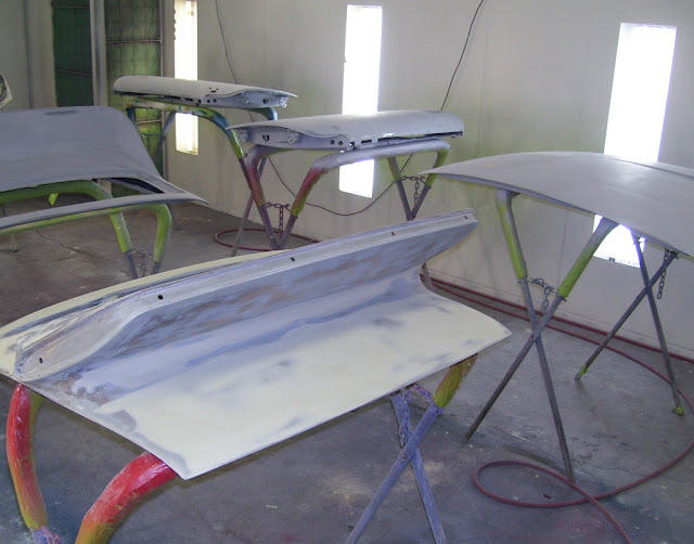

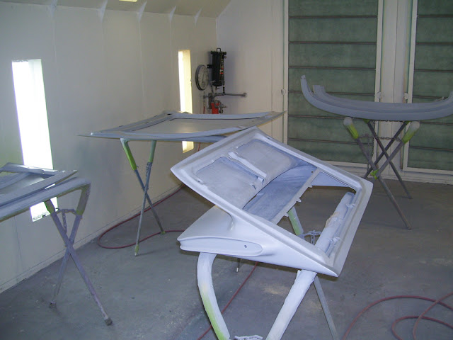

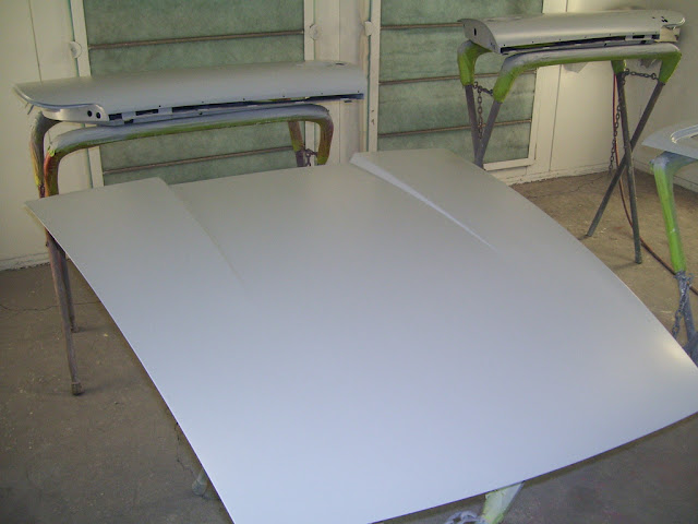

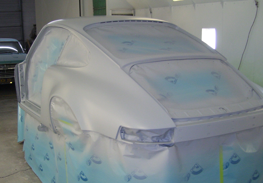

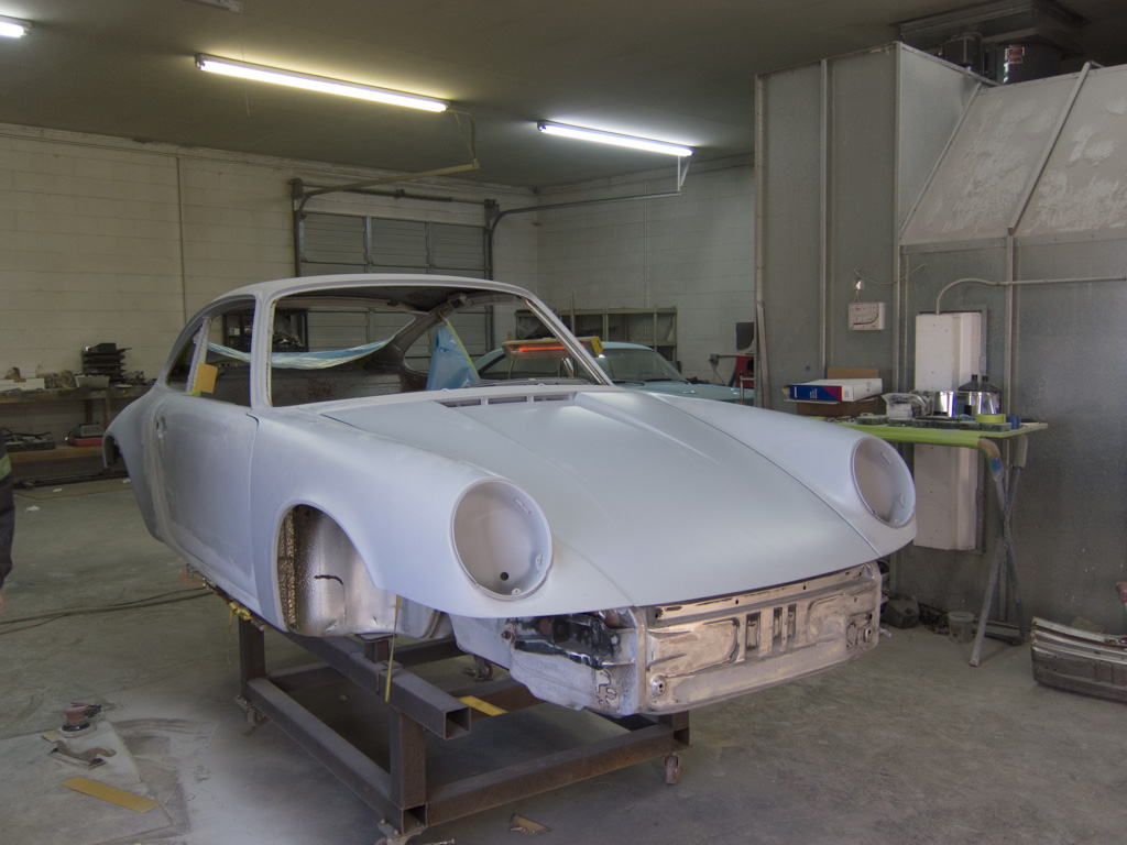

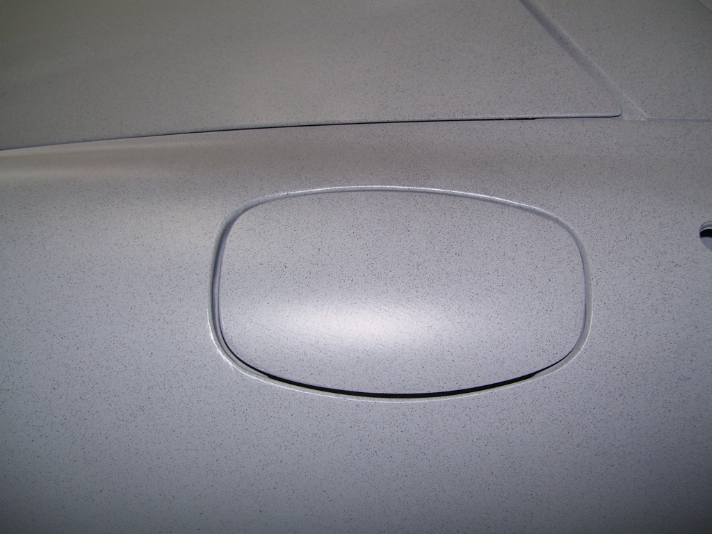

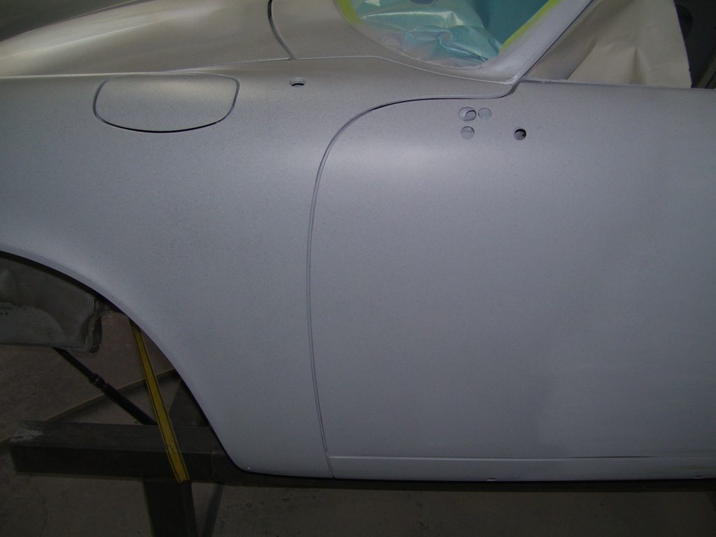

Carrera Primer
With the metal work completed in December the restoration of 1976 Carrera MFI 2.7 #9050 has entered a new phase. I've felt fortunate to be working with a really passionate and talented team that cares about the level of detail required to restore a car to how it left the factory and, wherever possible, taking steps to preserve what originality remains after decades of use. For those that haven't been following from the start the Carrera needed a complete repaint due to being covered in primer, other paint, and dust from sitting in body shops for over a decade.
The body and all panels have now been painted with the initial layer primer. Next all the body panels, lights, trim pieces, etc. will be fitted to the chassis. While Porsche never had perfect gaps, I'd like to have them be a bit closer to the uniform gaps that a factory craftsman would aspire to on their best day. With everything fitted everything can be adjusted to get the gaps as close as possible before filler is added to sand back down to get an even gap. Since changes to one gap impact the gaps on the other edges of the panel this requires an iterative process of adjustments until the gaps all are roughly equal. The final step is block sanding, a critical but very labor intensive step of ensuring a great finish.
At the same time we are spraying out a few final test samples of the silver metallic paint (936 / Z2). Properly duplicating Porsche's period flake is always a challenge given how fine the original metallic flake was. Leading up to this point we've studied and photographed several original Carreras to determine how they were originally painted, where there was over spray, where primer showed through, how thick the paint is, and the exact textures to reproduce where we couldn't save the original texture. It is easy to over restore a car and paint it perfectly, or at least better than how it left the factory. However it is much harder to get the details to more closely match how a 911 left the Porsche factory given how poorly they painted many parts of their cars in the 1970s.
In addition to all the original body panels we are also painting a few spare body parts including an extra driver's side mirror, a plain engine lid, and a duck tail. While not original to the car, the extra engine lid and ducktail allow swapping out the whaletail in the future as the mood strikes. Each was carefully fitted to the body before hand and adjusted to get even gaps. Since silver is a very hard color to match later we wanted to do this when the rest of the Carrera was being painted.
I'm really looking forward to seeing the Carrera finally painted and the body panels reassembled on the car. Stay tuned in the coming weeks as the overall restoration picks up pace.

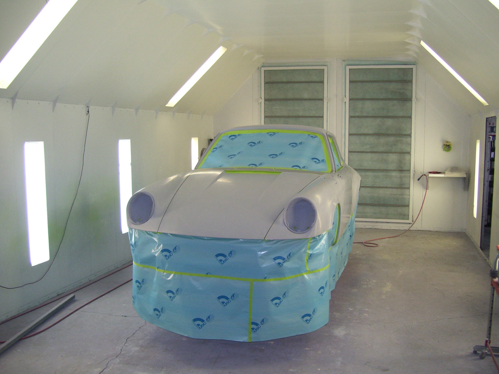

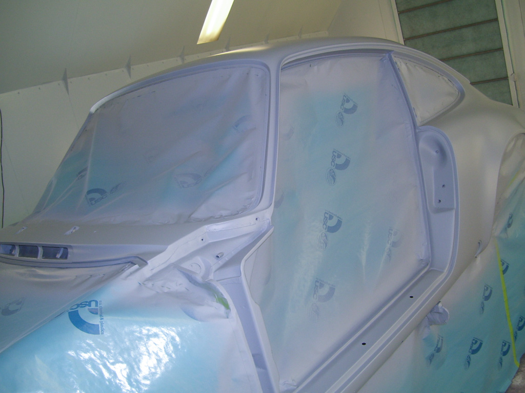

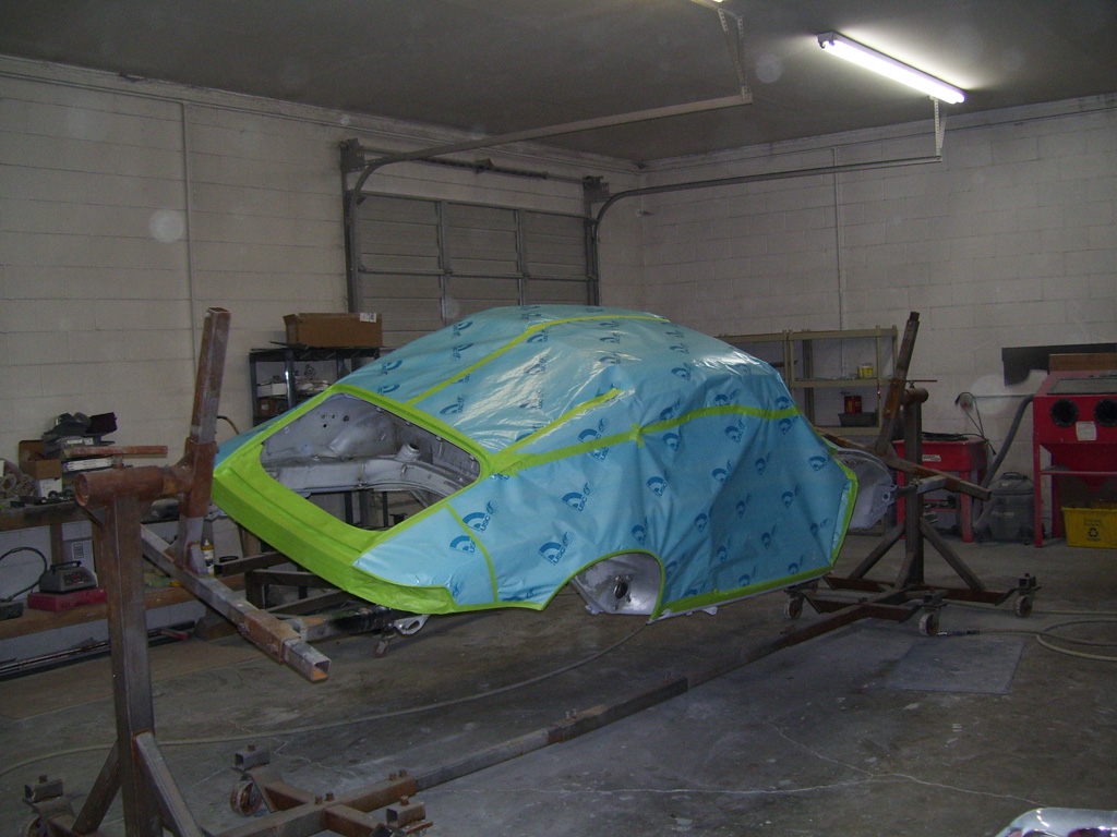

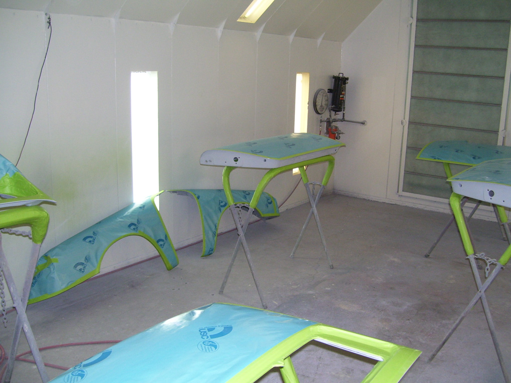

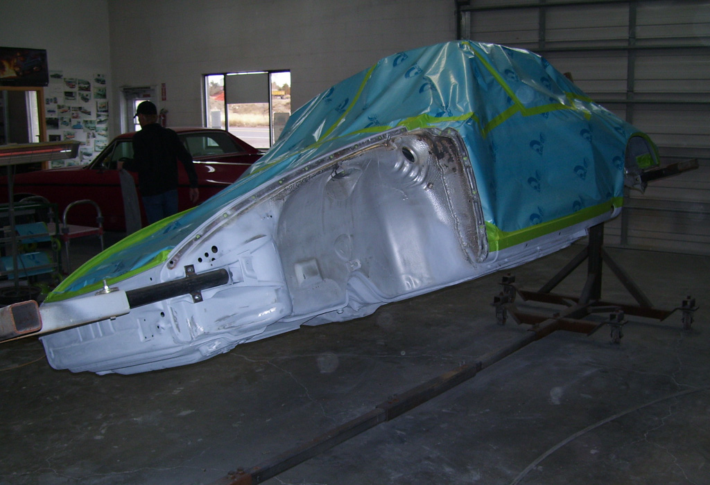

Prepped for Paint
For 1976 Carrera 2.7 MFI #9050 it has been a long road since we started this restoration. From completing the metalwork and rust repairs, primer and prep work, adjusting gaps, test fitting all body panels and trim before painting, to multiple spray out attempts before we got just the right period Porsche silver flake. A significant amount of effort has been necessary to get all the details right, and it has been a great experience as everyone involved banded together to achieve the goals.
Finally the day has arrived where everything is ready for paint. All the removable body panels have been taken off and are masked to paint the inside first. Similarly the chassis the exterior body has been masked off so the underneath and engine compartment can be sprayed. The chassis is on the rotisserie just waiting for the paint booth to free up. Once the first coat of Glasurit 55 is laid down the restoration project will be on a trajectory towards completion. Exciting times!
