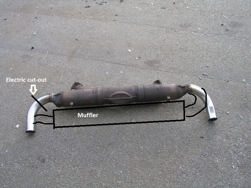

I was wondering if this kind of solution would work with a one long muffler.http://i216.photobucket.com/albums/c...austmodded.jpg
If you want to keep the noise down, keep the valve closed. It does cut down on power quite a bit... But gives nice backpressure though. I think ideal would be to use a vacuum operated valve, which would open when under load.

Simply adding a second cut out to the left end of the cat would make it a LOT quieter :)
One thing I did not try was simply adding full-car-width long tailpipes to the cat outlets. Plenty of room for both of them to pass each other over/behind the cat, and wrapped or heat-shielded too too. There is no question from much reading that lengthening tailpipes (of right size - told magic diameter for 993 engines is 2.25in each side) will make an engine quieter, even without mufflers.
BTW your present setup and sketch concept wouldn't work at all with the later Gillet 993 cats as the flows from the two banks are kept separate by a blocking plate in the center of the cat - so closing the cut out would completely block the left header. But with earlier Bischoff cats, where the l/r bank flows collide/mix together in cat center and can head for the atmosphere either way, it would tend to leave the left side stagnant and the right side working double duty. It also cuts total cross-sectional area in half, so it would be a performance hit.
But for a mainly drive-to-the-track-car, it might be worth a shot, but wouldn't you need to put either a much larger diameter pipe on the left, where the cat and muffler combine - or a separate tailpipe on the left end of the muffler - or you'd be choking the engine even with the cut-out open. And open, the disparate lengths and different flow dynamics of each side may introduce undesired effects - different rpm/torque/power curves on each bank.
On a mainly street car doesn't look like it would be a good idea for such a cut-out-equipped (or permanently welded-in-muffler) setup, re the performance hit.

Left-right mistake... Yes i have a e-cutout on the left side allready as in the pic. But is not quiet enough. And it does not block the the left bank totally.... The cat was from a -97 tip engine. I have also noticed that the cutout affect the power.
This is offcourse worth trying.

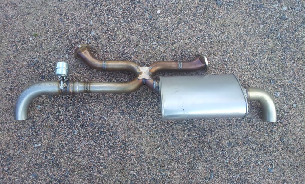

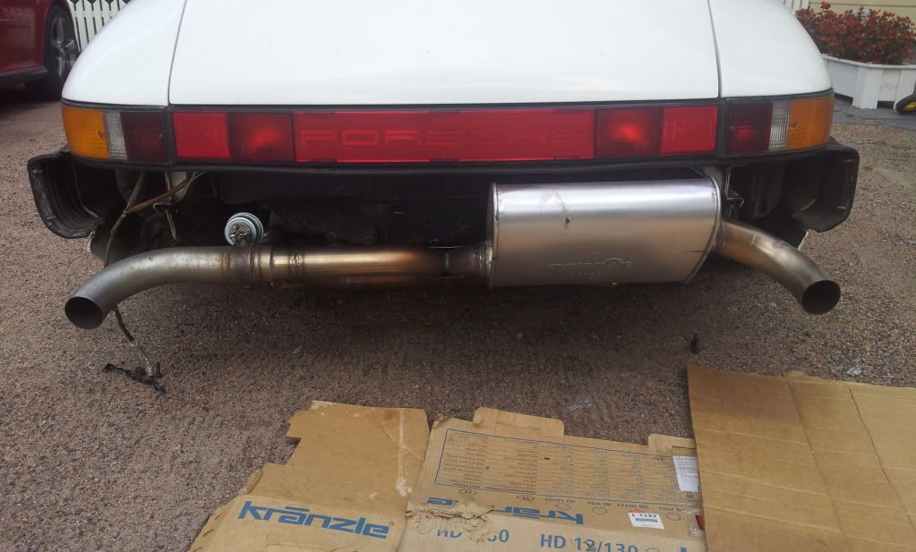

Hi again, here is my latest exhaust version. This solution does not have a cat though.
The goal was to achieve a silent exhaust when cruising. When you floor it, vacuum drops and the exhaust flows nicely and the sound is... enough. A bit too much maybe.
DIY-PSE i call it.
When the valve is closed i pass the local track noise limits as well. Which is a huge plus. One muffler is capable to handle about 280 hp. If you would put another one to replace the valve you would have a quite and well-flowing exhaust.
Some pics:
http://i216.photobucket.com/albums/c...ps9a2f10ac.jpg
The muffler is Dynomax. The fitment inside the bumper is really thight.
http://i216.photobucket.com/albums/c...pse3c77eb0.jpg
Sound check in the Finnish countryside:
Porsche 911 3.6 exhaust test - YouTube

Jaskas 10-02-2013 11:39 AM
I bought i from us ebay. Not so sure about the valves quality. Some parts fell out after first test...
