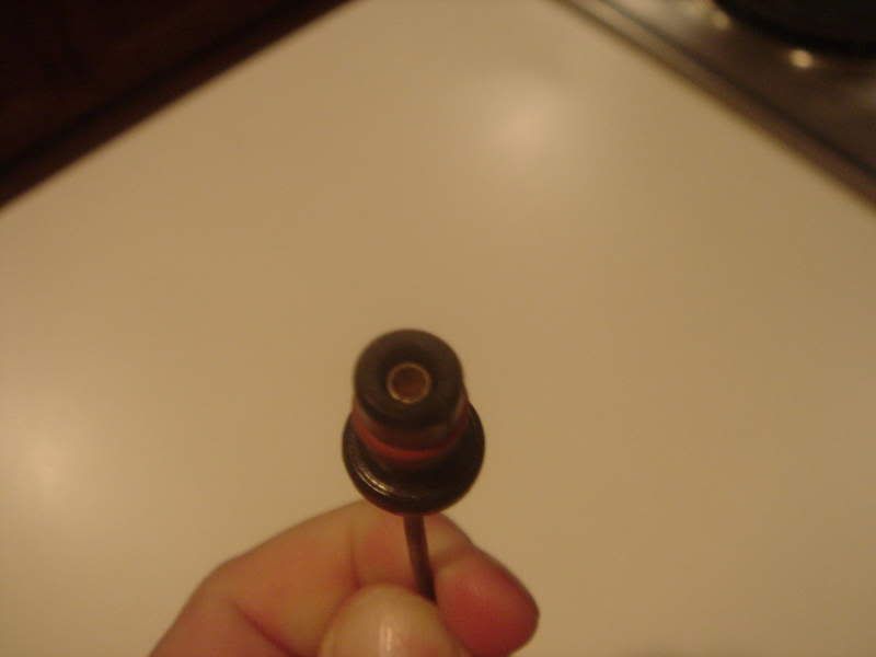

I'm about to install a new 993 windshield into my 87.
I want to use the built in windshield antenna lead ( looks like a very thin computer ribbon) out the bottom
How does it connect to the antenna booster?

First things first, the 993 windshield is designed to be glued in, and not held in place by a weatherstrip and is a different size from the < 95 models. It can be done, but not exactly plug and play. And the 993 antenna connects with a single click lock connector. Hard to tell by the photo, but it looks like it in the center of your picture.

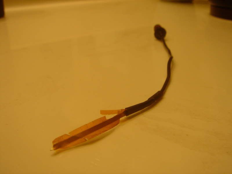

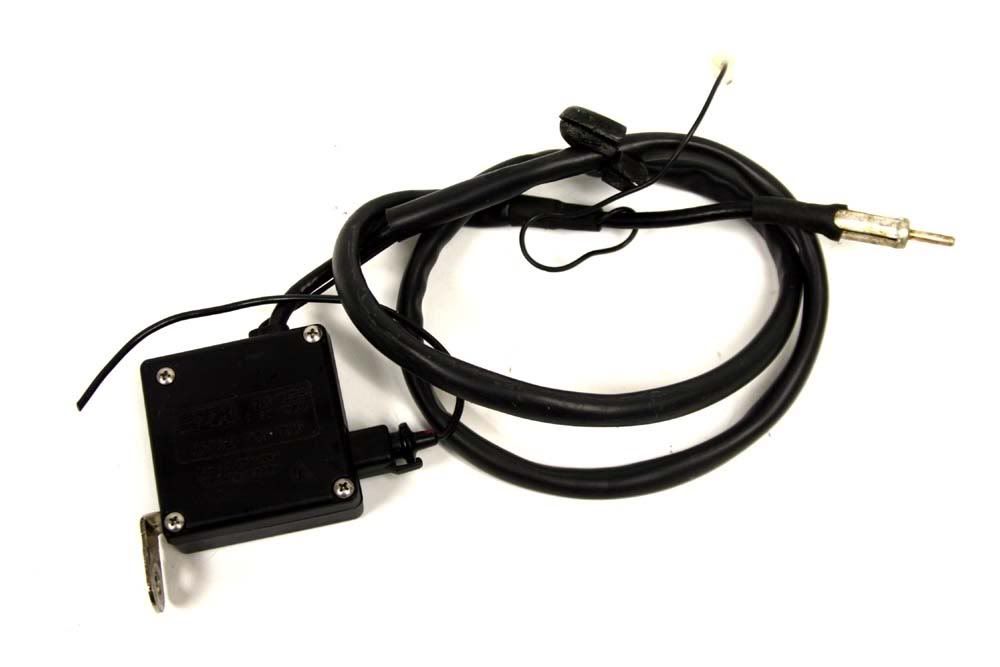

993 Windshield Built in Antenna
Thank-you, rattlsnak:
Yeah, I borrowed the image from the 993 glass install thread.
What is a single click lock connector?
I see the circular antenna embedded in the the top center of the windshield.
At the bottom of the glass there is a small computer like ribbon (obviously the antenna), but that's my question
what and how does that attach. Is it this wire on the booster. See that circular sticker looking thing at the end of the wire?

if you look at your first picture, there is a single wire in the center of the picture with a plastic connector on the end. That should connect to the winshield and the plastic end connects to the booster on your last picture. On your last picture, it looks like the connector is plugged in but somebody cut the end off the wire side that goes to the windshield.

Yep, on your last pic, in the upper right corner, there are two wires that seem to be attached together. One of them is the power for the amp and the other plugs into the radio. The wire that goes to the antenna clip on the windshield indeed looks like it has been snipped off.

Porsche Crest 993 Windshield Built in Antenna
EUREKA !! This is the image, I was looking for.
That ribbon connects to the windshield and subsequently to the booster.
I'm assuming I could just soder that ribbon on the glass directly to the cut wire.
