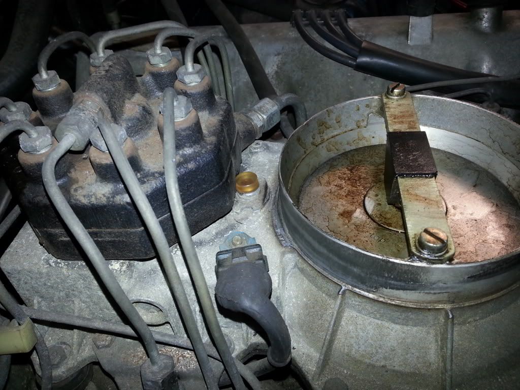

So after a full gasket rebuild I still had this annoying miss.
http://i237.photobucket.com/albums/f...ps0a96e268.jpg
Got my hands on a smoke machine today and I found the hole/leak!
http://i237.photobucket.com/albums/f...ps0b040318.jpg
http://i237.photobucket.com/albums/f...ps0b795aef.jpg
My friend has a 450SEL 116 Mercedes with the smiler CIS set up.
Note the gum coloured plug.
http://i237.photobucket.com/albums/f...ps3202cc71.jpg
Is there a plug that goes in this hole, I tried looking in the parts section but no luck.
I put some silicone in the hole to see if it stopped the miss, but motorway was blocked and couldn't sit on 120.
But it does feel like it has gone.
timmy2 05-10-2013 08:03 PM
That hole is not on the vacuum side of the intake system. (Before metered air)
It is the access hole for the richness adjustment.

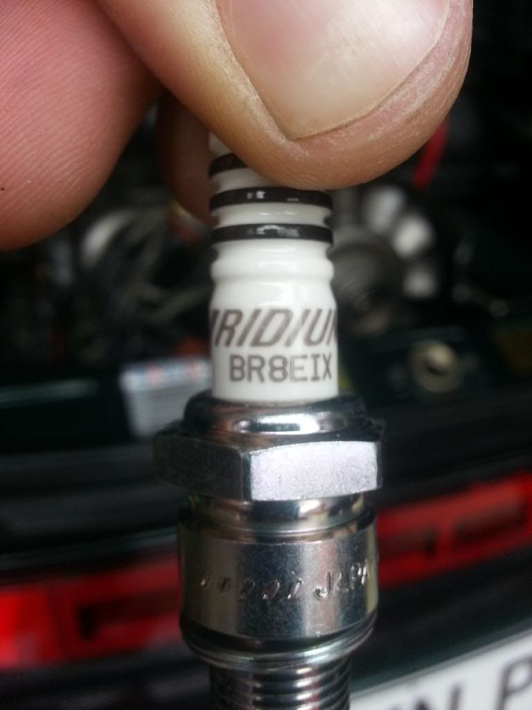

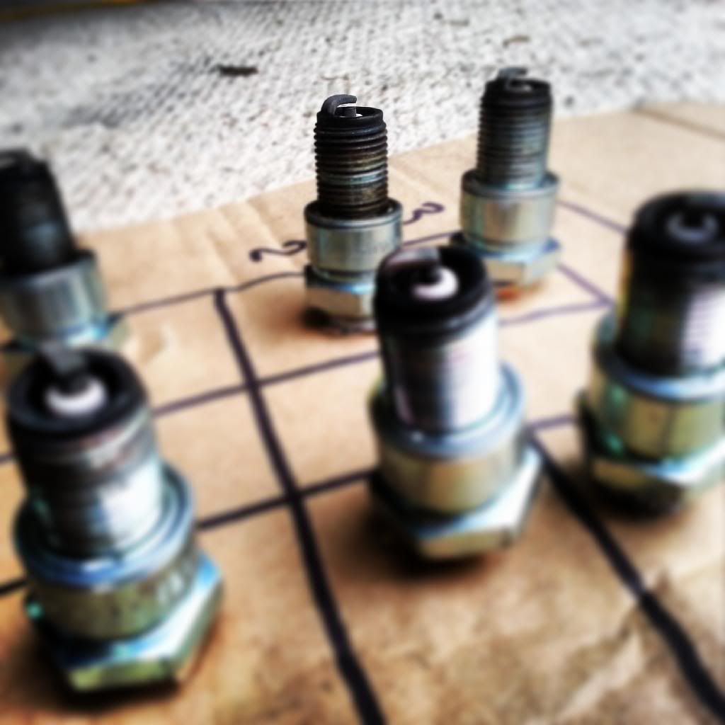

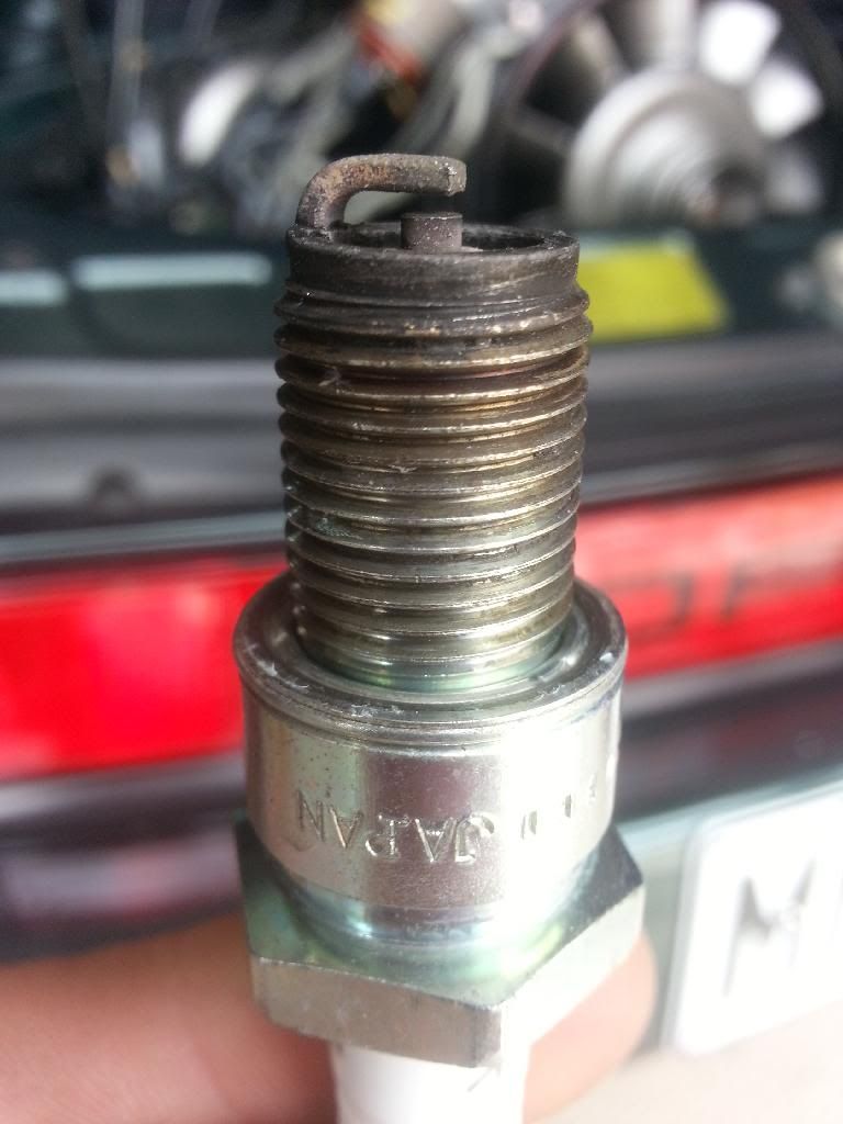

esonefour 12-20-2013 06:27 PM

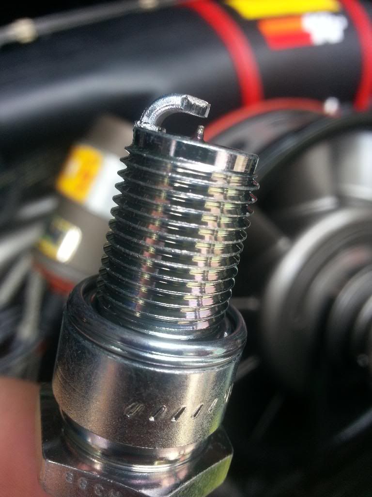

So a small update,
Pulled the plugs out and they looked ok, but got some iridium to replace them.
http://i237.photobucket.com/albums/f...ps4tjacogk.jpg
http://i237.photobucket.com/albums/f...psgkofh2yo.jpg
New plugs look space age apart.
http://i237.photobucket.com/albums/f...ps1mcgenvk.jpg
http://i237.photobucket.com/albums/f...psj5z5jwsw.jpg
This didn't fix the problem but I guess im getting through the list.

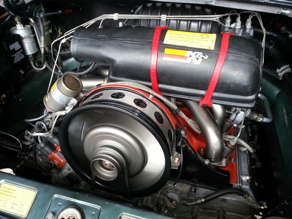

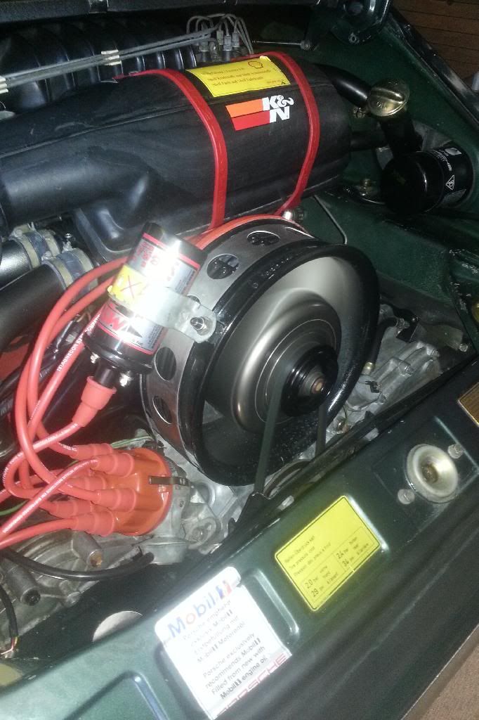

esonefour 03-24-2014 01:26 AM
Back on track to finding the air leak/electronic miss.
Bought a MSD blaster coil, rotor and cap.
Had it installed buy a autosparky friend of mine.
http://i237.photobucket.com/albums/f...psqg37chjo.jpg
It sounded so much more crisp and clean but still high idle and not running right.
So some new leads were the next on the list, as I found some that just fell out of the lead.
still running ruff and my patience was wearing thin, so I found a bumper to finish my clone.
http://i237.photobucket.com/albums/f...psbkoejvv0.jpg
My dad was down for the day to collect his drag car, We went over the electronic system started with
finding TDC with a paint brush in number one and for some reason the cap location was out.
Pulled dizzy out and made TDC right with number one and the mark on dizzy.
It started and for once I could see the timing marks with the timing light but still way out 10-11 o'clock.
Begining to get very frustrating and started to google EFI conversions.

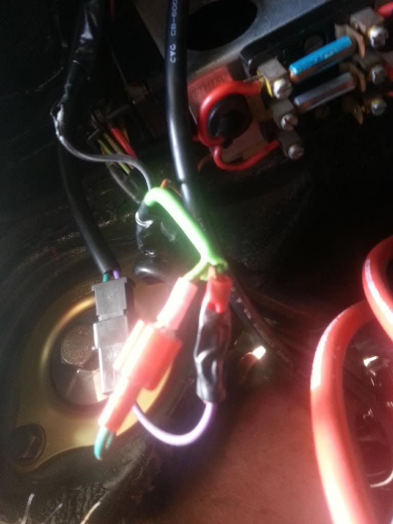

Started to look into the MSD and Coil green wire, found a page on Pelican were someone was having issues "Green to Green and Purple to outer wire.
Dun Dun Duunnnn !
http://i237.photobucket.com/albums/f...pslsxcqiac.jpg
Temporarily wired it up, and it started no high idle TDC and 5deg were bang on never been happier and 2 days on still smiling, so happy I have this monkey off my back.
http://i237.photobucket.com/albums/f...psjuhxqebr.jpg

esonefour 03-24-2014 01:51 AM
Green wire from dizzy goes to green wire on msd and the outer sheath? to purple.
There is no real clear instructions on this, unless I missed it in everything I read.
Was the permdoom unit wired in wrong, or was it just so faulty that a wired incorrectly msd preformed the same.
It's been a long road but fixing everything contributed to the making the issue disappear.
T77911S 03-24-2014 02:33 AM
MSD calls the Violet + and the green -. on the porsche, the inner green wire is considered + and the outer braid is -. so you would think violet would go to the center or green conductor but it is wrong. here is why.
MSD wants a neg to pos signal. the bosch unit uses a pos to neg signal. normally the output of the dist has a slow rise to pos then a very sharp drop to neg. this transition is what triggers the MSD or bosch unit. the difference is bosch wants a pos to neg transistion and MSD wants a neg to pos transition. dont think of the signal like battery voltage were you have pos and ground, its more like AC in your house.
the problem with leaving it connected wrong is that due to the shape of the wave form, the slow rise to pos will trigger the MSD BUT, it will also advance the timing at idle AND as RPM's go up. i image there are a lot of people out there that just pulled the dist, like i amost dod, and just re-time the ignition. this is very bad due the the advance that is added in.
as RPM's go up, the voltage out of the dist goes up. as it does, that slooow rise of the "up side down" side happens sooner and sooner thus advancing the timing.
this is hard to explain typing, hope it helped.
