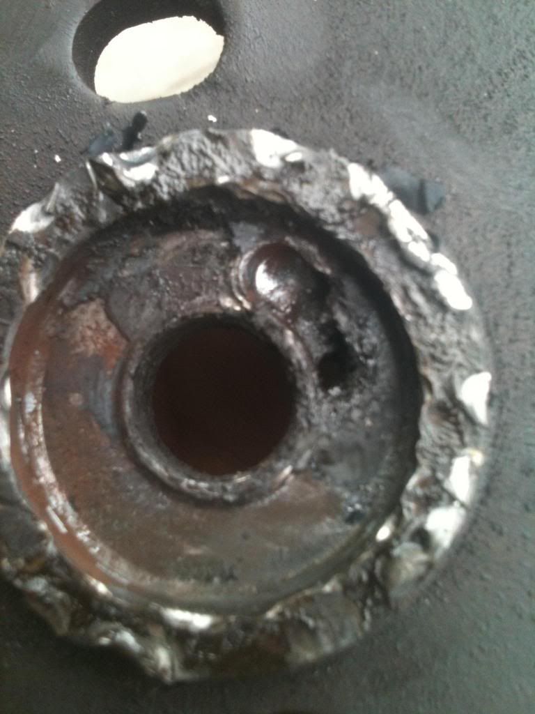

So the pulley came off, sheared the bolt. Luckily the seal is unscathed, but I'll replace it anyways. I guess the bolt probably was loose but I had not yet had an opportunity to drop the engine to get to it. Ordering the new bolt, pulley is en route, will fix her up this weekend.

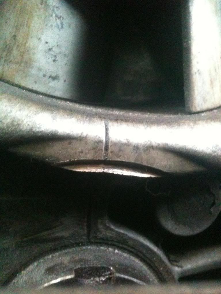

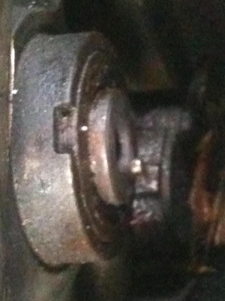

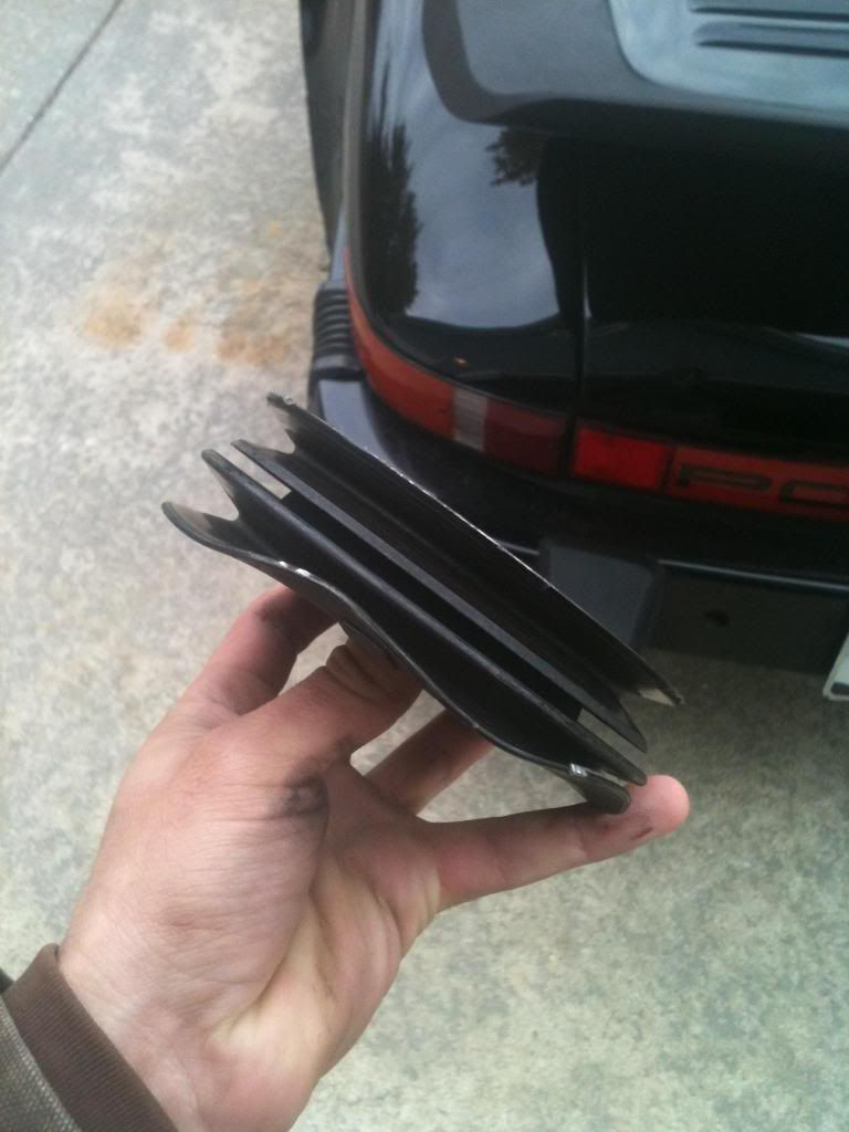

Jim, in the picture of the crank in post #2 on this page, is that how clear of a view you had of the crank after removing the muffler and crossmember, etc? Because I'm going to need to drill a hole in what's left of the bolt in the crank to get an extractor on it. So I'm hoping that's how clear of a shot I'll have at it.
Here's a couple pics of how it's looking:
The groove that the pulley wore into the fan housing
The pulley:
Bad view but the crank shaft is smooth on the end, only concern is that the dowel pin might have slightly wallowed out the hole a very minute amount, can't tell yet.

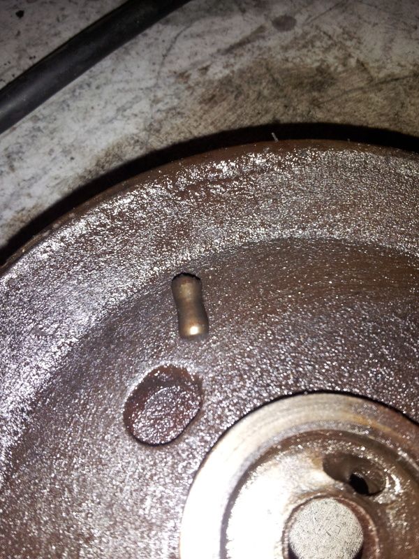

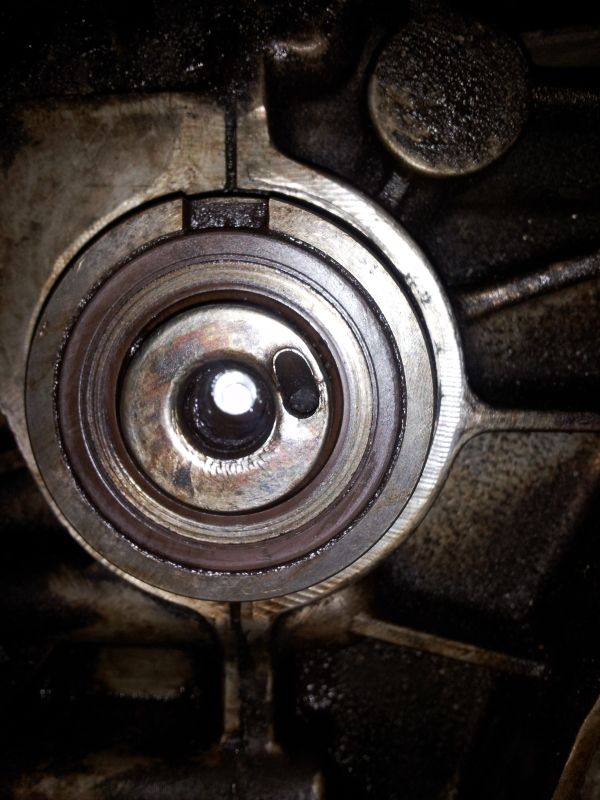

Location: Austin, TX
Posts: 8,829
I had the crank bolt come loose too because the sorry ass Bentley manual I had, had the bolt torque to about half of what it really needs. I should have known better but I plainly didn't catch it when rebuilding the engine.
Torqued to spec and all is well. No damage to nose of crank or seal occurred.
Trust me, this thing was minutes to hours away of flying off the crank if I didn't see it in time.
