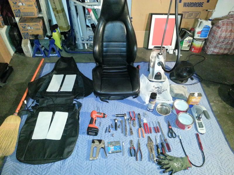

Well Fellas, another contribution to our great community 2013:
Kit:
Full Assembled Leather Quality Grade Perforated Inserts with Vinyl Piping from a local company ( PM me if you want the vendor's info )
Our Host offers kits from World Upholstery, should be the same but I can not verify.
Tools (see above, after removing it from the car)
Most important are:
Rubberized gloves
Harden Tipped Wire Cutter ( not to cut but to pry & twist those darn hog rings )
Hog Ring Plyers
Clothes Steamer
Outward Cling Stapler for the upper insert pad
Plastic shopping bag ( it really does work )
Supplies:
Adhesive Spray
Polished Steel Hog Rings to resist Rust
Stainless Steel Staples
Mineral spirits for clean up

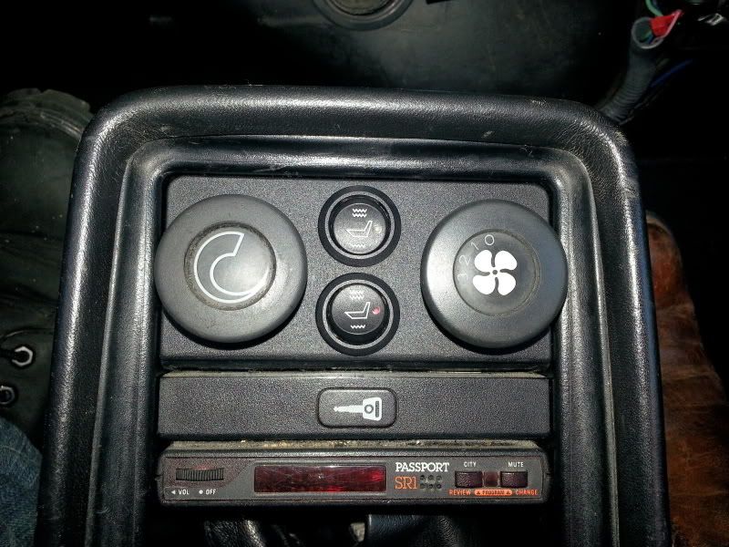

Option: Seat Heater Pads, I used '84 center console face place to install the switches.
Time needed:
3-4 hours per seat.

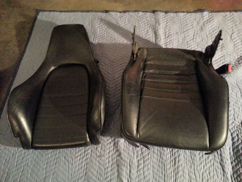

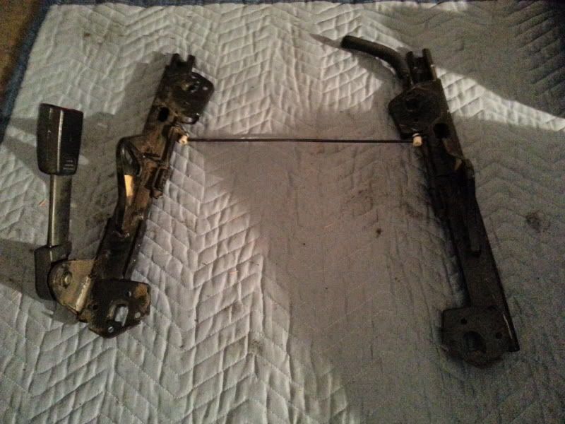

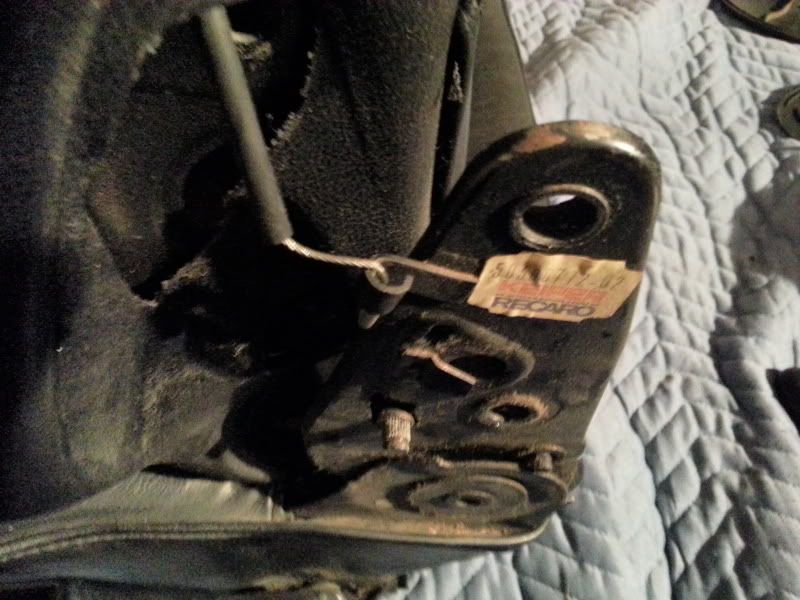

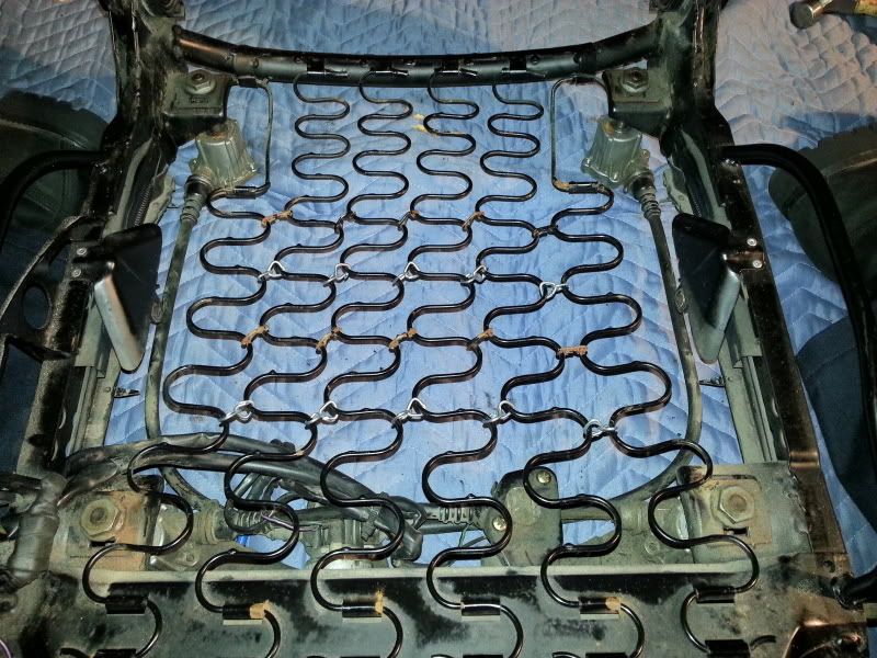

Day 1:
First separate the top from the bottom, sorry there is no other way to get the skins off/on.

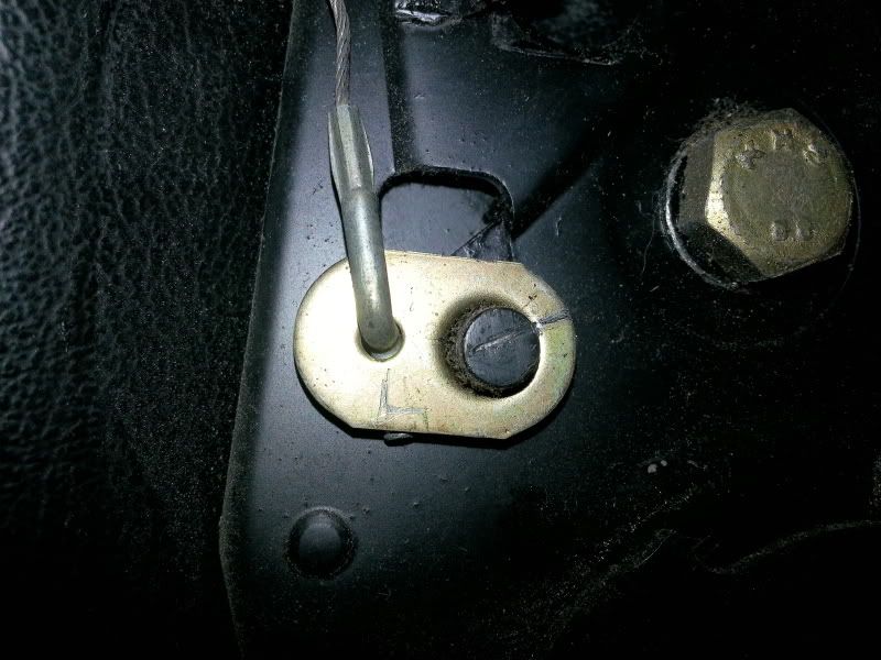

You must raise the seat before removing it from the car.
Mark the seat release ( back seat access cable) before removing
Remove Seat Rails
Becareful of the white plastic guides they are very brittle, ask me how I know $5.00 to replace a set.
Old 01-10-2013, 06:37 PM
Member 911 Anonymous
DRACO A5OG's Avatar
Join Date: Sep 2007
Location: Rancho Palos Verdes
Posts: 14,044

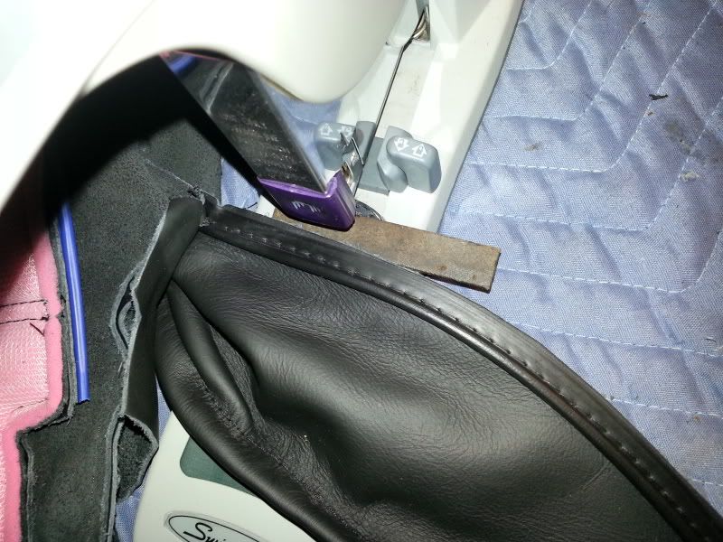

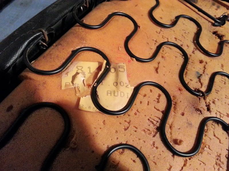

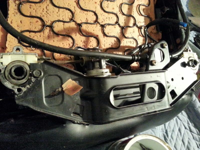

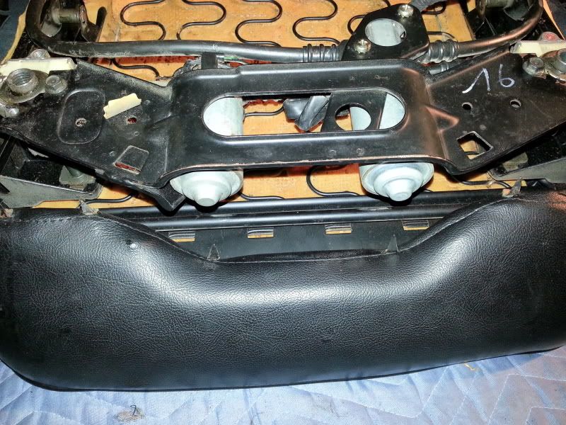

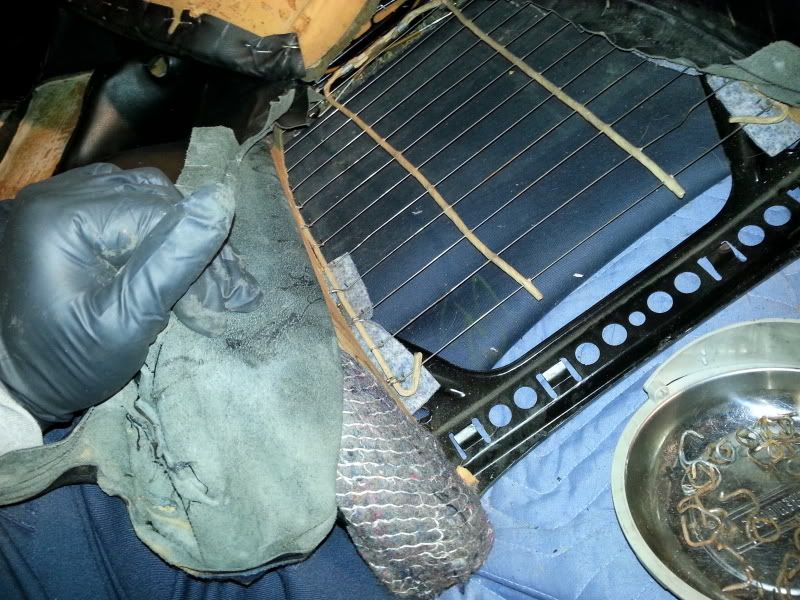

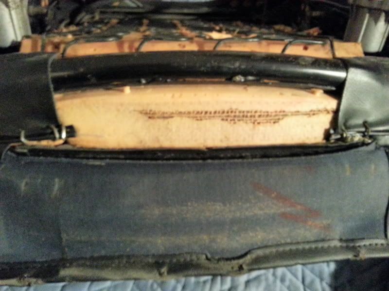

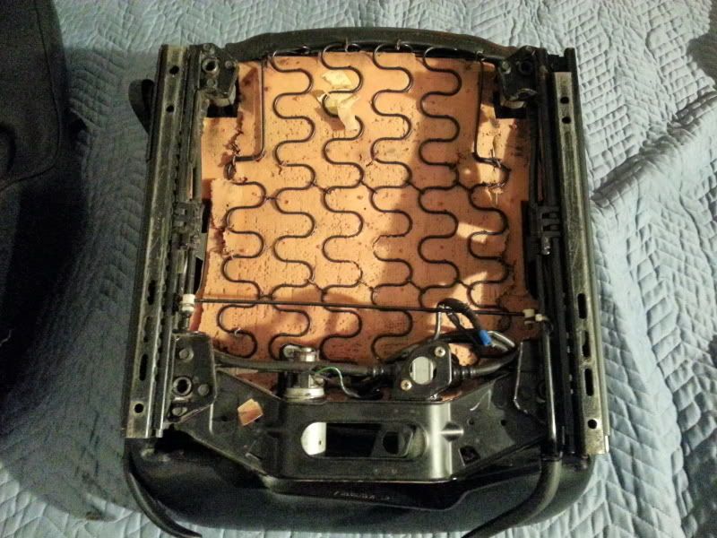

LOL, AUDI Part number

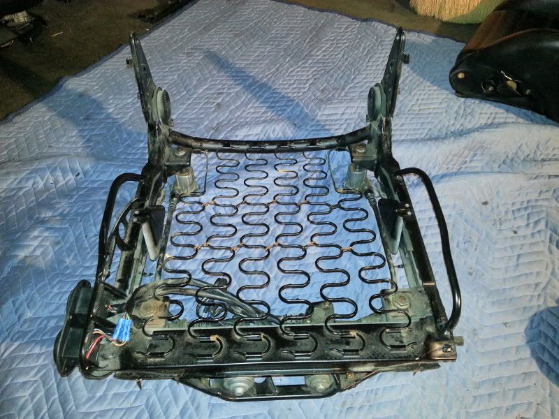

Note orientation of everything, I took photos to remind me

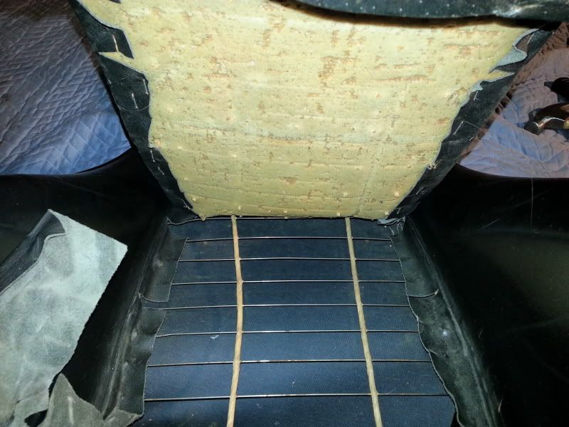

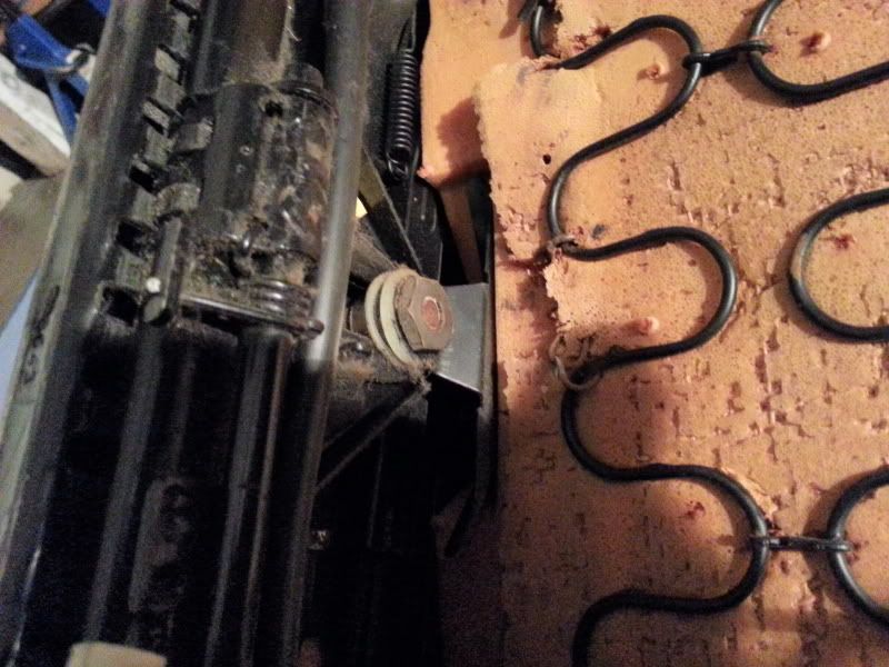

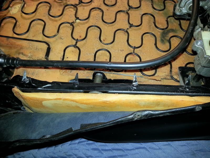

This is a thin wire tensioner to stretch the bottom portion tight.
You do not need to remove the height adjuster, just pull out of the way

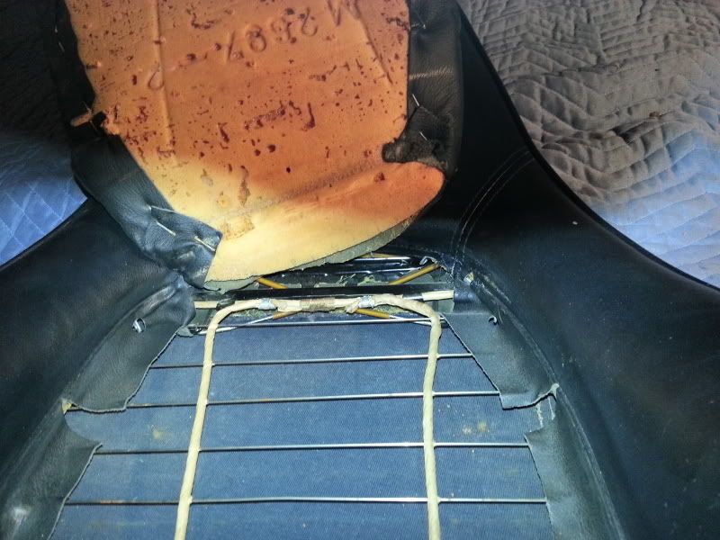

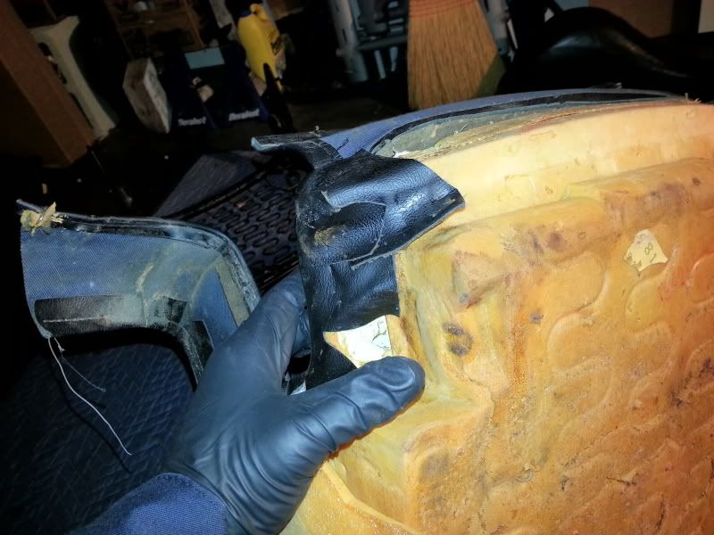

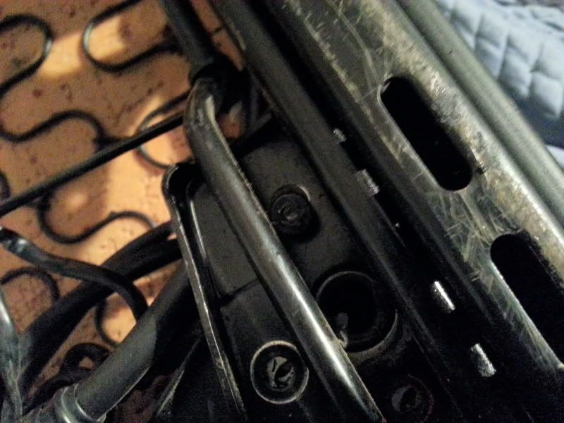

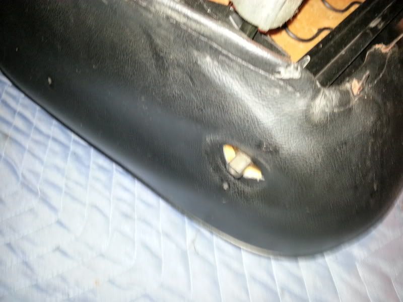

HERE IS WHERE YOU CAN VERIFY IF THE POS OR INSTALLER TO A SHORT CUT, THE 2ND SPIKE FROM THE LEFT WAS NOT USED SO OVER TIME IT CAUSE THE LEATHER TO SLIP AROUND AND EVENTUALLY RIP THE HOLD DOWN STRAPS DUE TO USE.
Note the 3" cardboard tab, remove and staple it on to new skins
'85 Carrera Targa

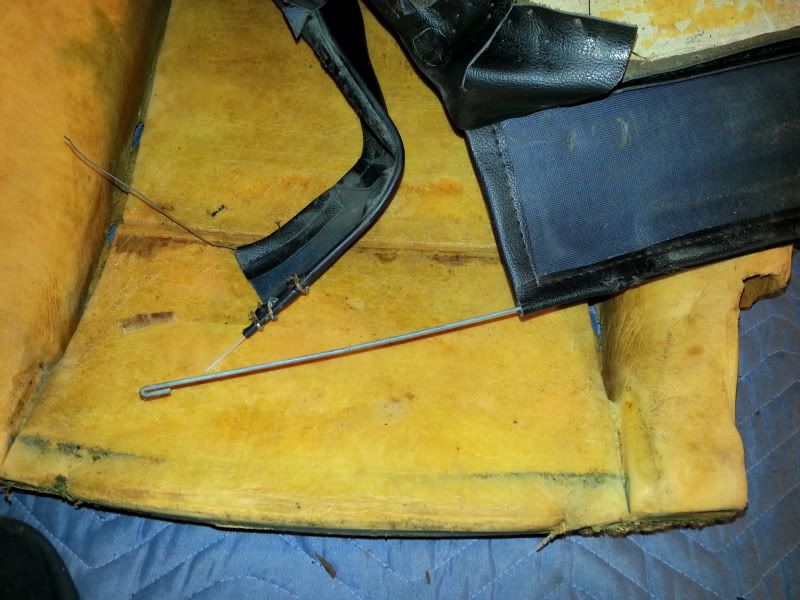

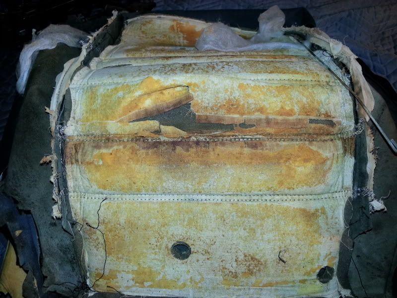

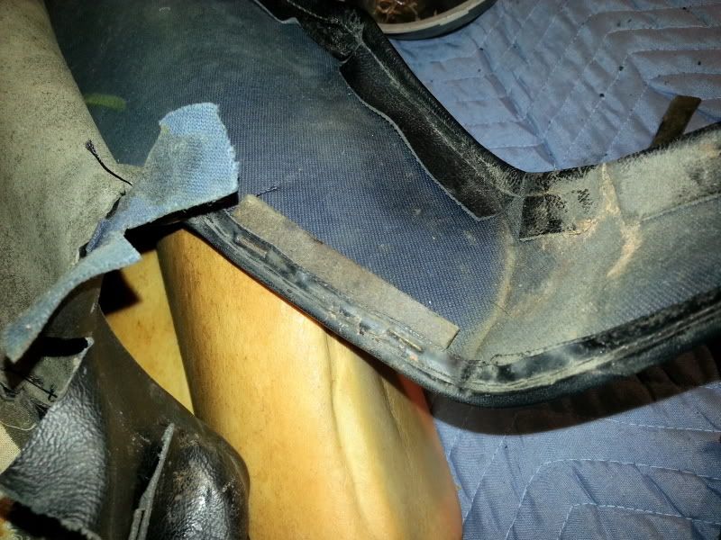

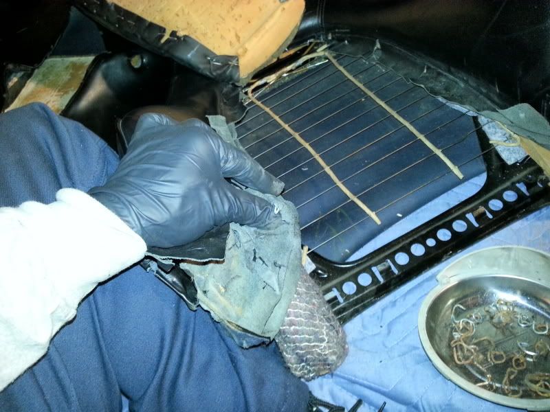

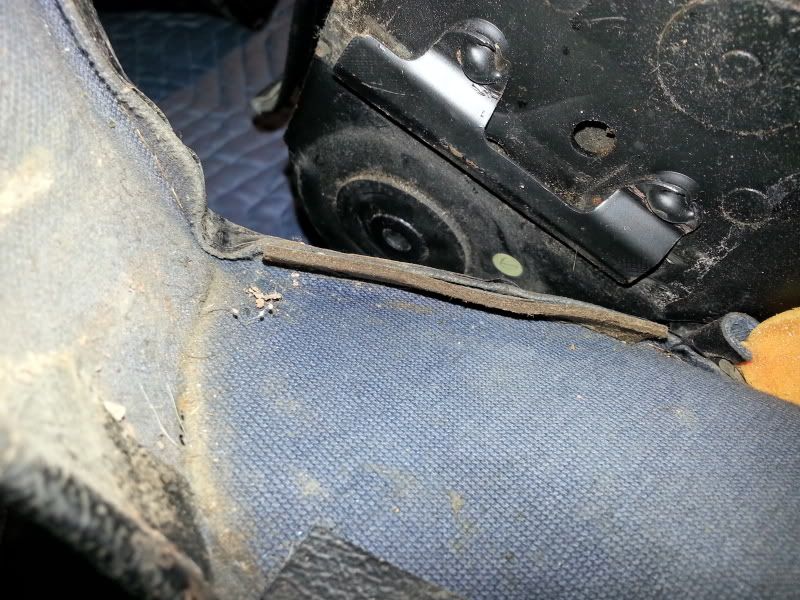

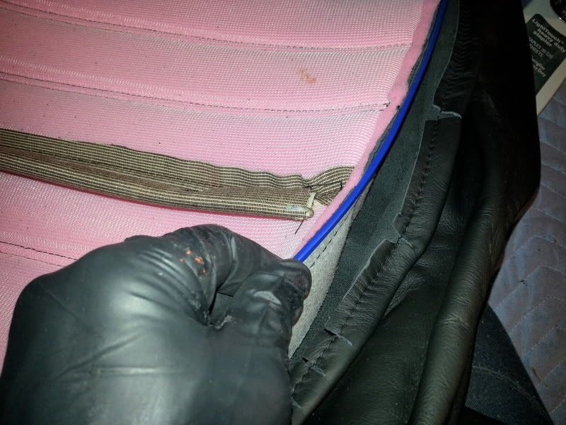

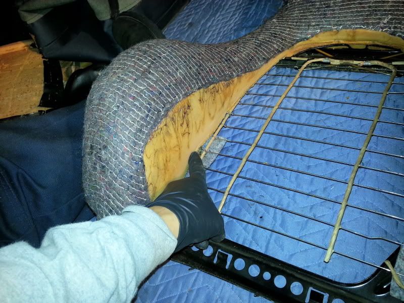

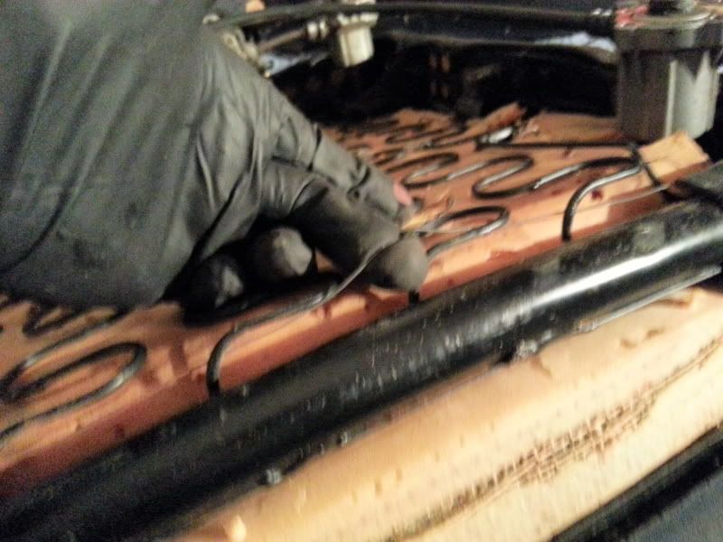

This section covers all the re-used components such as wires and cardboard pieces
Just glue those areas that tore, No worries, once hogged ringed down it will not get worse, on when the seat's fabric rips where the hog rings are held give, then the foams start to tear due to wear and tear.
Autoberry, placed stronger plastic reinforced wires, straps for the hog rings to bite in to, NICE.

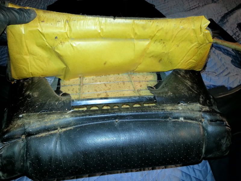

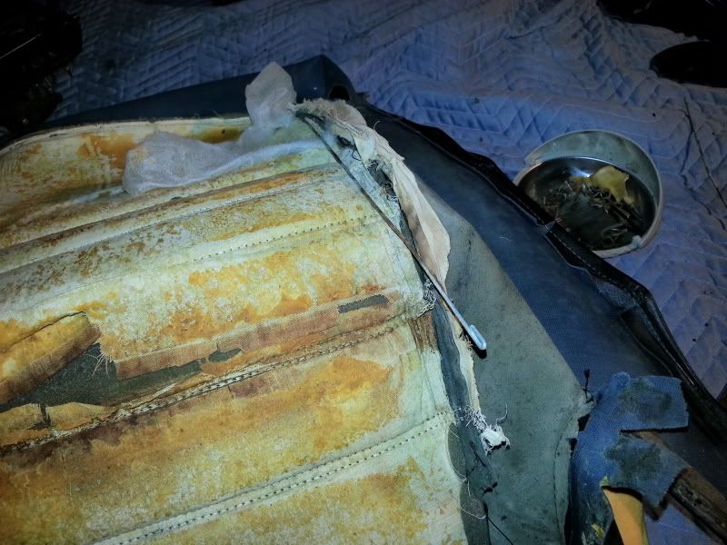

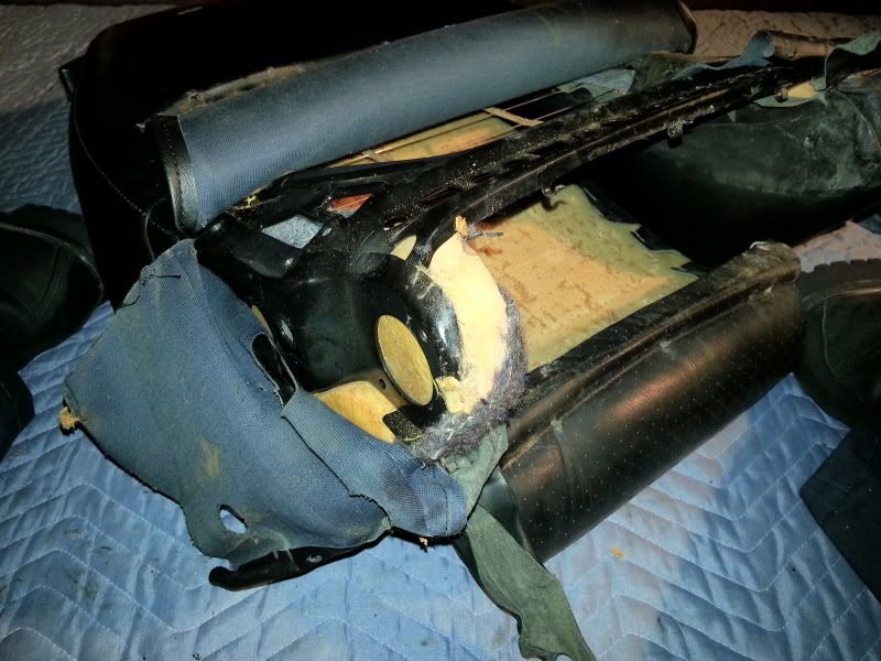

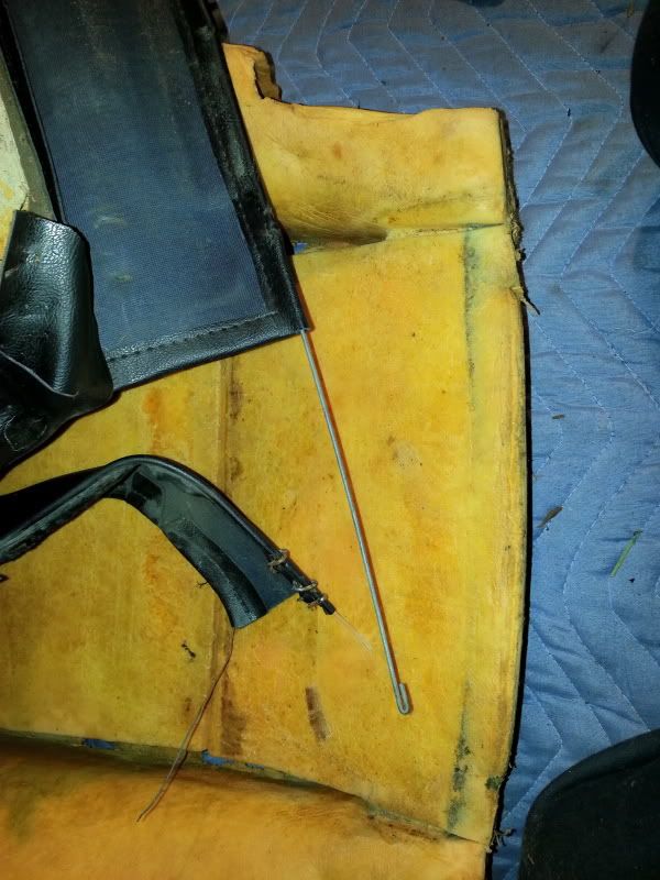

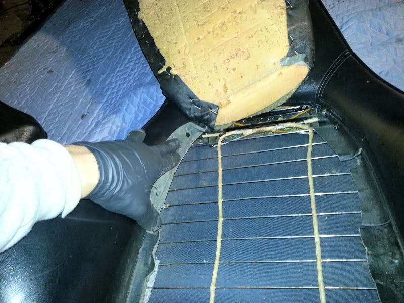

I placed extra hog rings to firm up the seats, the new leather shoud do the same but over time it will sag IMHO. Mine will never sag again.
Ready for steam to puff it back up

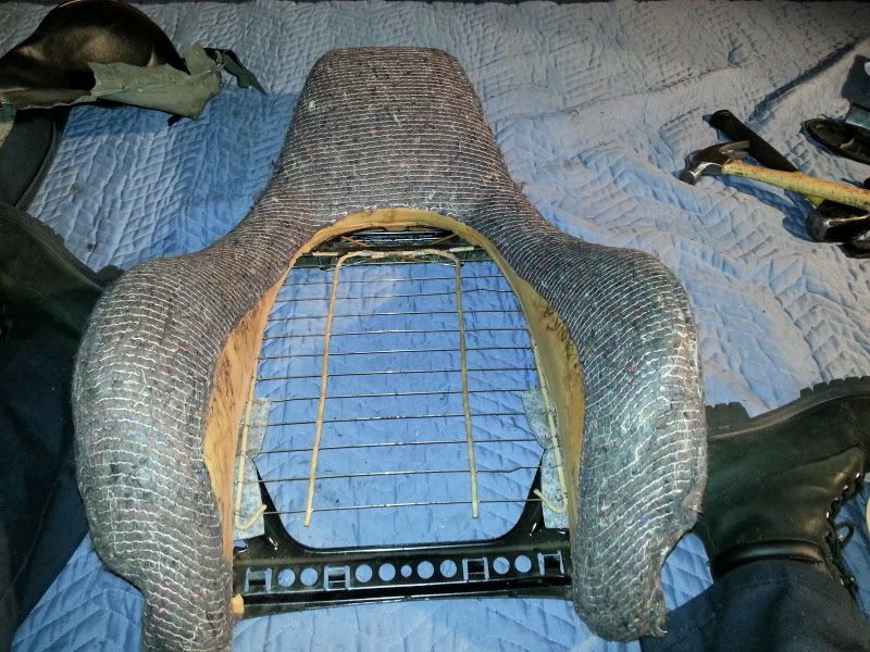

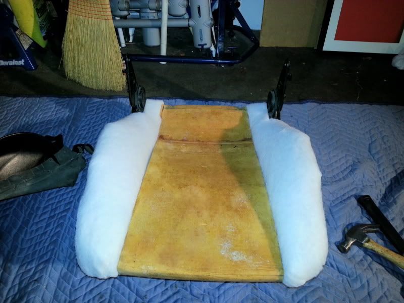

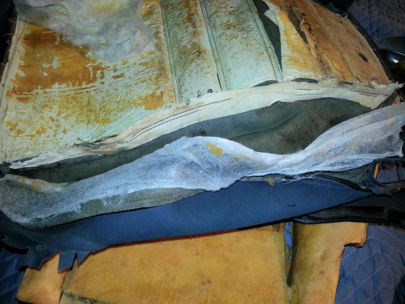

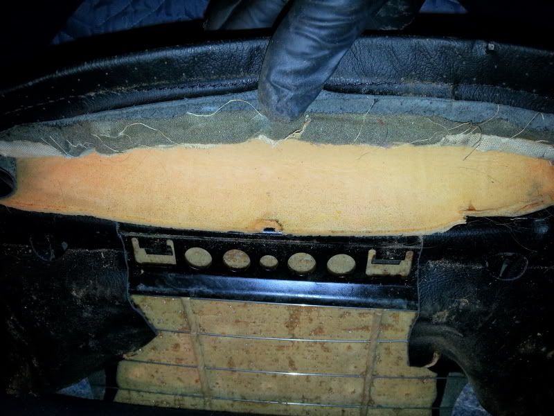

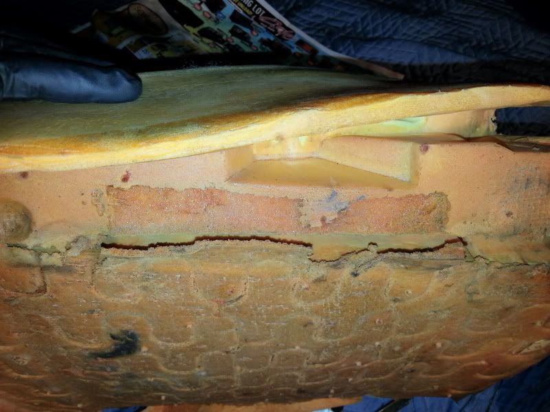

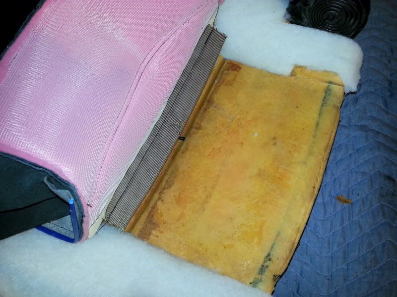

They will swell another 3-5MM's, in areas that compressed. Remove bad batting and replace. Funny the tops had a wool like batting, very nice stuff. I had synthetic but did a better job of coverage, just glue on the bolsters, not the insert area, if you select perforated, you want the seat to breathe, glue it will not.

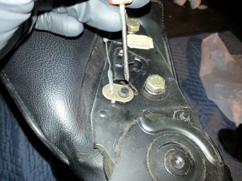

Top dismantle:
Passenger side had OEm batting to conceal hog rings and metal deviations, my driver side did not have it, freakin POS installer short cutted there, I just used batting, perfect no bumps

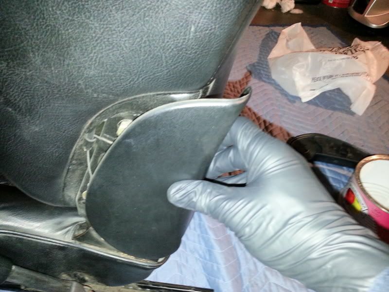

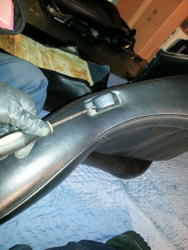

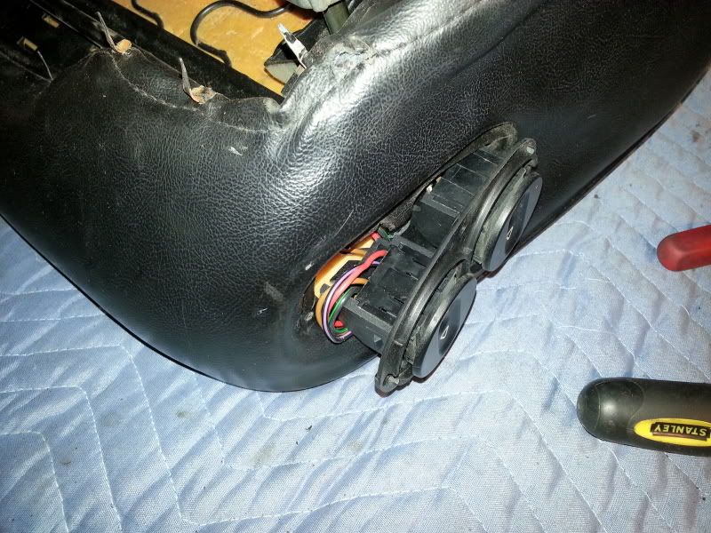

You MUST stick screw drive inside the channel to remove the handle, if you pull from the outside you will break it, ask me how I know.

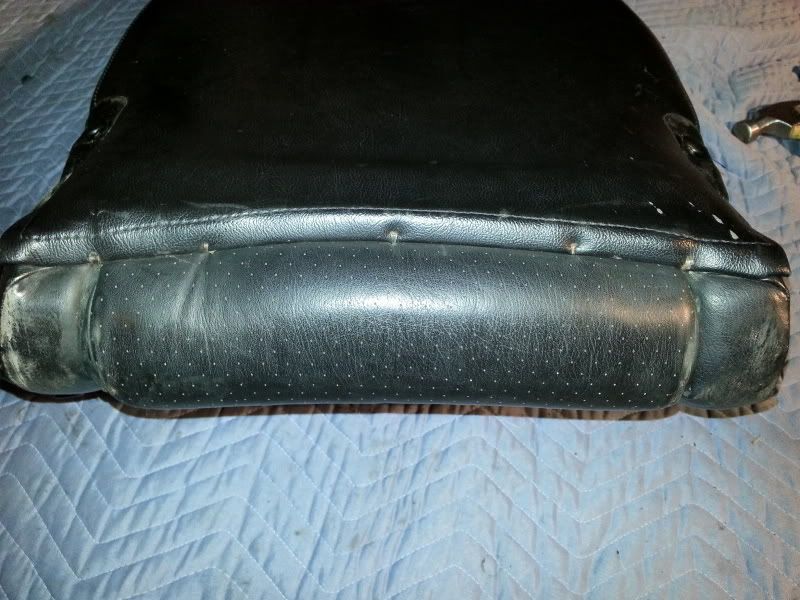

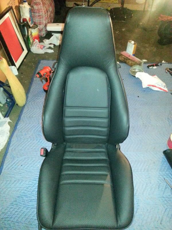

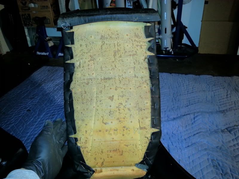

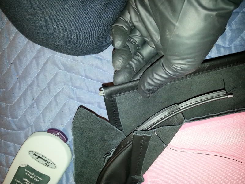

Top inserts are the only ones that need the OUTWARD CLING STAPLES, PITA, the trick here is to hold the staple gun's head down on the leather and foam then staple, if you do not the staple will not penatrate and form the outward shape. I also used glue on the edges only for extra measure.
Ready for Steam:
Prep for install, basically in reverse order, take photos for orientation of the hog rings

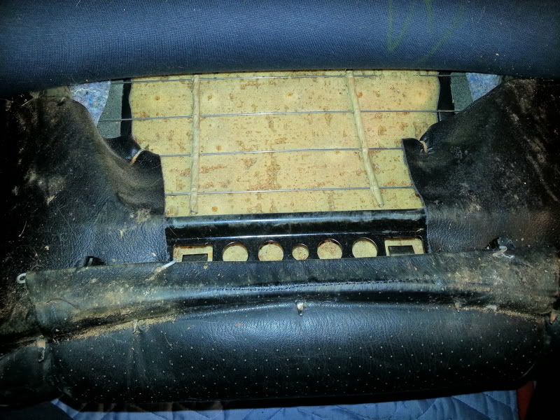

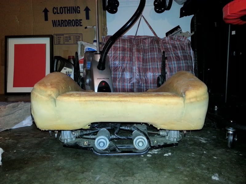

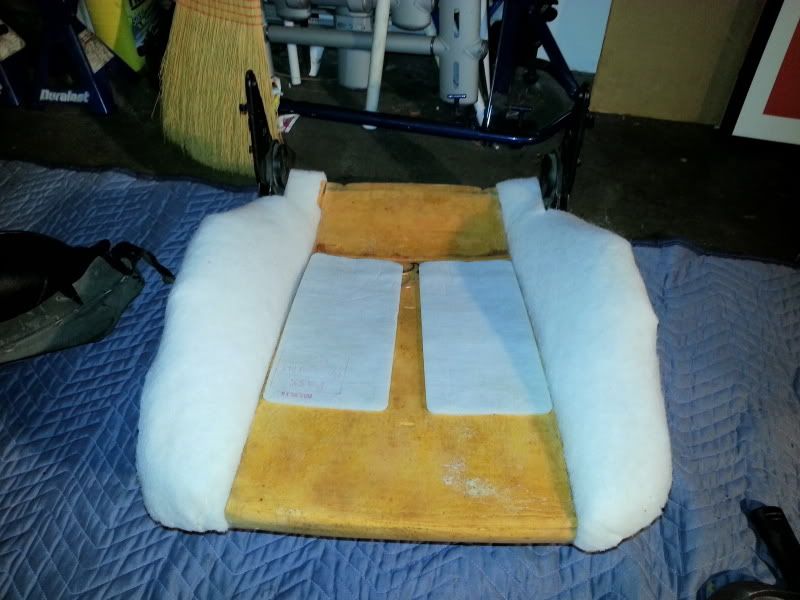

Bottom need batting(matting) original was missing, POS installer cut allot of corners, oh the joy:

With Heat Pads

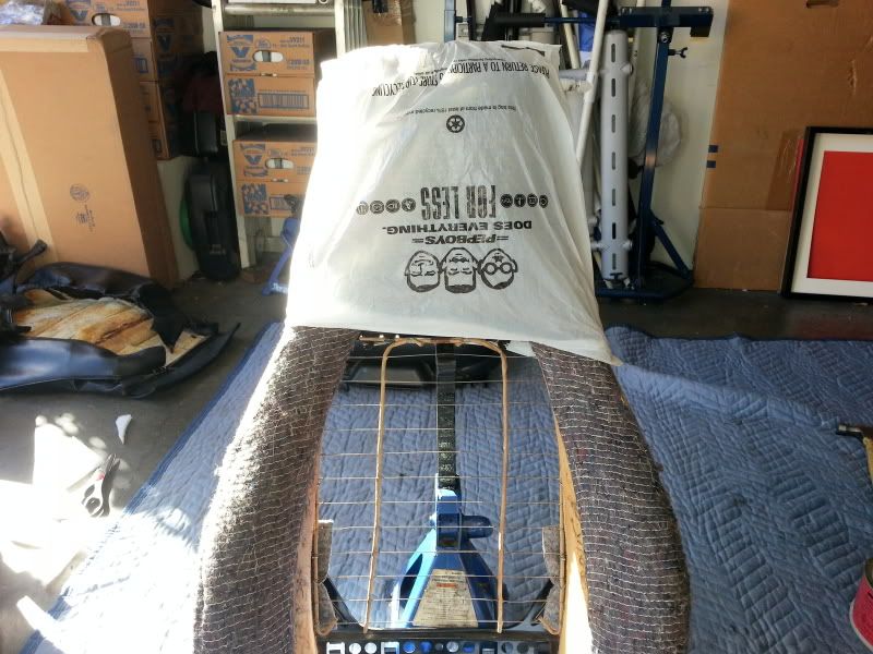

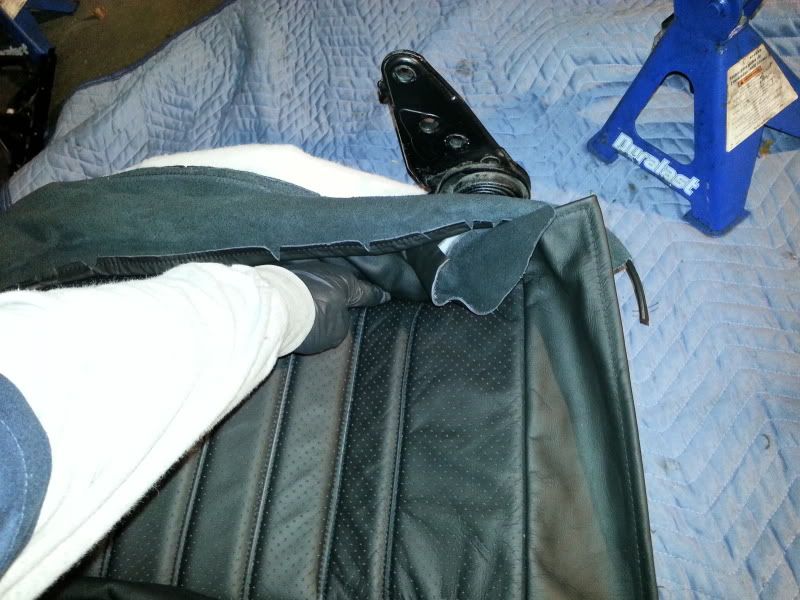

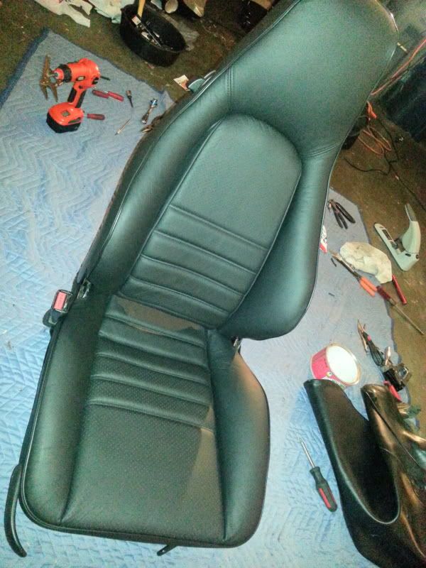

Start with the inserts first using hog rings center to outward, always check position, don't want to start over again :P
Pull over the corners as you compress the foam, work it in as straight as possible, don't worry about the wrinkles, that is what the steamer is for
and wait for it....................................the shopping bag trick:
Seat Heater Switches:

Posts: 14,044

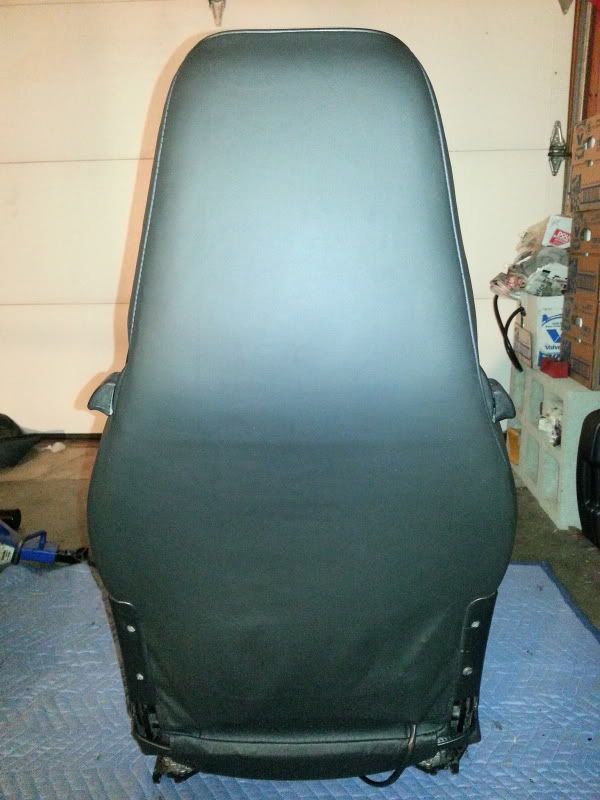

See the bumps at the bottom, this is drive side without batting, I have since placed batting, no more bumps

Doyle, make sure they remove the rail to use all the spikes on the frame, POS installer skipped one spike that contributed to the skins getting loose, have them send you a pic of the rails removed to be sure since you are paying an arm and a leg.
