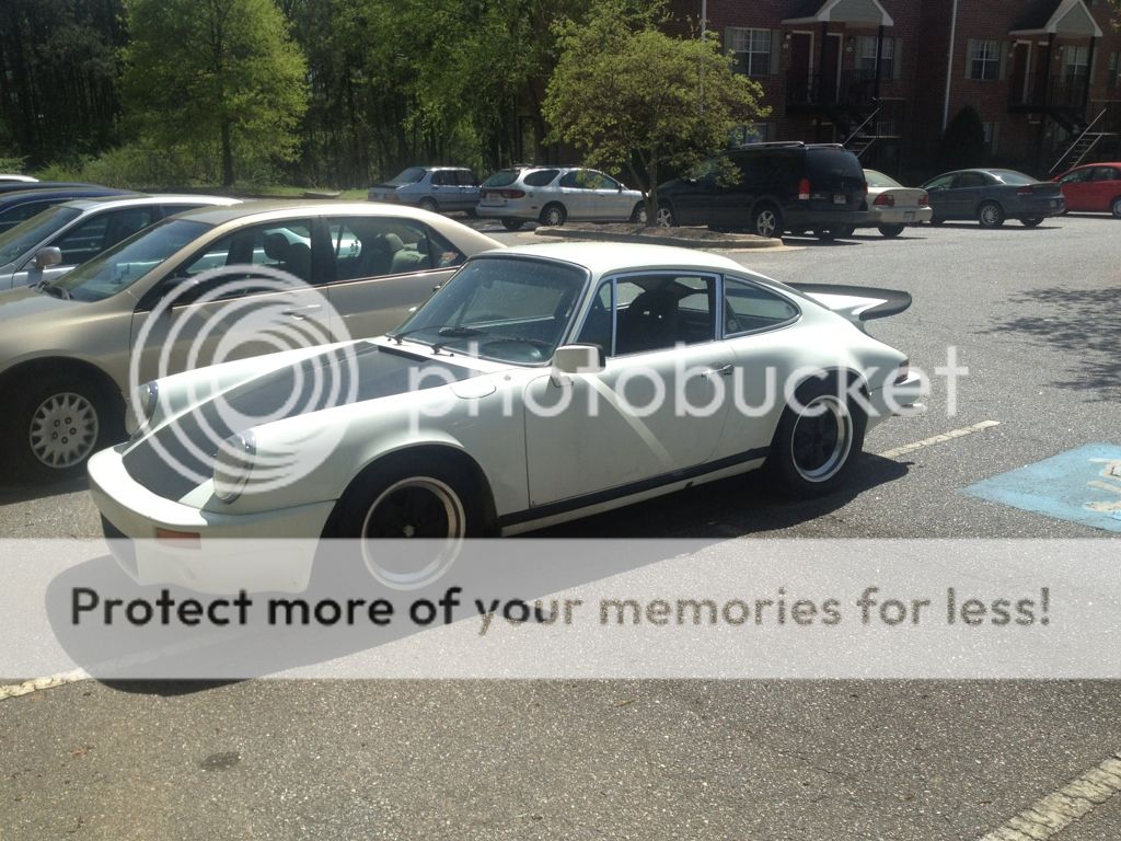

EDIT: Oh heres a picture to make this thread a tad easier to look at.
http://i995.photobucket.com/albums/a...ps836d819d.jpg
