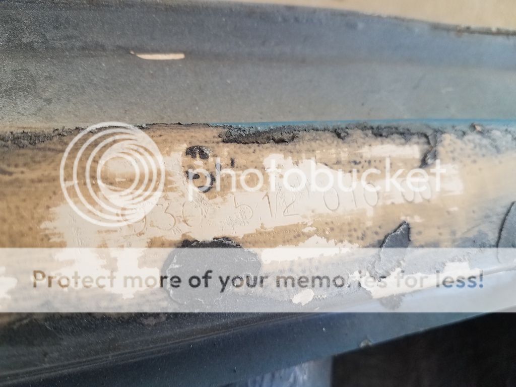

I suppose it depends on what you want to do with it. If it needs repainting anyway, or if you plan on selling it, you'll need to have the part number. How you expose it would be up to you, but I would probably use a stripper before I would sand, it if it were mine.

hot-j 07-21-2017 10:48 AM
Sorry to hijack, but one more question to you guys in the know. This tail is all fiberglass where as the early 930 tails had a metal base? Is this correct?
javadog 07-21-2017 10:55 AM
I've never seen an all fiberglass tail, but there are some that claim to have seen them. I don't think there are that many, if they do in fact exist, so I don't think your chances are very good, given how many replica all fiberglass tails do exist. There's only one way to find out, so start looking for part numbers and start posting detailed photos of what you have.

hot-j 07-21-2017 10:59 AM
JR
On my way to hardware store to strip the paint photos incoming. This is definitely all fiberglass and there is definitely a part number under..... I'm very excited!
hot-j 07-21-2017 12:46 PM
http://i740.photobucket.com/albums/x...ps52xypr4q.jpg
930.512.010.00

javadog 07-21-2017 01:01 PM
Well, it's not a '74 3.0 tail. The part number would indicate that it's an early turbo tail but I'll leave it to others to decide if it's original, or not.
