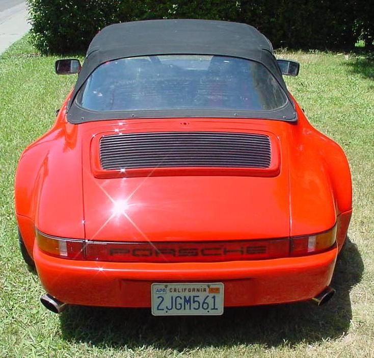

1 Attachment(s)
I would definitely use a good quality HVLP. I have used both and think that once you get used to the amount of paint the HVLP gun lays out, you can get a better finish. I painted my 85 Carerra in my garage using a Sharpe T1 Titanium and I think it came out pretty well. Good Luck.
widebody911 08-03-2002 06:36 PM
I painted my '77 in my garage with the DeVilbiss HVLP I got @ Harbor Fright. It's "Ok" I guess.
