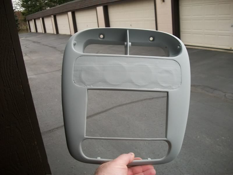

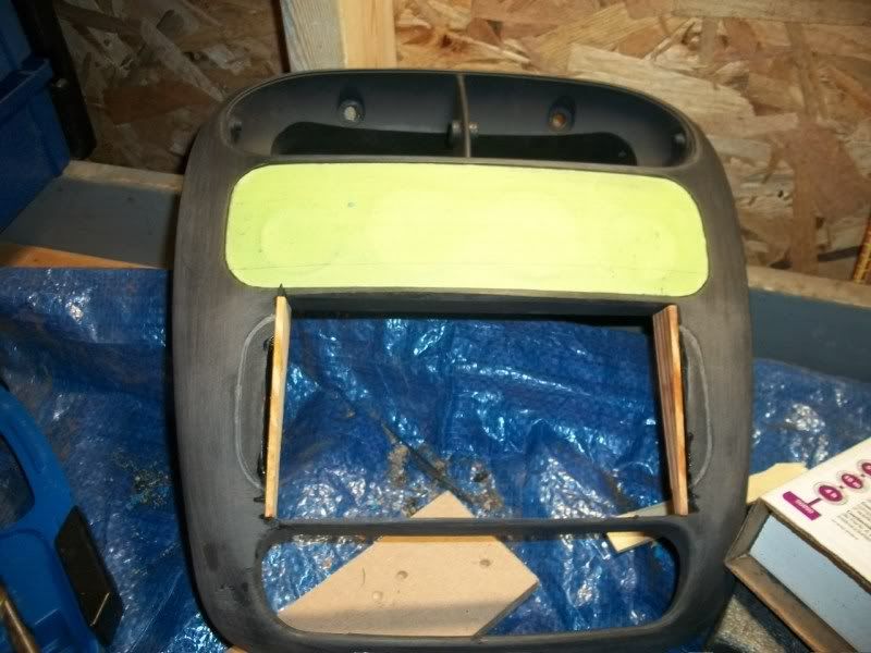

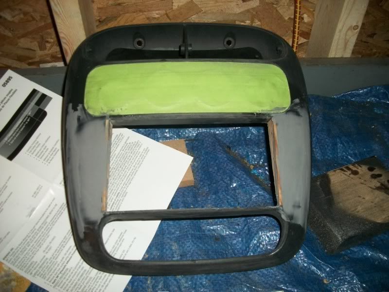

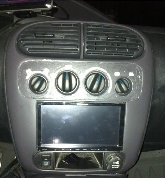

i'm not exctly sure how this would work on a dash but i love the stuff. it was what i used for a filler when doing custom work on a dash for radio installs. i think it would be perfect for this application as it is made for parts like flex. it works like a dream and sands like butter.
just to give you an idea
gray stuff is the filler
- He gave his father "the talk"
- Once while sailing around the world he found a shortcut
- He taught a german shepard how to bark in spanish
He is.... nineball. I don't always drive sports cars, but when I do I drive a 1983 911SC Targa. Stay fast my friends.
