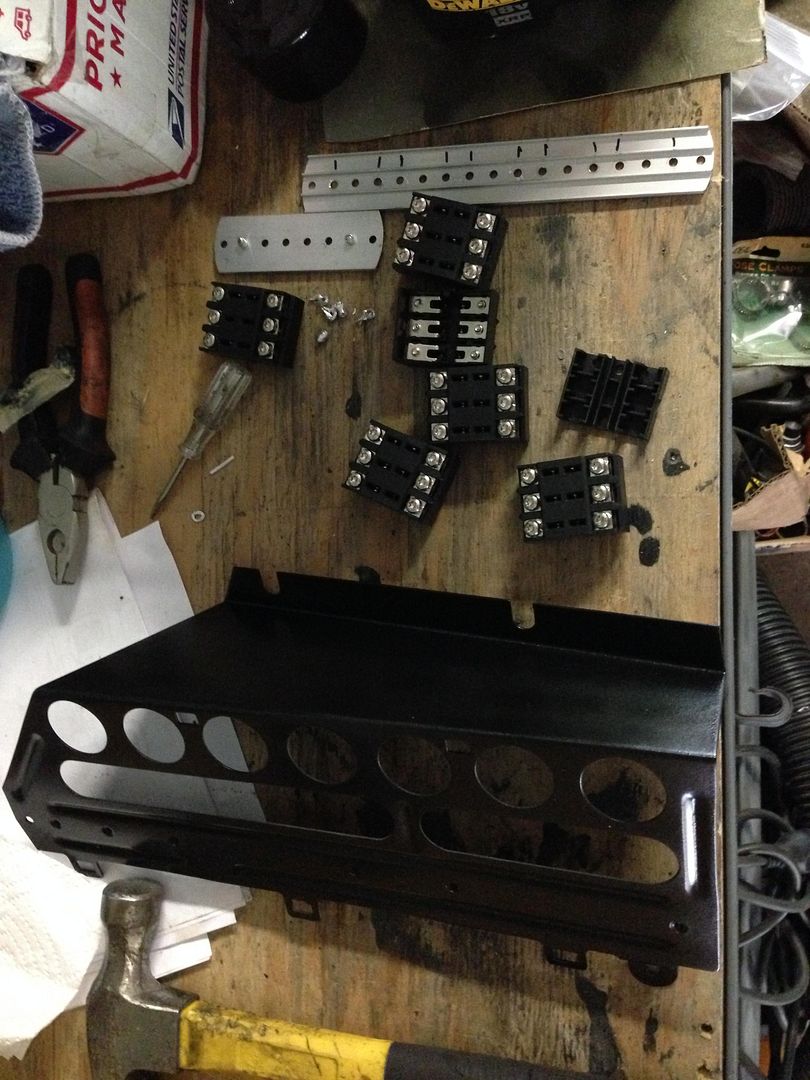

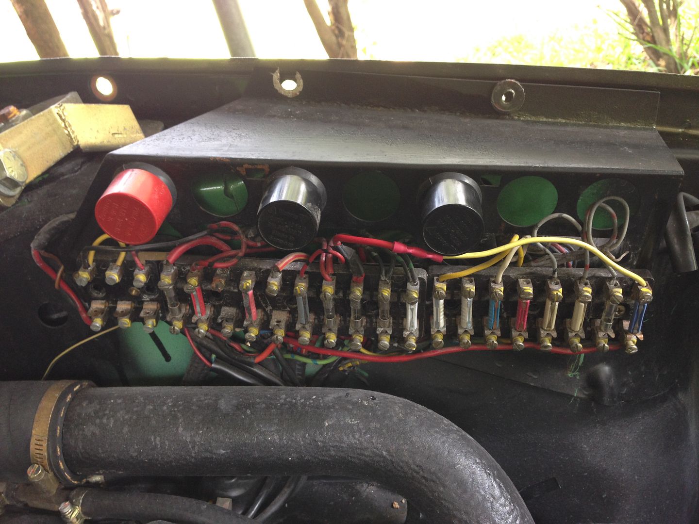

I finally tackled this job this weekend.
I used the Chief fuse blocks and overall am happy with them, but did experience the same issues that DohertyCM mentioned above.
Started here
http://i35.photobucket.com/albums/d1...ps06afd055.jpg

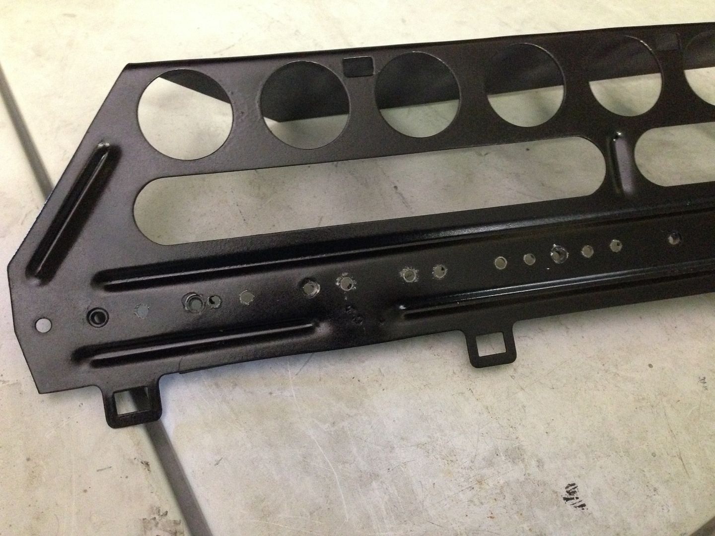

Pulled the fuse panel and cleaned it up. Also drilled out all the rivets from the Chief blocks and separated the blocks into the inner and outer halves.
http://i35.photobucket.com/albums/d1...ps0f9f0241.jpg

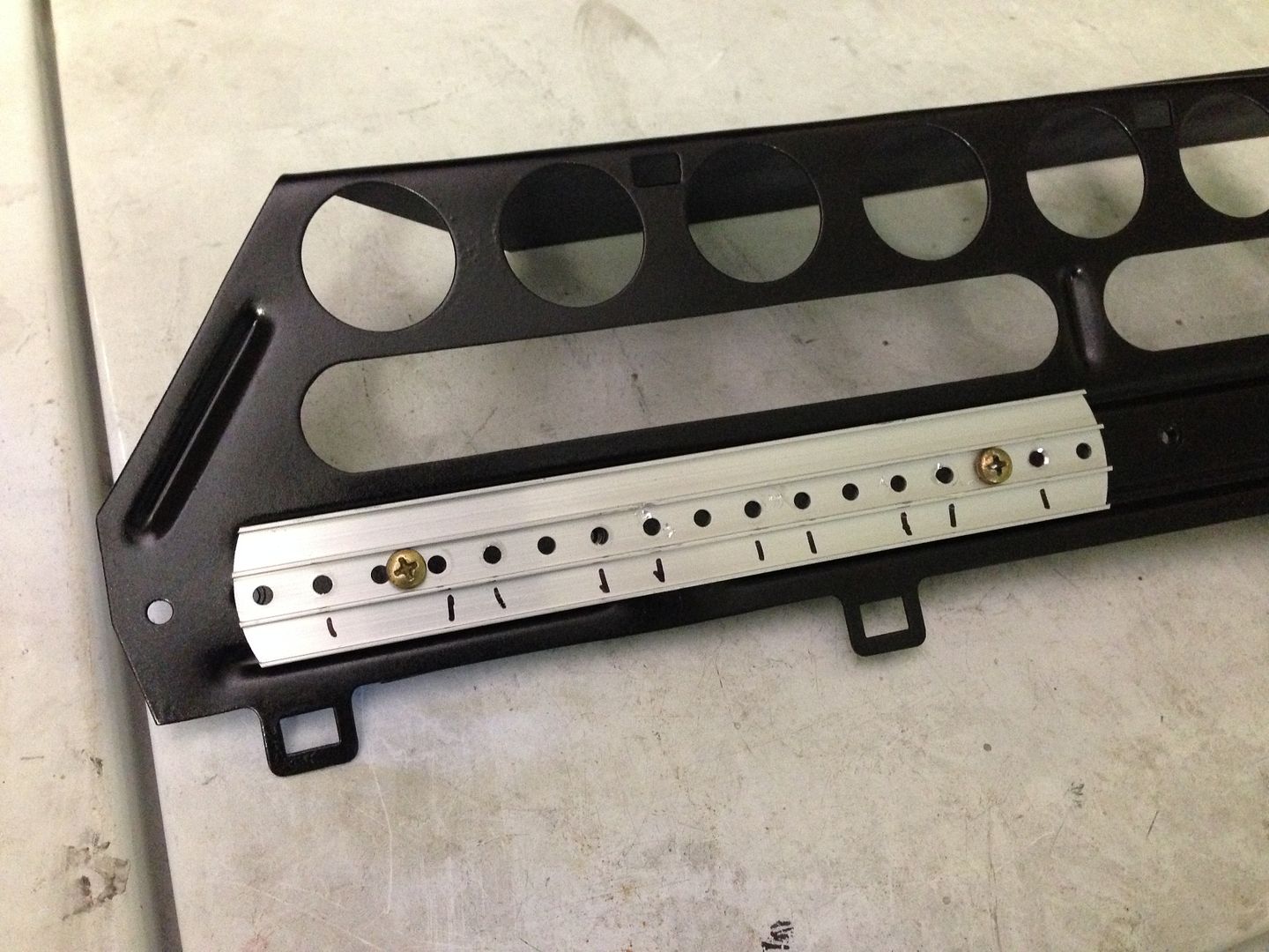

Then using the stock screw locations, screwed the aluminum strip from the Chief blocks to the 911 panel to provide a spacing layout.
http://i35.photobucket.com/albums/d1...pseeeb63b9.jpg
This gave me relatively straight holes that are spaced correctly for the Chief blocks.

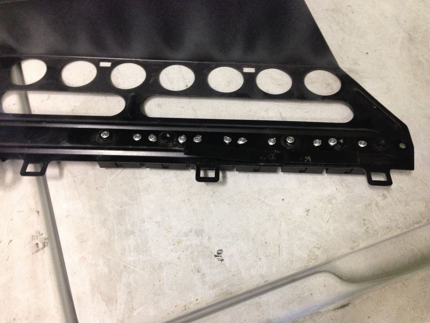

Then riveted the Chief blocks directly to the 911 panel. They are not perfectly straight but close.

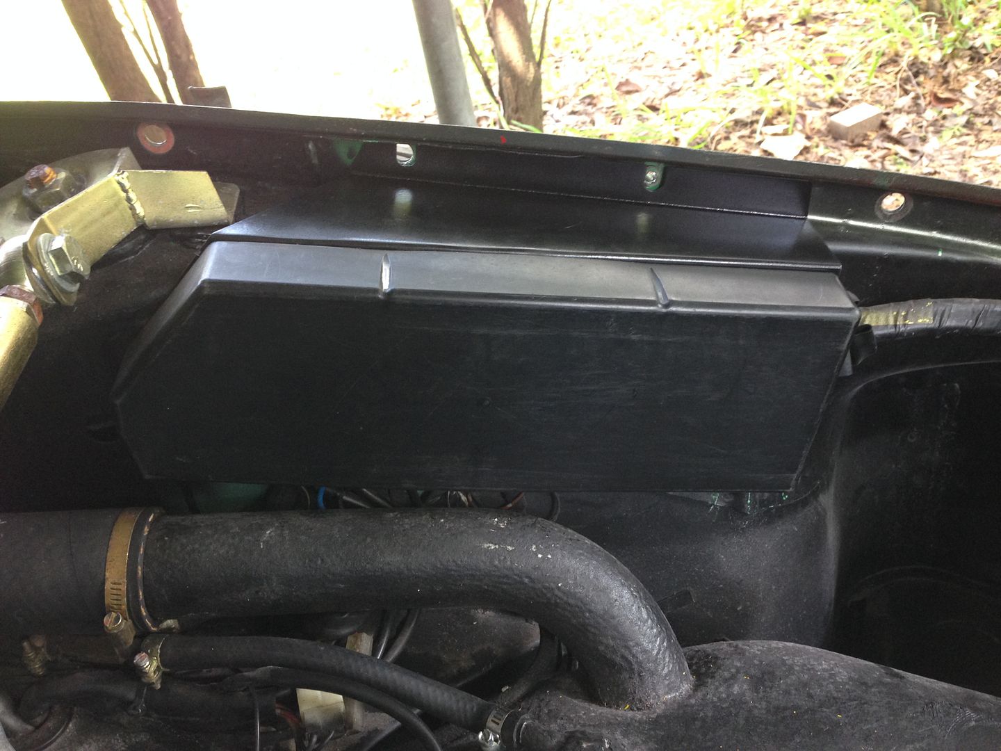

The lid still fits well
