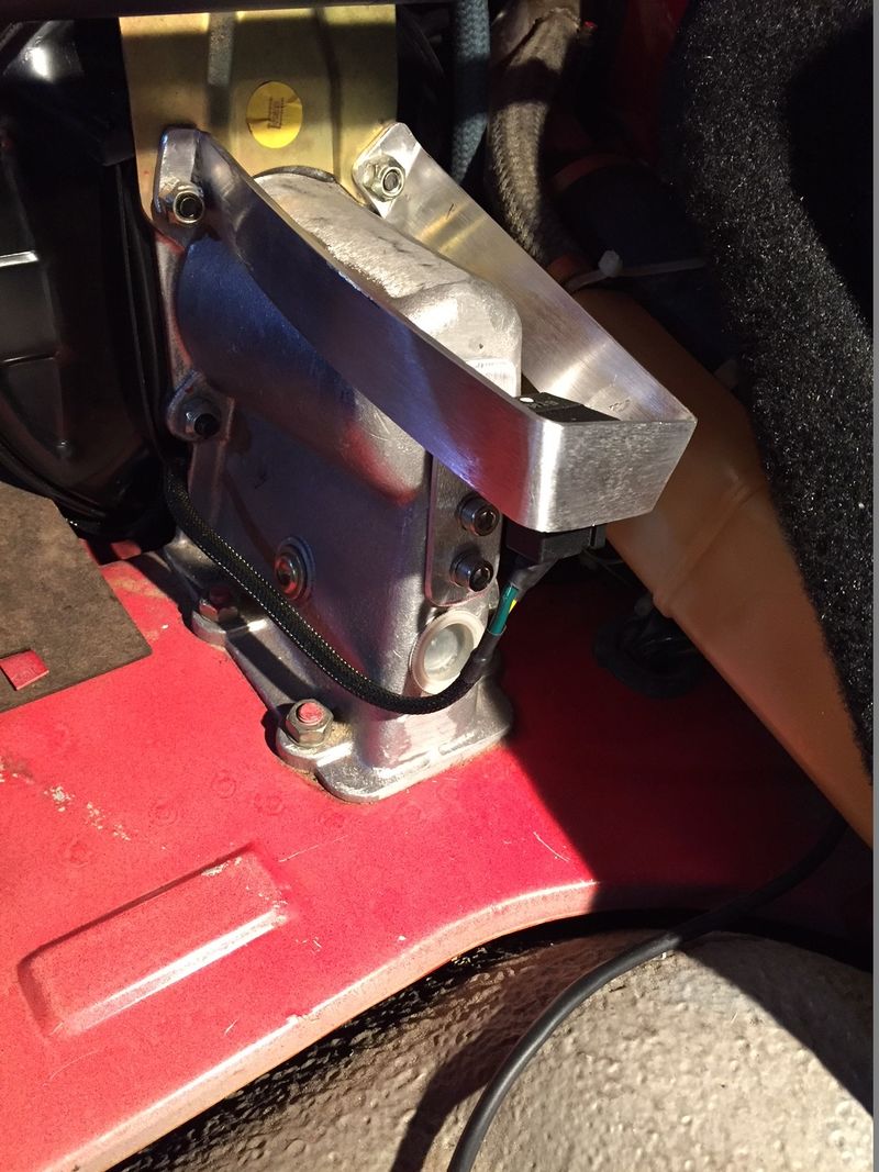

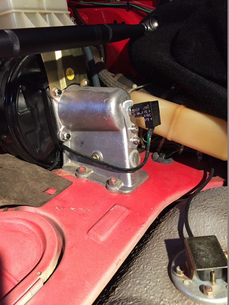

I have tried the standard recommendations to improve the brake light response time on my ’87, including new switches and cleaning contacts, etc., (as you did, RSBob), but I really was not satisfied with the result: there just is no way to ensure activation, in the stock system, with only light application of the pedal. I have found myself actually over-actuating the brake pedal at stop lights or in stop-and-go situations in order to ensure that the brake lights come on. This is not the way it should be. I therefore decided to install the mechanical switch, and you can see here what I accomplished (I did the install over the last weekend). I am very pleased with the results, and I finally feel like I don’t have to worry about this issue. Like others, I wired it to run in parallel to the pressure switches, so it is a redundant system (I essentially piggy-backed off the second circuit switch). You can see in my photos that I went with a small bracket attached directly to the booster mount housing to hold the switch, but then I added a “protection” bracket to prevent it from being knocked off when throwing things into the trunk.
http://forums.pelicanparts.com/uploa...1524492094.JPG
Very robust, I think, though perhaps not as elegant as others without my limited fabrication skills and equipment could achieve. I really want to thank Craig_D, Arne2, and everyone else’s inputs on this topic. Great ideas, and a fine example of community innovation. Much, much appreciated.

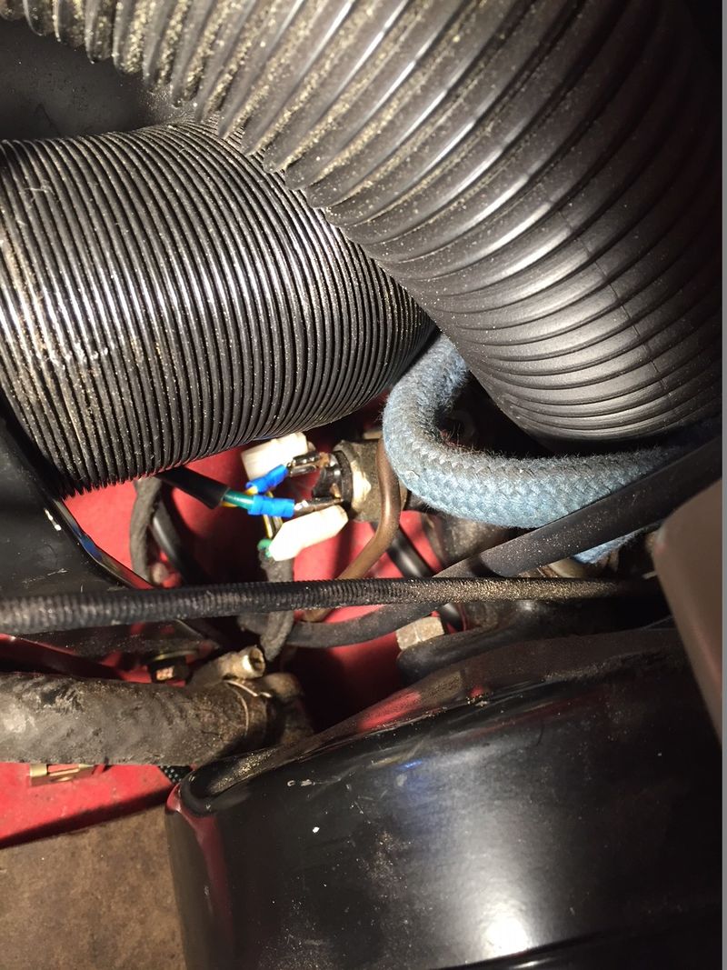

Brilliant! Thanks for the share. Did you then wire it into the existing leads off the old sensor? Which one? Or does it matter?
Craig_D 03-17-2021 04:10 PM
Thanks! Yeah aside from my solution, there are a few other great ideas in this thread.
To see where I stuck the blades, look back at this post. I just pressed the blades from the electric brake actuator into the existing leads for the hydraulic actuator. So I have redundancy, in case the electric actuator fails.
http://forums.pelicanparts.com/porsche-911-technical-forum/773628-mechanical-brake-light-switch-modification-78-sc-2.html#post8374868
dan88911 03-18-2021 05:24 PM
When I did this upgrade I used a Double Male-Female adapter on the brake light switch leads to achieve the redundancy function.
