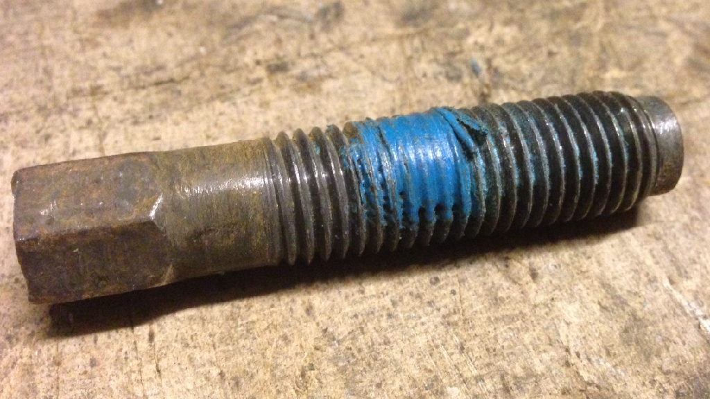

Flojo 02-03-2014 02:10 PM
OUT!
Was badly stuck due to locktite :-)
http://i1108.photobucket.com/albums/...2260598FDE.png
