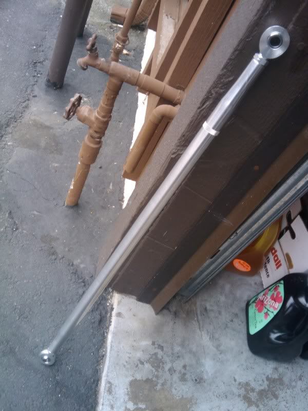

Fellas, since they are no longer sold by our host. I can now show all how to build your own.
Home - Speedway Motors, America's Oldest Speed Shop
Prices may have changed, I think they offer other colors as well. Trick here is to use the longer lower OEM bolts for the top and go to Napa for the longer bolts for the bottom, go to ACE hardware and pick some mylar flanged shims, cut off the top to make bushings for the bolt and tie rod end, note the bolts are SAE not metric, it is a DOT thing.
http://img.photobucket.com/albums/v5...421_095250.jpg
910354-28 SWEDGED 6061 ALUMINUM RADIUS ROD FOR 5/8" HEIM 2 $11.99 $23.98
3159604 5/8-18 LH Aluminum Jam Nut 2 $1.99 $3.98
3159603 5/8-18 RH Aluminum Jam Nut 2 $1.99 $3.98
1170810 Aluminum X-Series RH Male Heim, 5/8" Shank, 1/2" Hole 2 $9.99 $19.98
1170810L Aluminum X-Series LH Male Heim, 5/8" Shank, 1/2" Hole 2 $9.99 $19.98
SmileWavy for my fellow Targas

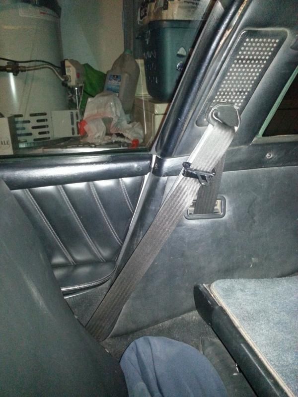

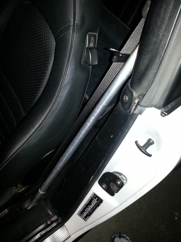

Funny, All the recent discussion about the Targa braces motivated me to re-install mine. (The original style the host used to sell, I think I bought the last set!)
I removed them as I didn't like the polished aluminum look. I thought about painting or powder coating and then ended up using some heavy duty heat shrink on them to dull the clank of the seat belt when retracting.
I think they look a lot better now, definitely quieter.
http://forums.pelicanparts.com/uploa...1396214189.jpg
DRACO A5OG 03-30-2014 02:41 PM
"Heat Shrink?" That is an awesome idea. Think I will do the same, My seat belt is maring it up something fierce.
Could you post a current pic?
J
timmy2 03-30-2014 04:17 PM
J
LOL, I took the picture 10 minutes before I posted. The Heat Shrink is on them in the picture! Right beside the seat belts...
Sort of a dull Black lighter than the belts, they used to be highly polished Aluminum.
I think the camera flash made them look brighter than they are.
Is this no flash picture better? The nut on top is aluminum, they used to look just like it!
http://forums.pelicanparts.com/uploa...1396221259.jpg

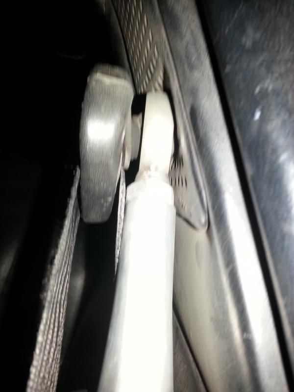

DRACO A5OG 03-31-2014 09:07 PM
Like the original, you have to be looking for it from the front to see it:
http://img.photobucket.com/albums/v5...ps4b662a78.jpg
Mine with the Slim Tie Rod End:
http://img.photobucket.com/albums/v5...ps45b5bd15.jpg
Observed from Driver Side:
http://img.photobucket.com/albums/v5...ps996d3f26.jpg
Remember you want the two end to go outward, not inward.
