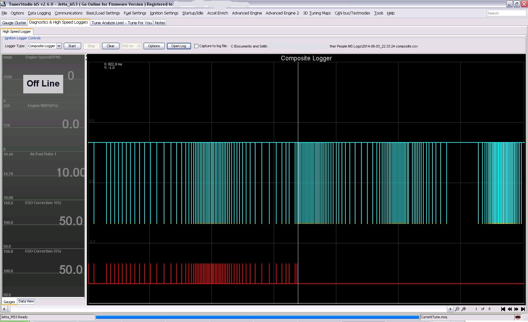

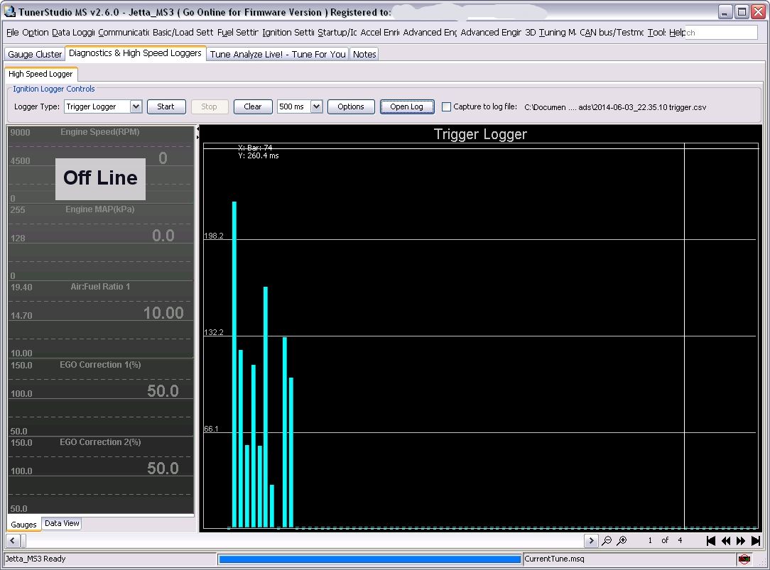

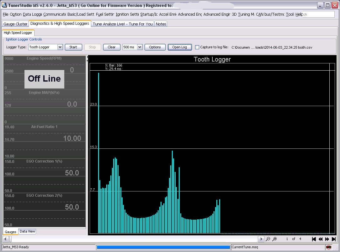

I would start with the adjustment of the board mounted pots. Here are the composite and trigger datalogs you posted in the MSExtra thread.
http://forums.pelicanparts.com/uploa...1401814095.jpg
the MS unit is clearly seeing your cam signal. The tall spikes are evenly spaced at 342ms corresponding to about a 175rpm starter speed.
What is happening is that the low level filter is not set correctly for the crank input and it is seeing the small spikes. If you look at the tooth signal you will see that the lower side the individual teeth drop out and some of the crank signals are missing. This is why you need to start with adjustment of R52 and R56 on the board. Set those as previously indicated and take the log again.
You can watch the live trigger signal in TunerStudio. Adjust them until the peaks are very even and consistent with no drop outs.
Here is more on the adjustment.
http://www.diyautotune.com/tech_articles/vrsensor/megasquirt_vr_index.htm

And here's what those logs look like in Tunerstudio zoomed in:
http://i458.photobucket.com/albums/q...ps52b1bd87.jpg
http://i458.photobucket.com/albums/q...ps3f59e525.jpg
http://i458.photobucket.com/albums/q...psbec1b40f.jpg
POTS POTS POTS :cool:
