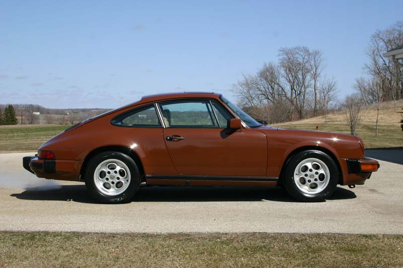

Hi, i have read Cookie cutters may be a good choice as autocross wheels. Many listings claim they will only fit up to 1986. I have 16" oem Fuchs wheels and a set of 17" Fikse wheels, the tires on the 17" are old and dry rotted, first thought about getting tires for them, but the more I read the better choice maybe 15" and same size tire all the way around? Any ideas, comments? Any pictures of a g-series on cookie cutters?

I have used 15x7 Cookies on my 88 Carrera for four years of autocross. They fit just fine. 225/45-15 tires are about 23" dia. versus 24.7" for standard sizes. This lowers the car and the gear ratio for better handling and faster acceleration. At first I had 205/50-15 tires in front but 225/45-15 fit just fine with either Nitto NT-01 or BFG Rival tires. I currently have the BFGs to stay in production class for PCA and CS in SCCA. I did install small spacers on the rear (14mm) to maintain standard track. 15x7 Cookies are ET 23 which is perfect in front. They are also pretty light and strong. Used ones go for ~$50-75 each.

Yes, 225/45-15 on all four. Others have suggested this and I have found that a square rather than staggered setup is great for autocross. I get better grip at the front and the car rotates a little better. Controllable oversteer is big fun and quick for autocross. The BFG Rival is a very good autocross tire with great grip and a predictable break-away at the limits of traction. My results have been very good so far this year.
For general street use a staggered setup is best and also looks right on a 911. For autocross I am going strictly for performance.

I've seen a number of SCs and Carreras using 15 inch wheels successfully for autocrossing. Shorter tires give you an advantage.
