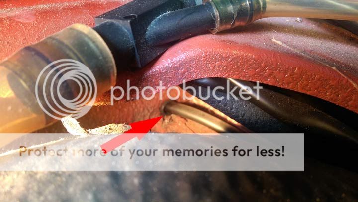

I have a large gauge black wire coming from the drivers side to the battery. There were a few loose cables left here from the PO who did the battery re location/delete. I asked about this wire in another post but couldn't get a clear answer so I am going to try again here.
http://i791.photobucket.com/albums/y...ps62b18761.jpg
The cable is black and large gauge so I initially assumed it was a ground but the more that I have been looking at these wiring diagrams, it looks like it could be a dedicated hot lead to the starter motor? I want to confirm that is what this is before I go shorting this large gauge wire and frying my electrical system.
From what I can tell, it looks to be the same color/size as the wire at the starter. I looked under the dash to see if I could trace it but it seems to enter lower in the cab and my assumption is it goes through the tunnel to the starter.
My hunch is that this is the simple solution to my seemingly complicated problem.

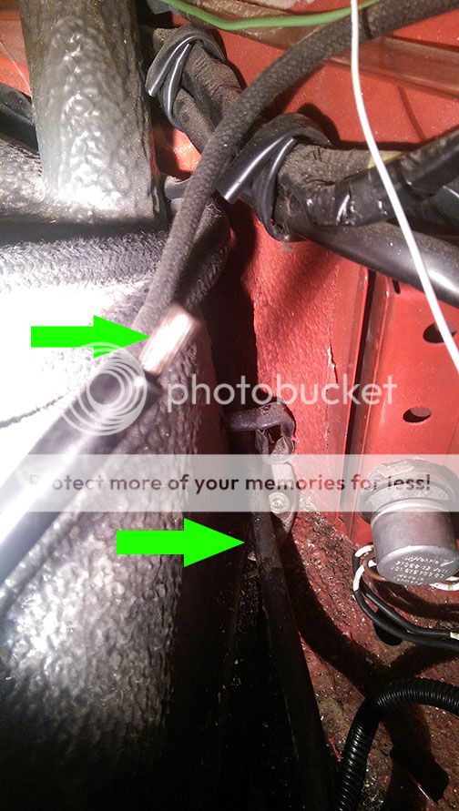

Here is a shot of where the wire enters the cab from the trunk..just behind the gas tank.

Yes for some odd reason Porsche pick black for it. Put a + lead of a voltmeter on it and the black to ground and it should read 12Volts
I slip some red heat shrink on it.
