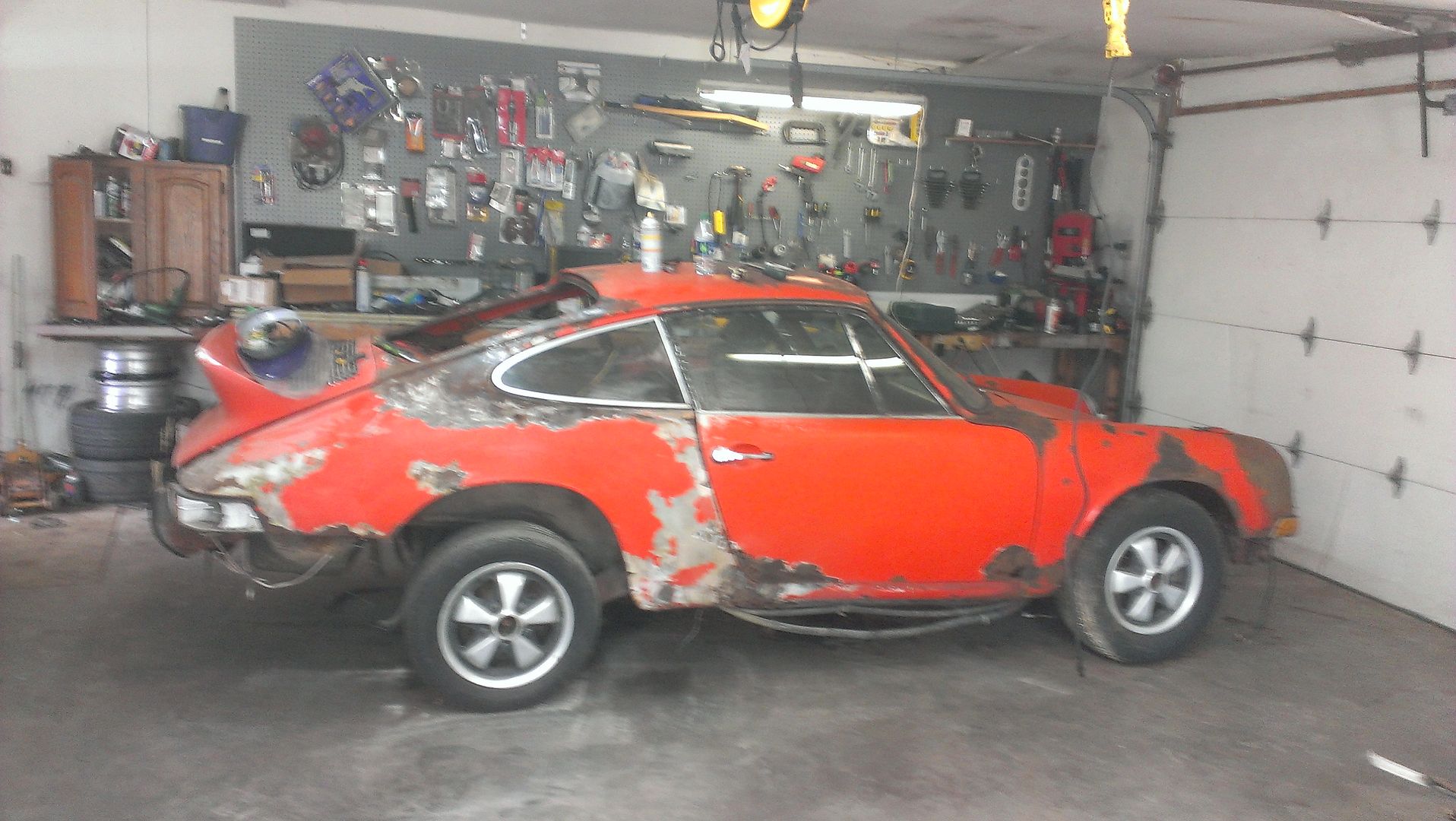

Jarrod,
I hope you are, or know, a very good fabricator/welder. That's a lot of work there.

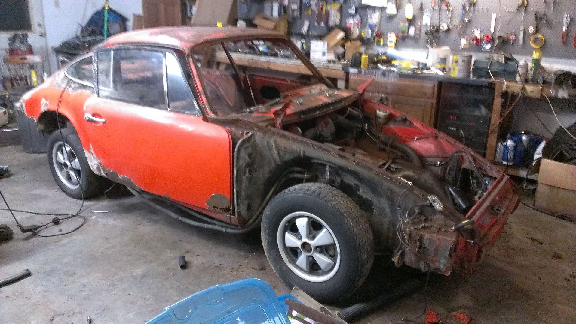

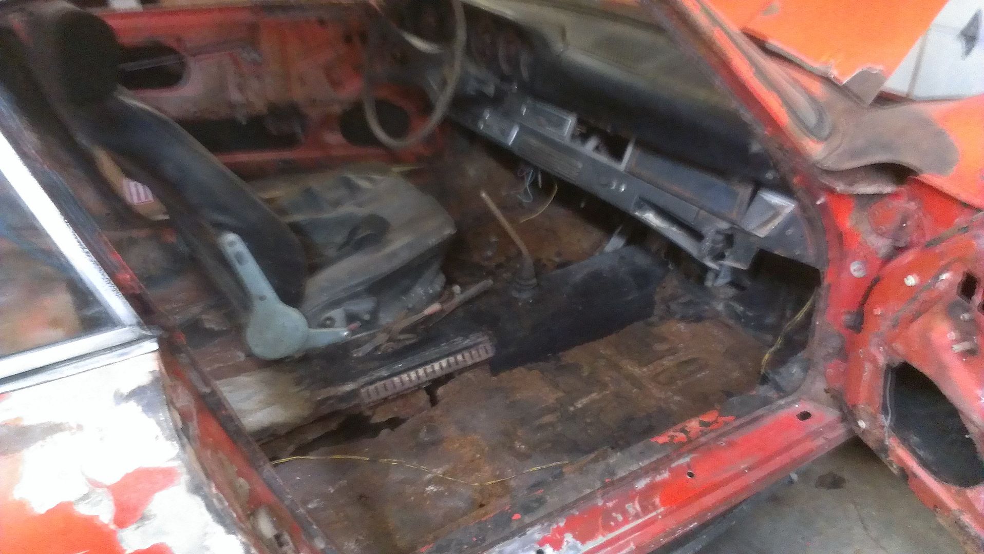

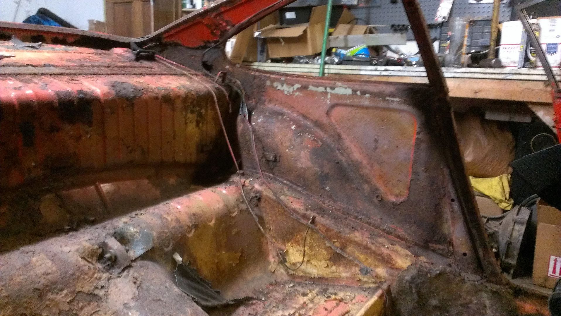

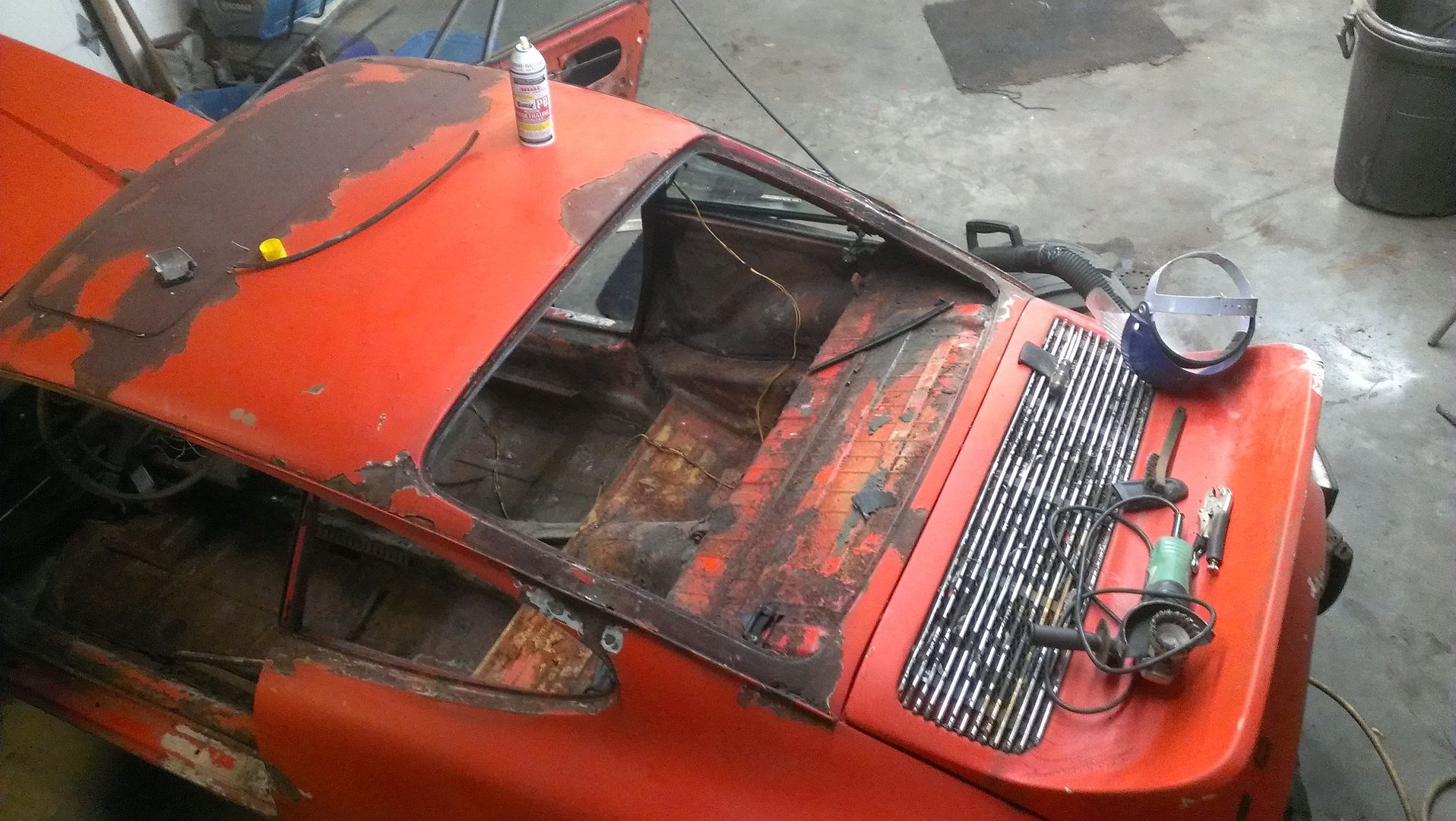

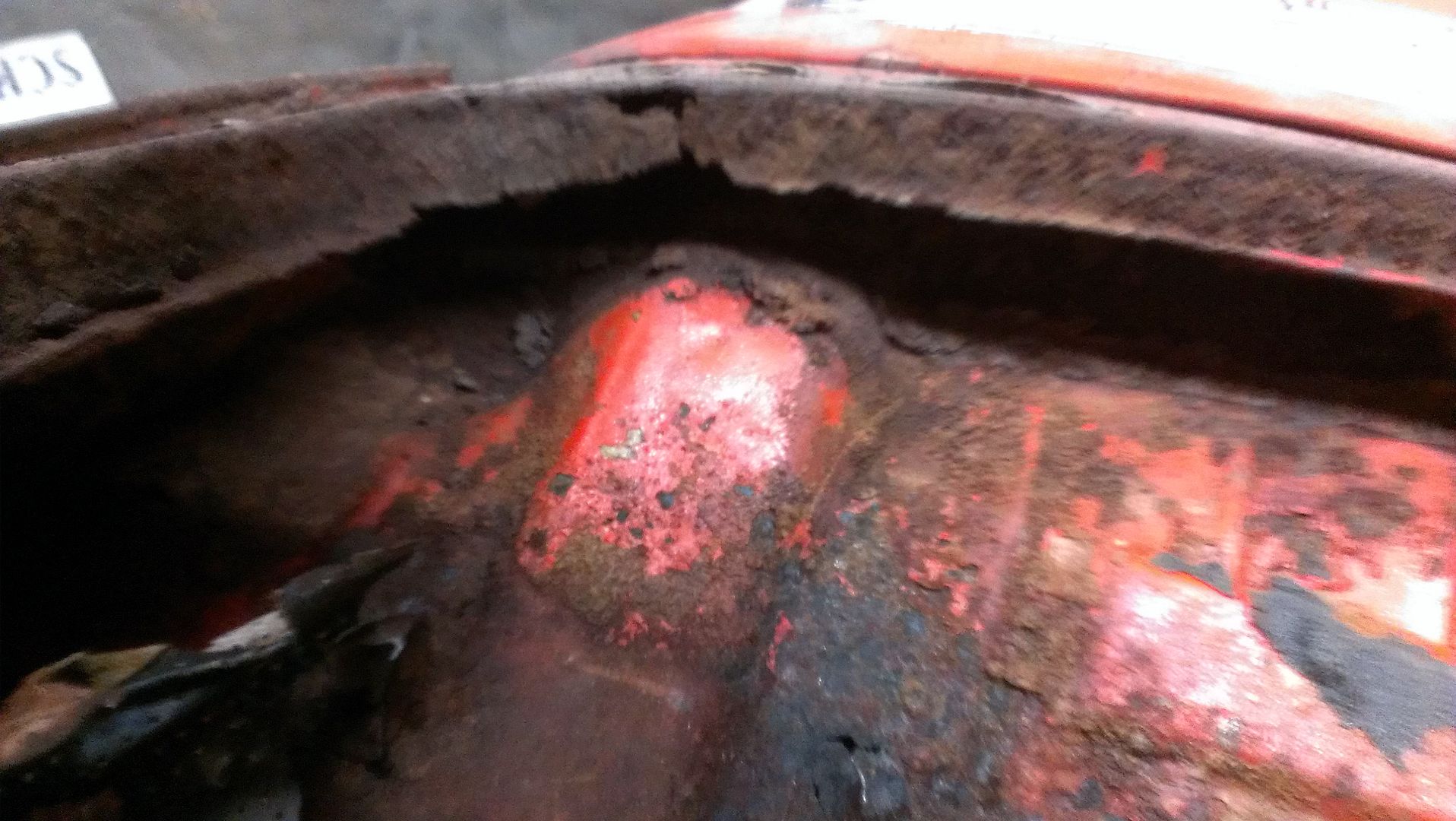

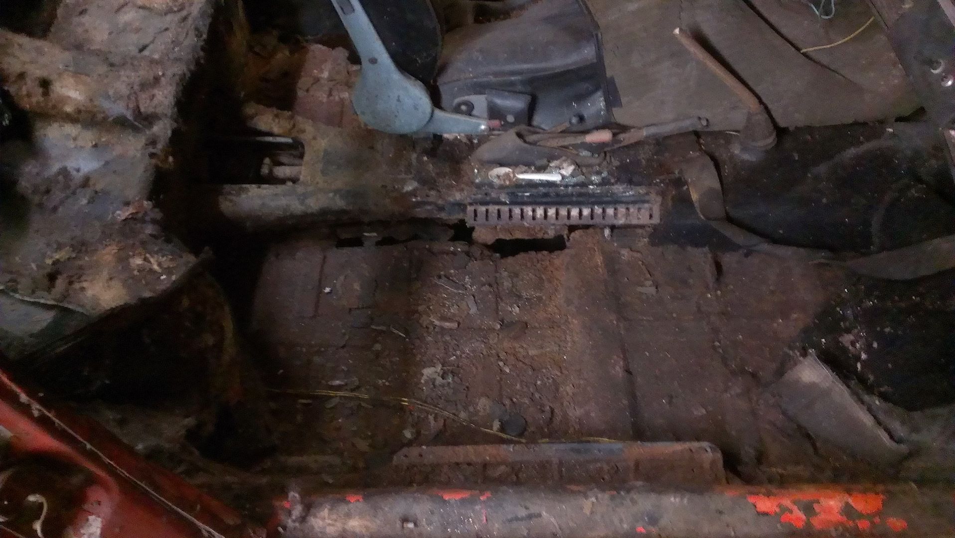

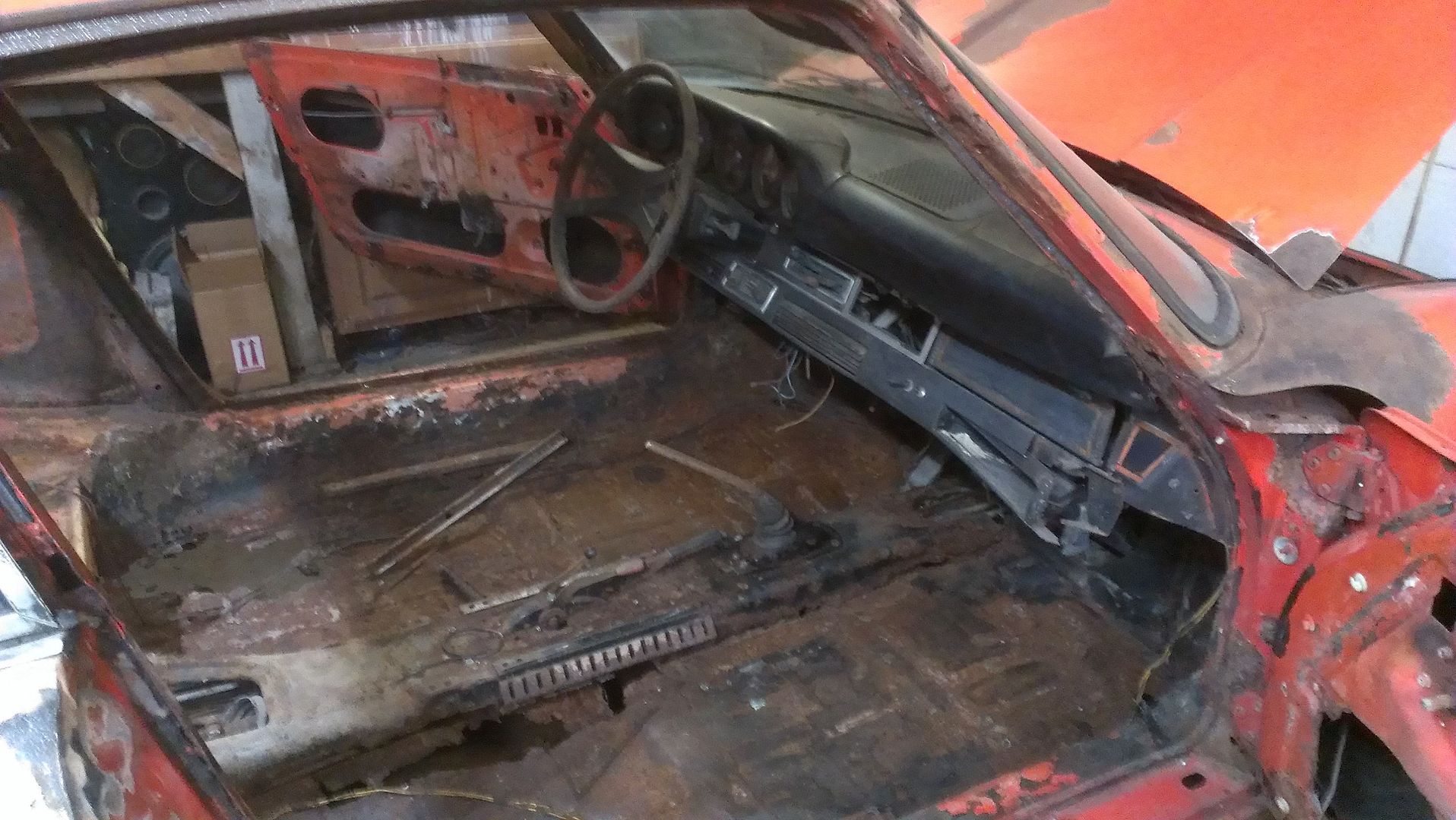

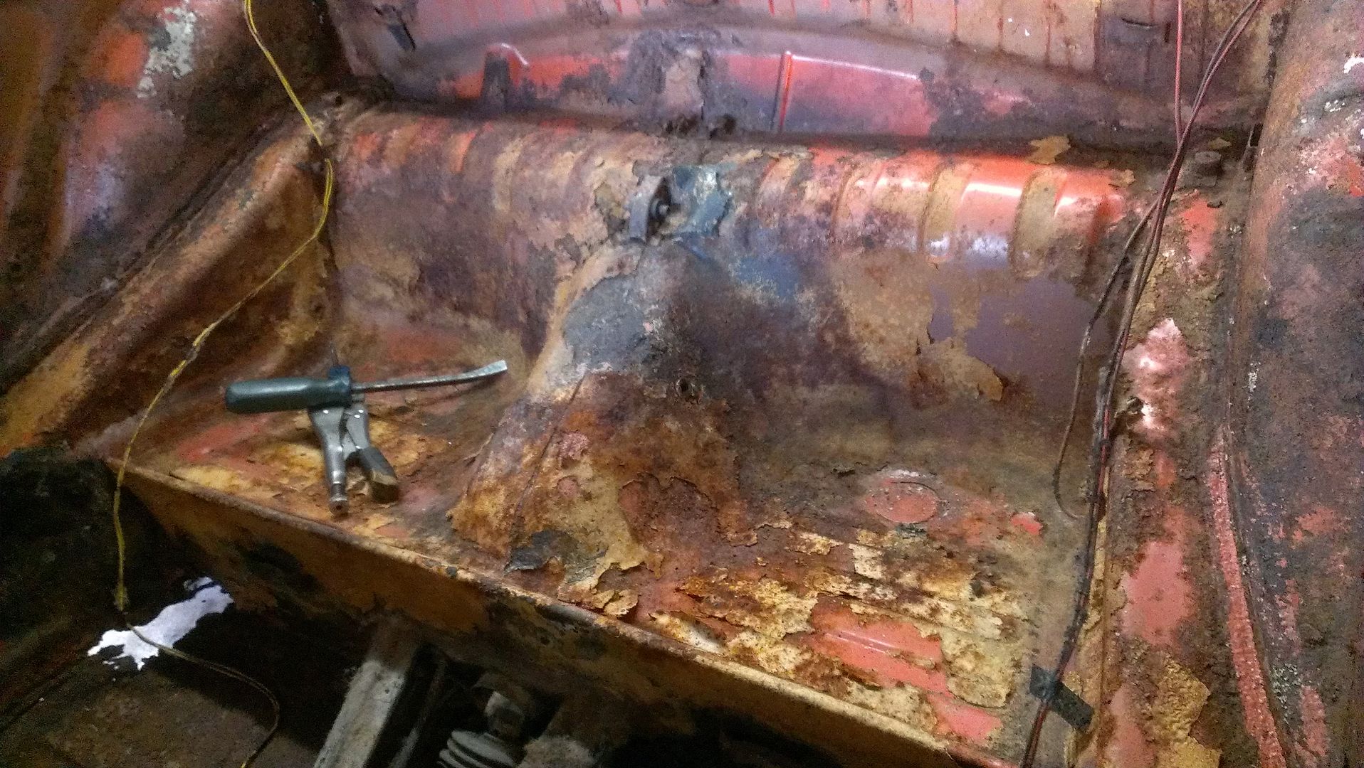

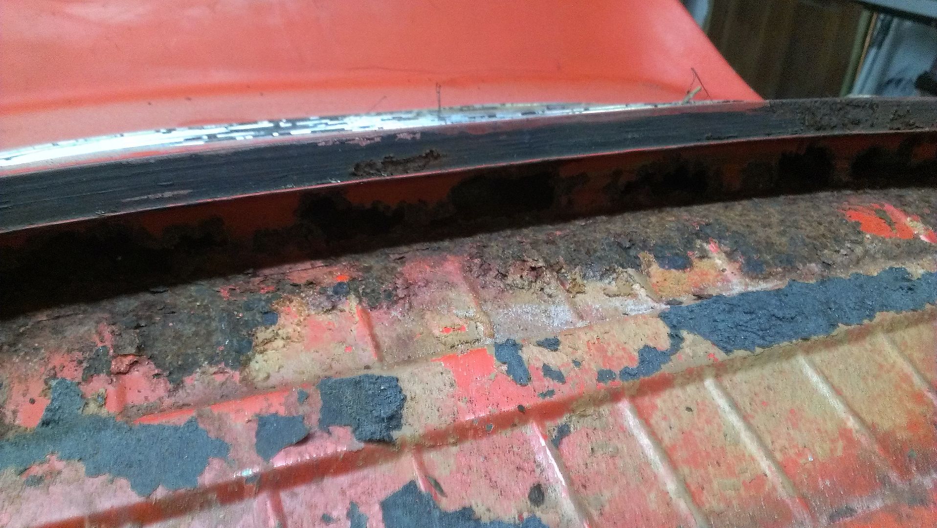

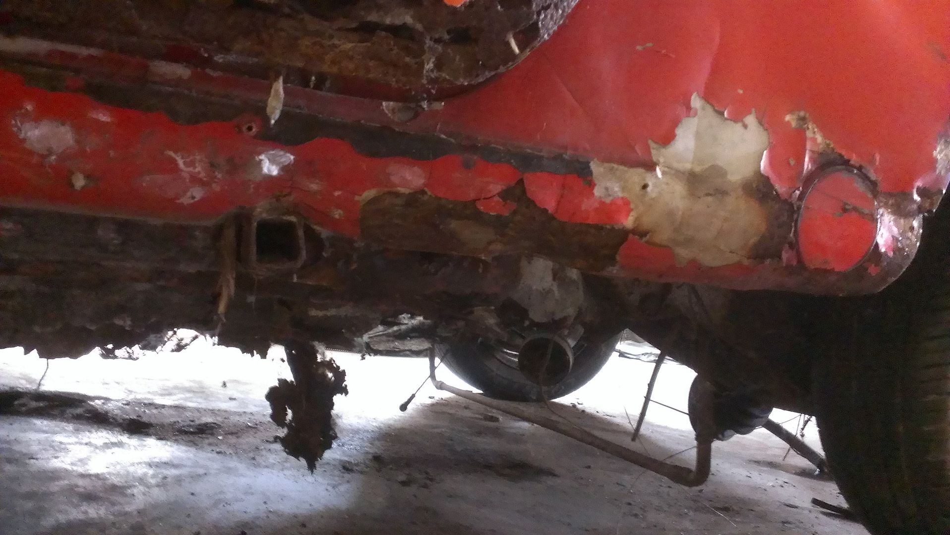

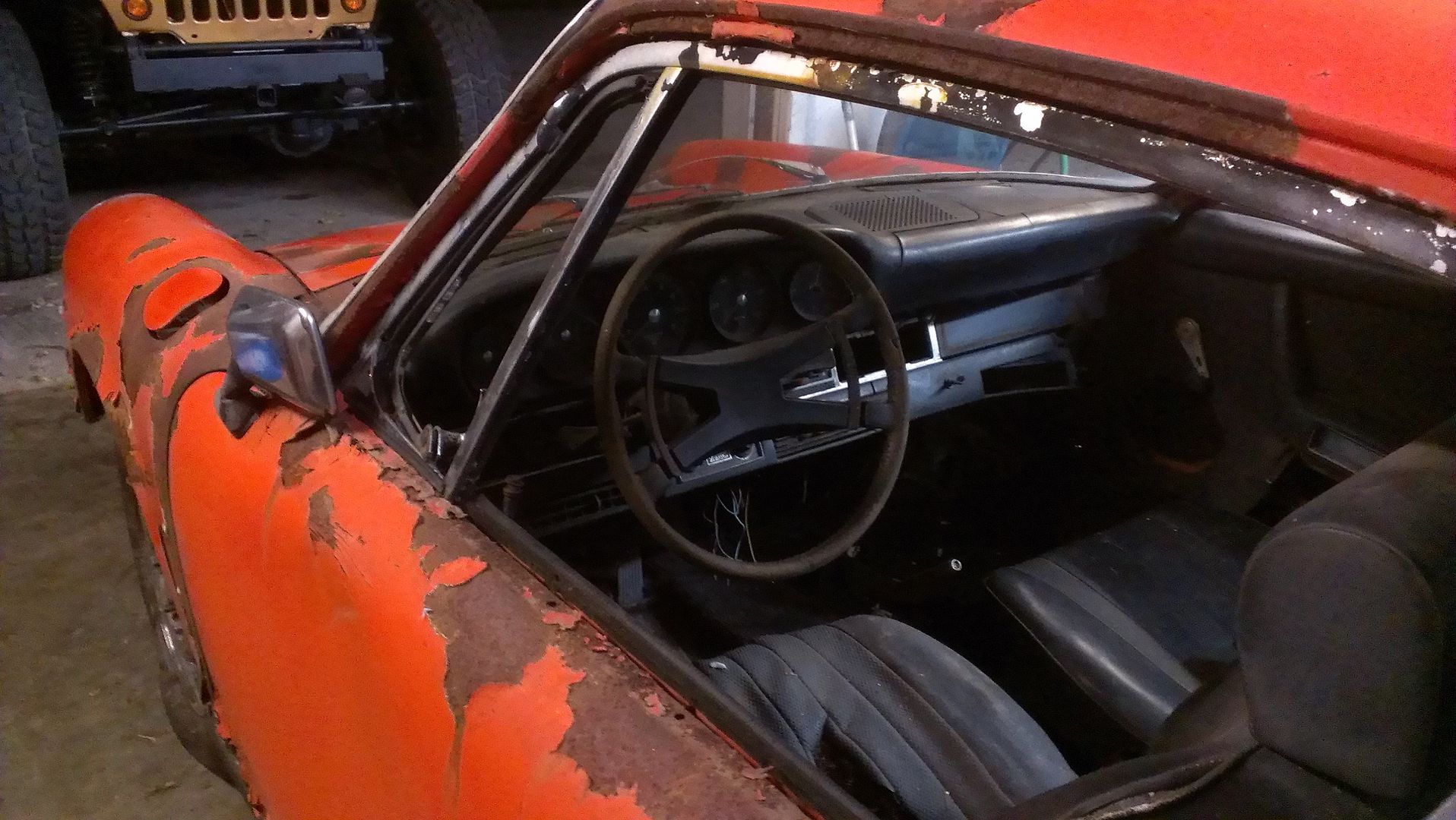

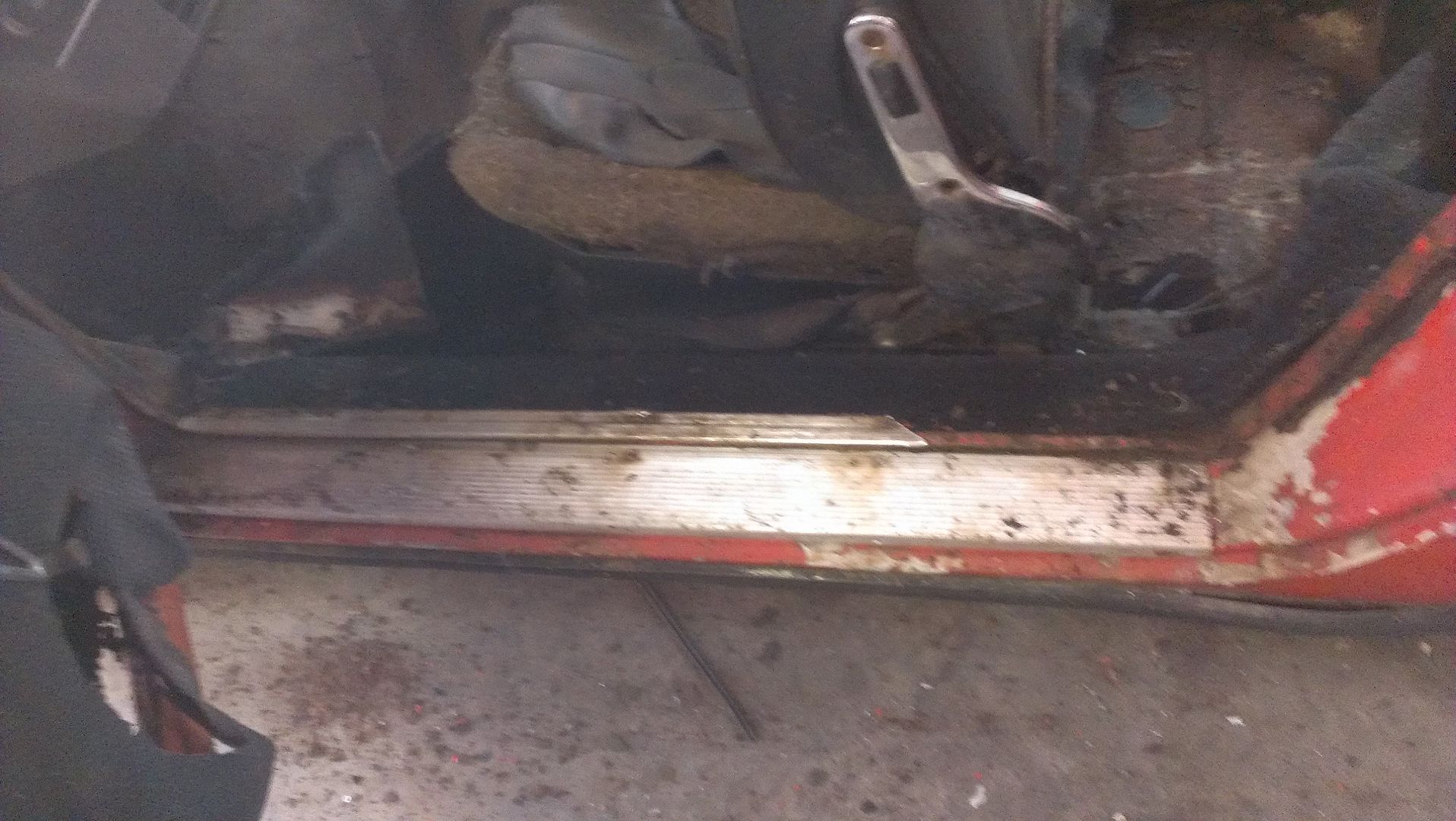

Not much Progress has been made, still striping it down.
I removed the passenger seat its in rather good condition.

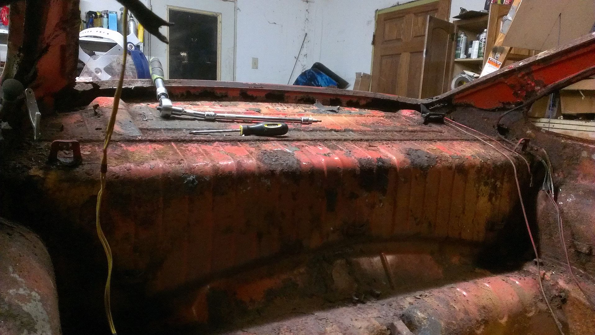

Rear seat pans look good.
The rocker panels are surprisingly solid.

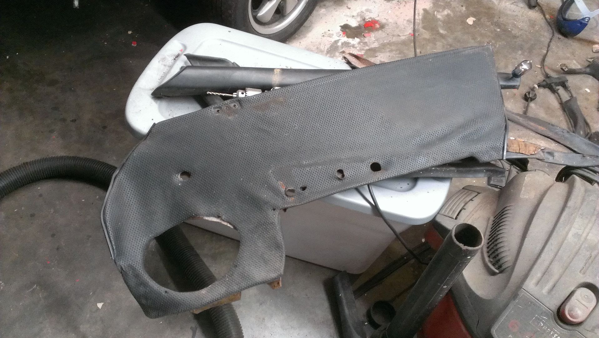

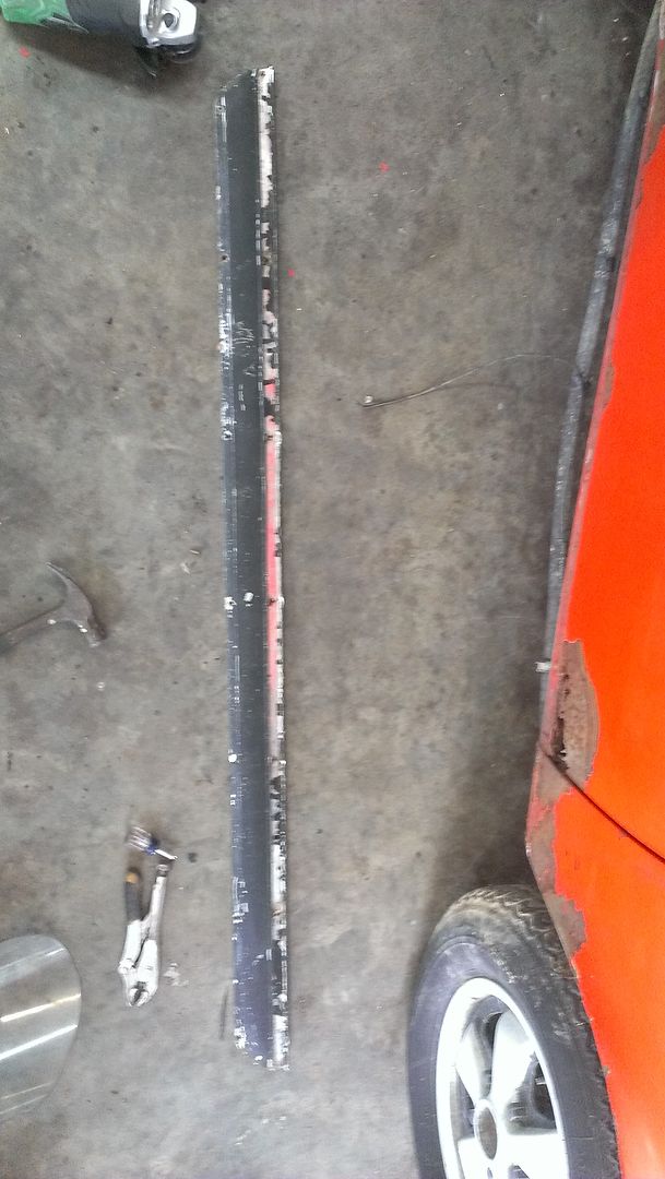

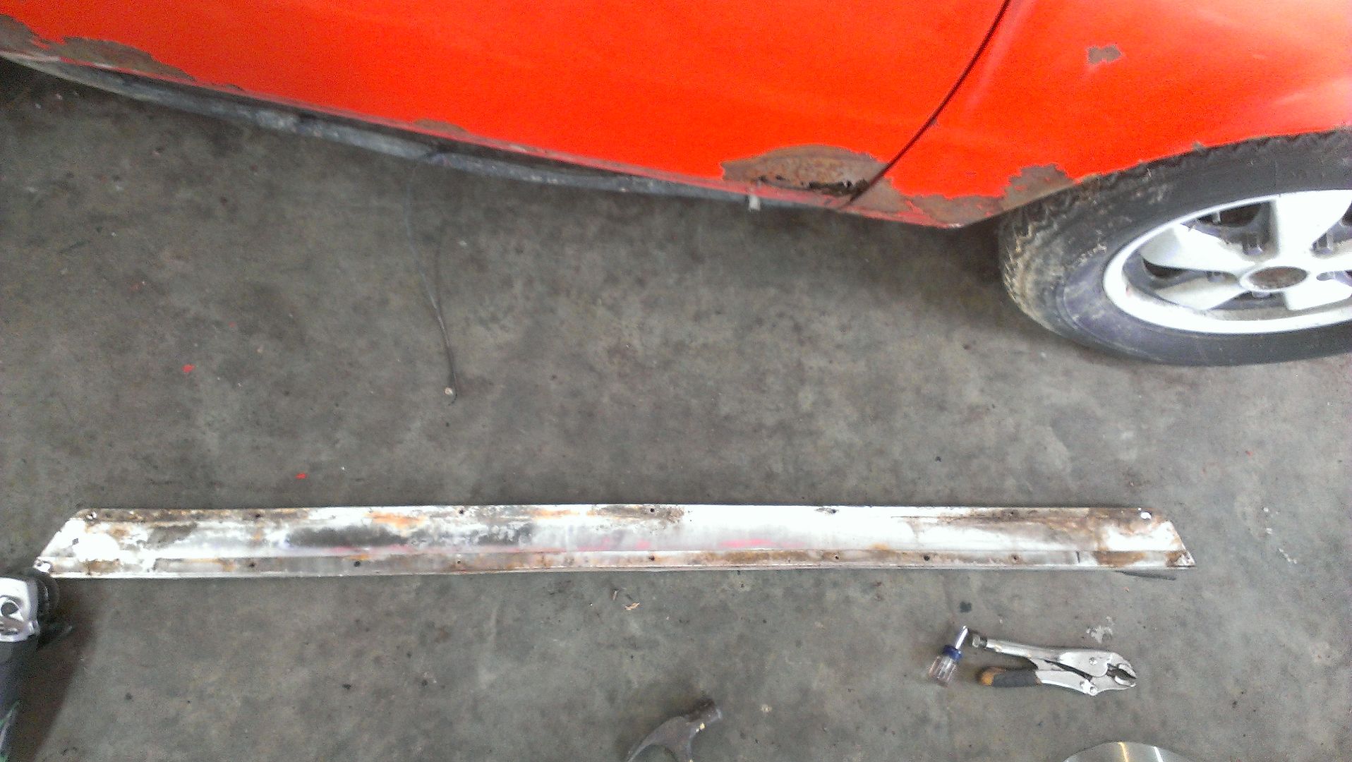

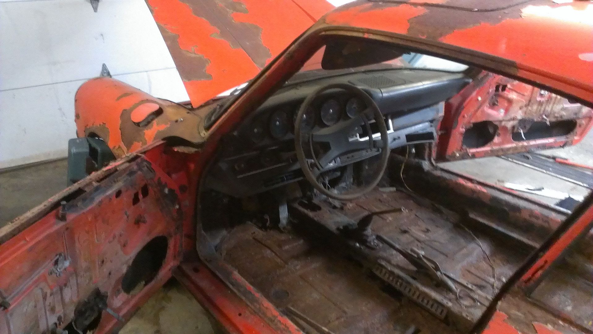

Removing the rocker trim
I maybe able to reuse the fabric and make a new door card? Also anyone know what I can find a reproduction of this material?

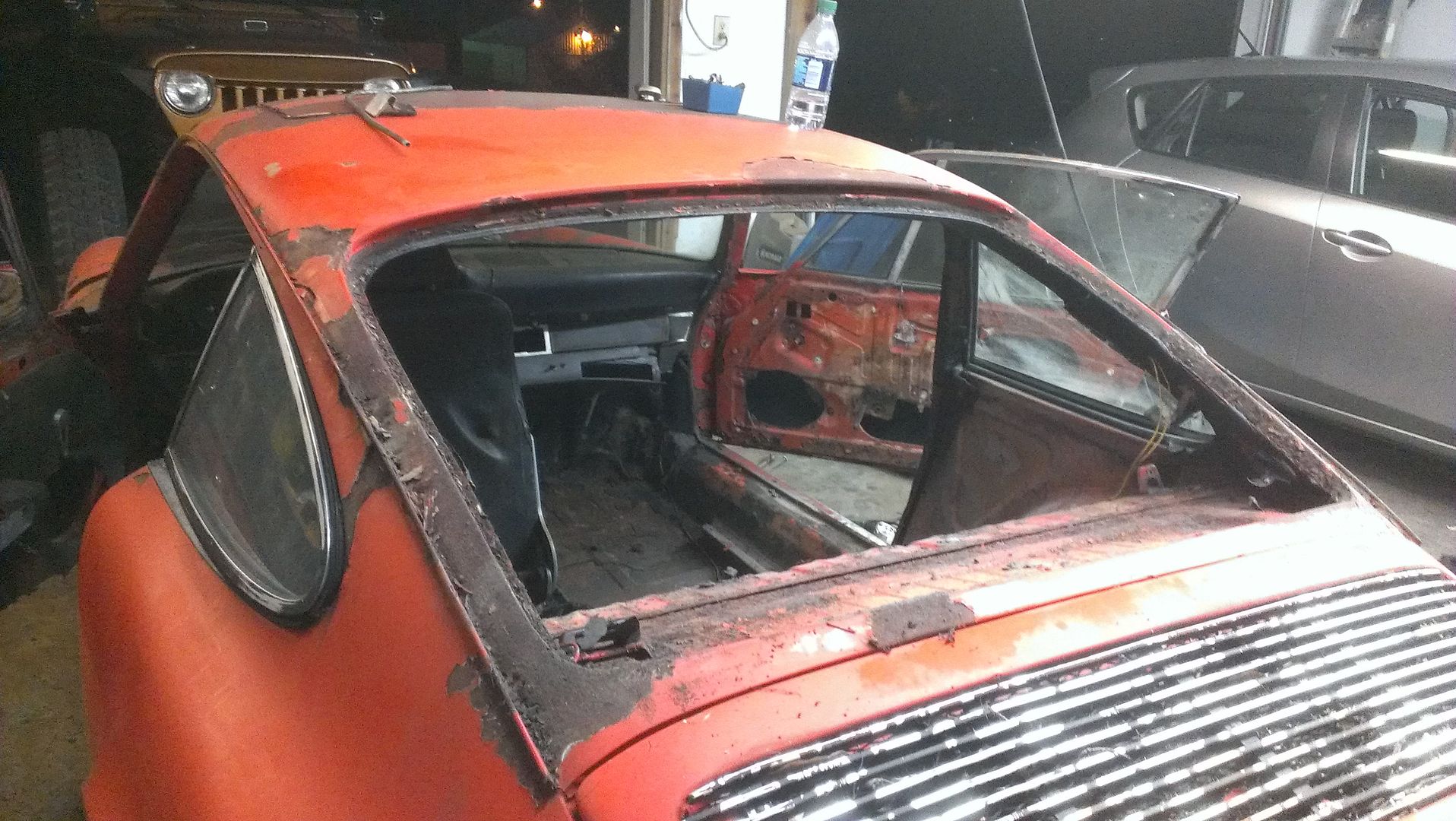

Glass removal has been supper easy, well other then the rear passenger wing glass, but more on that later.

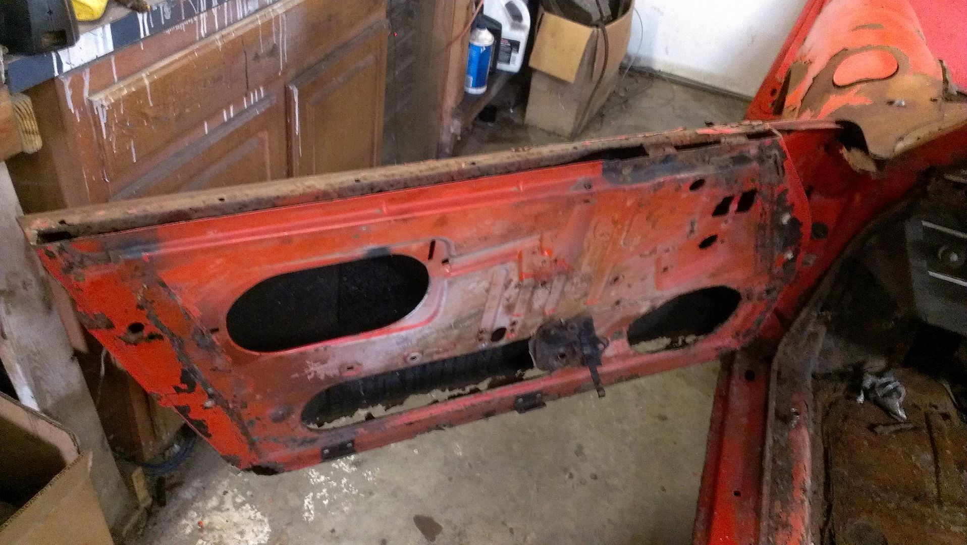

Started driver door break down I will need to find a new wing vent glass.
Moving on to whats left of the driver seat.

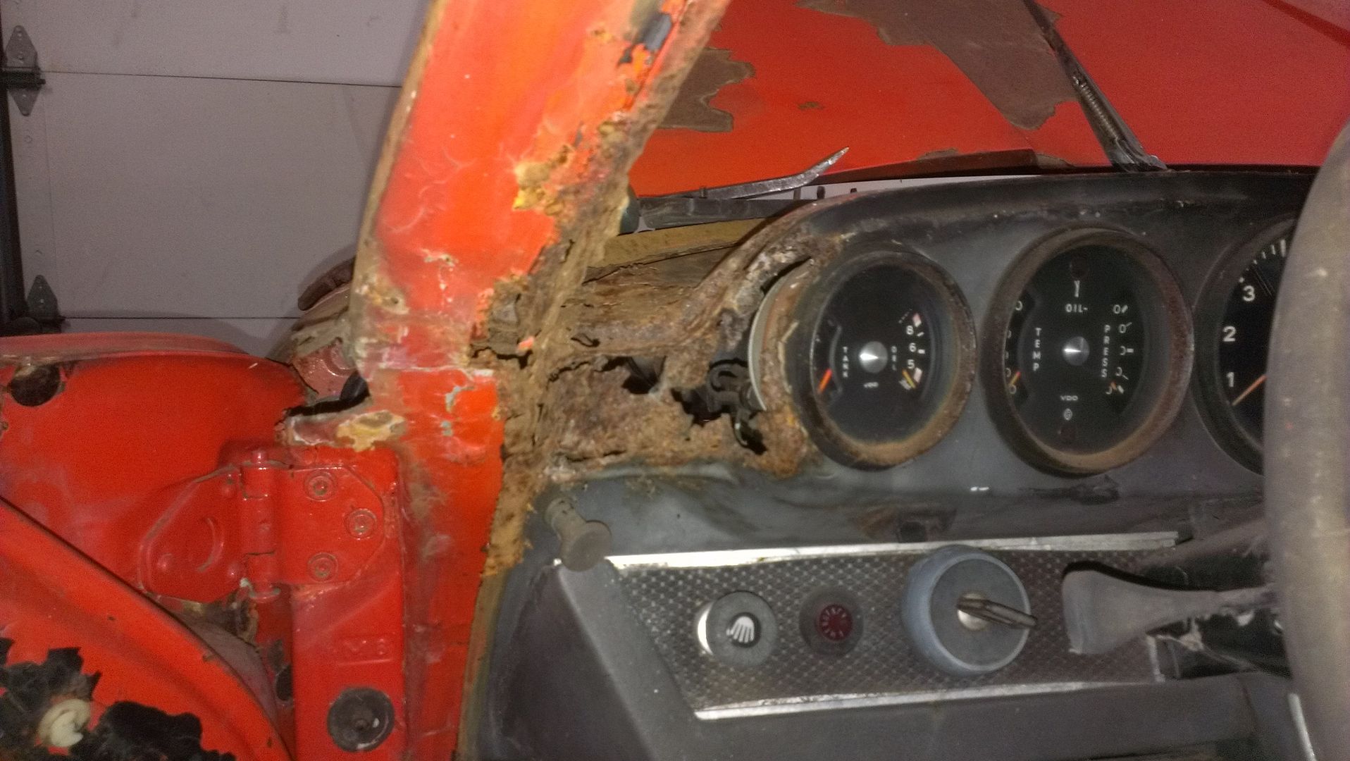

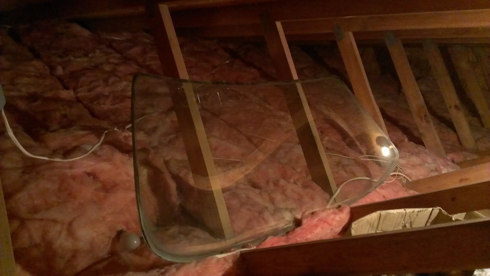

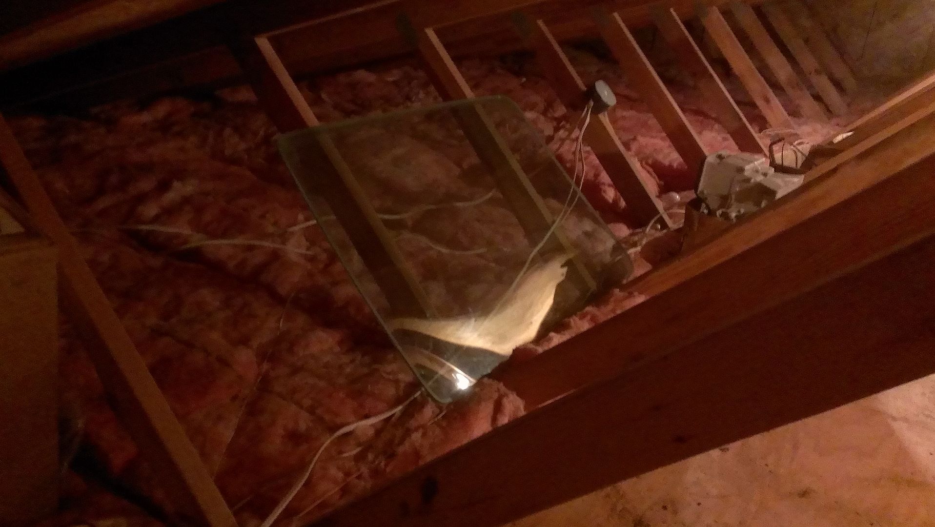

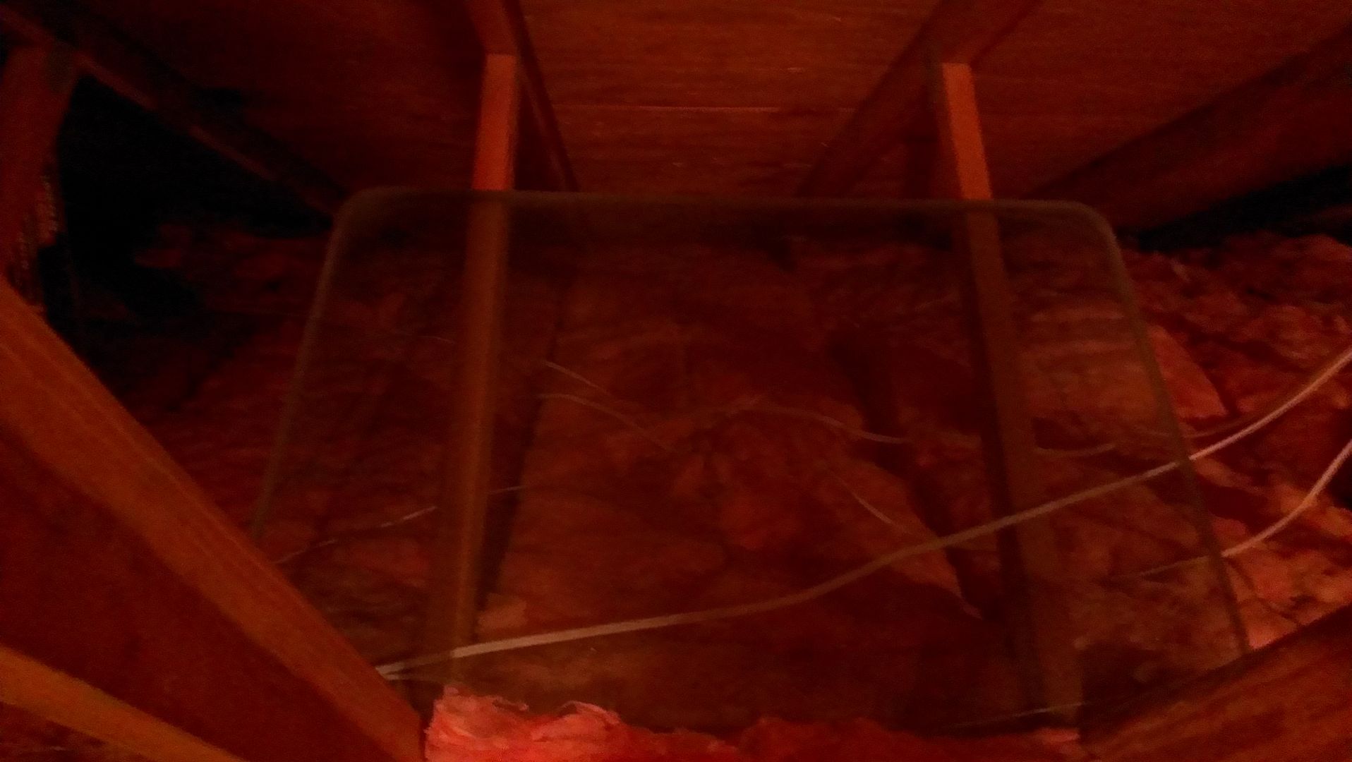

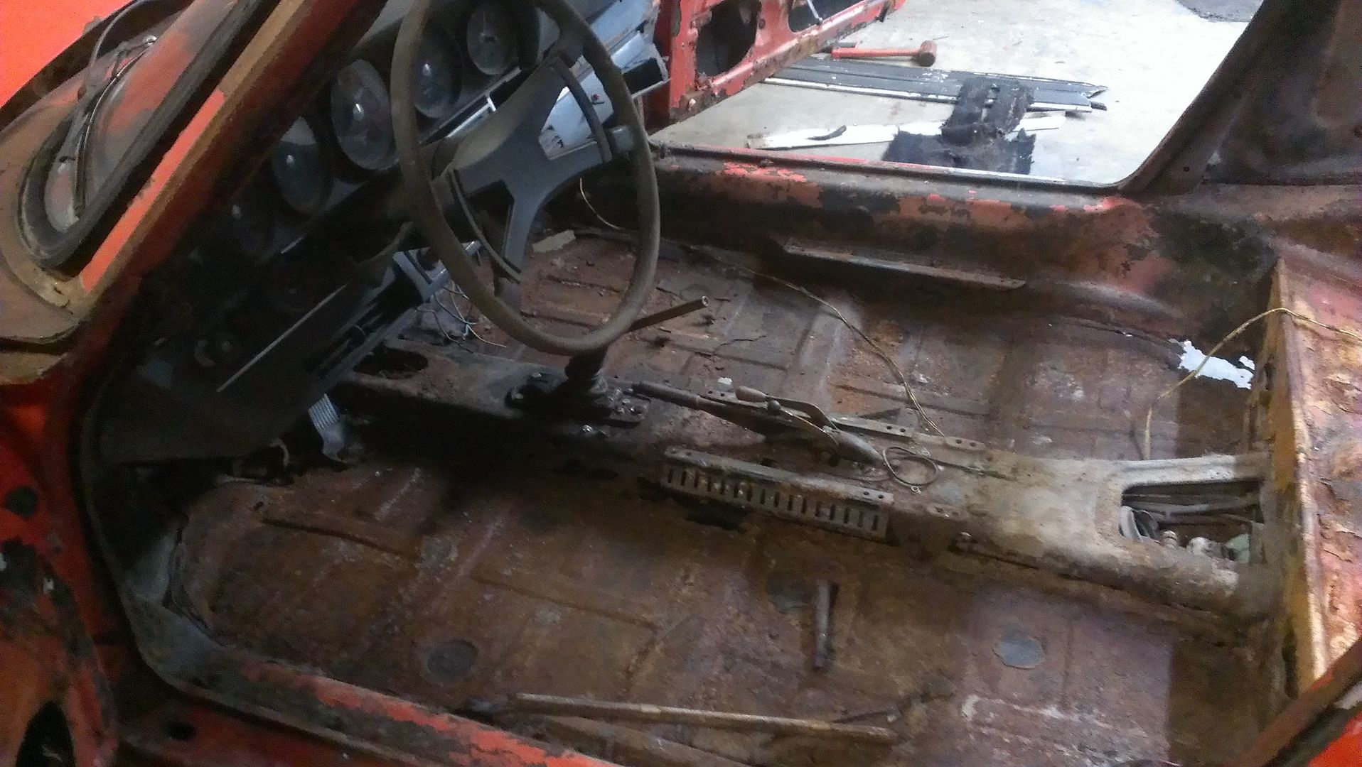

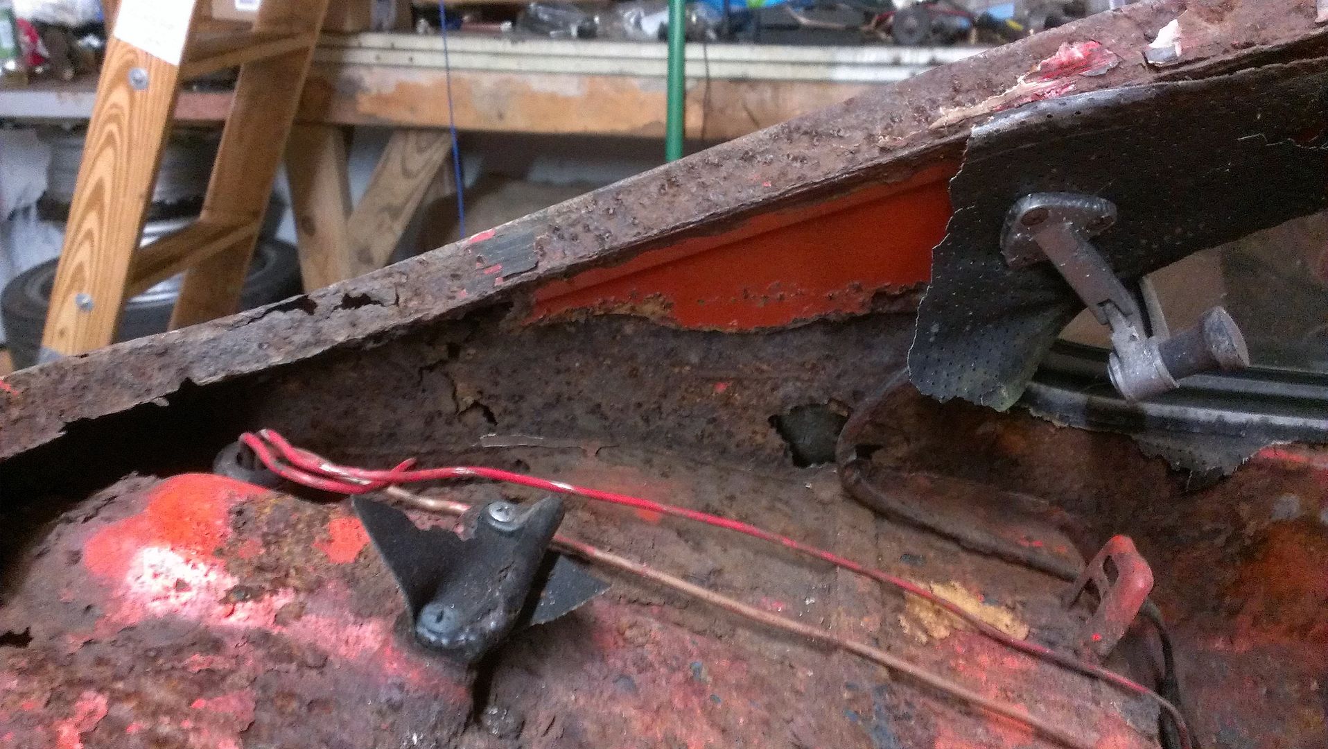

I found the glove box trim plate under the driver seat.

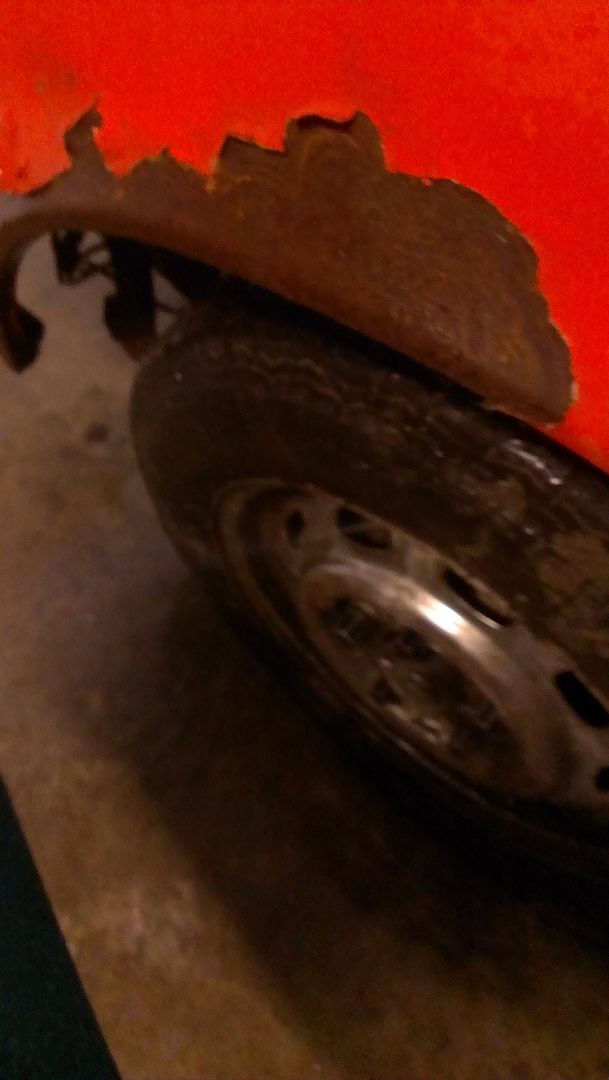

The amount of rust I have removed from this car is astonishing.
I also aired up the driver front tire and it sprung a leak, there must have been a gallon of water in there.

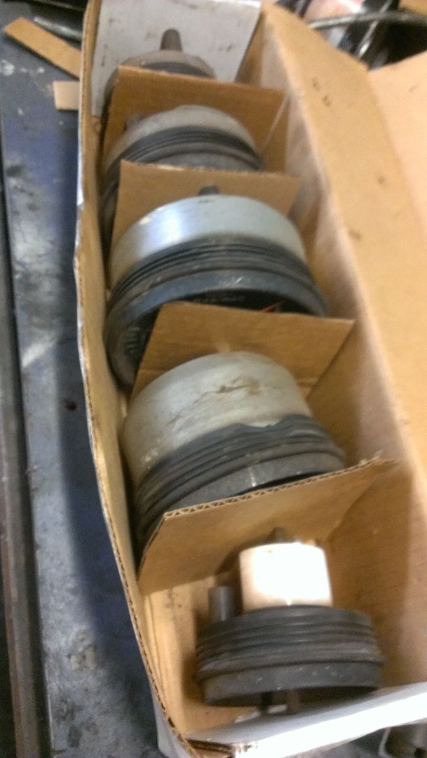

Is it safe to store glass like this?

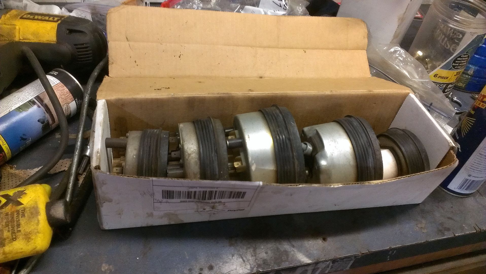

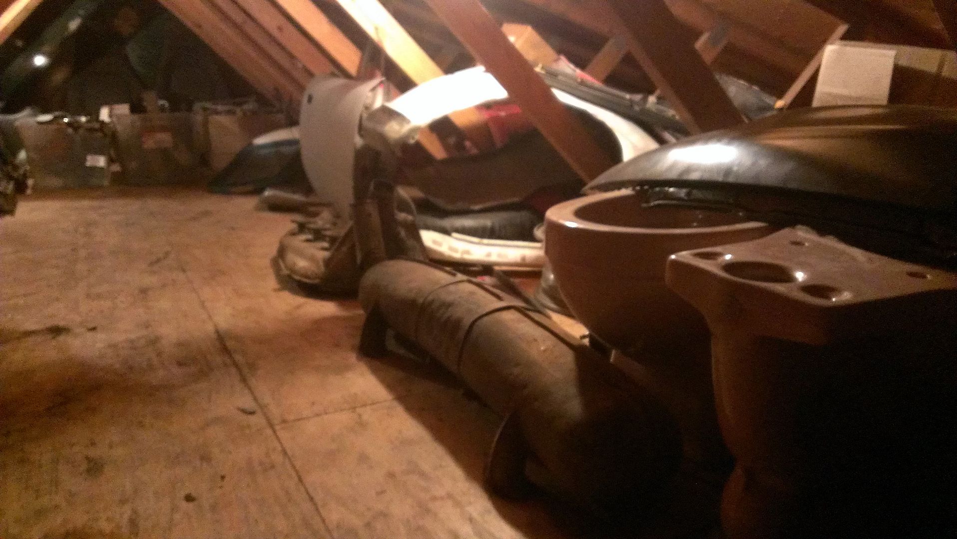

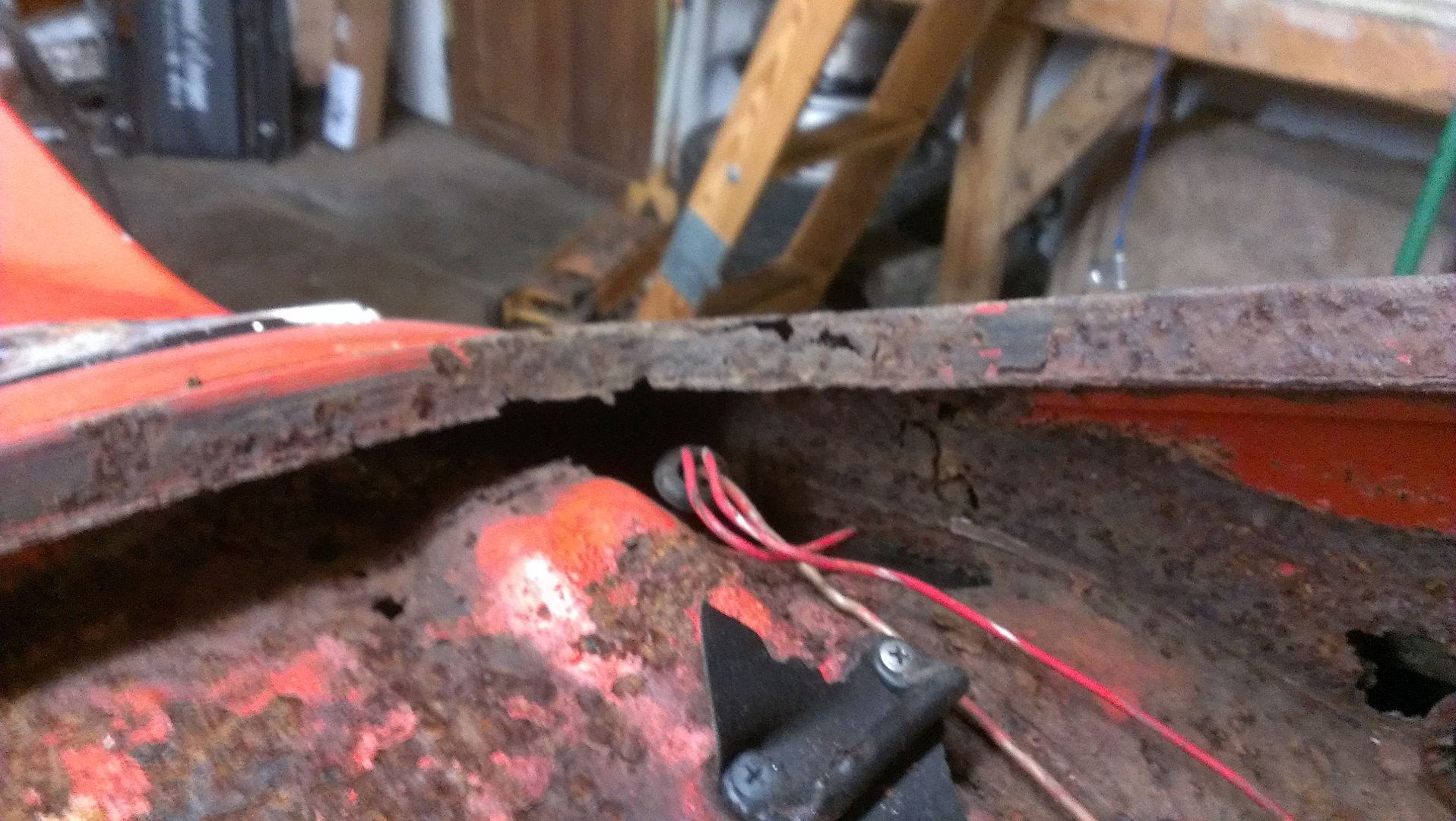

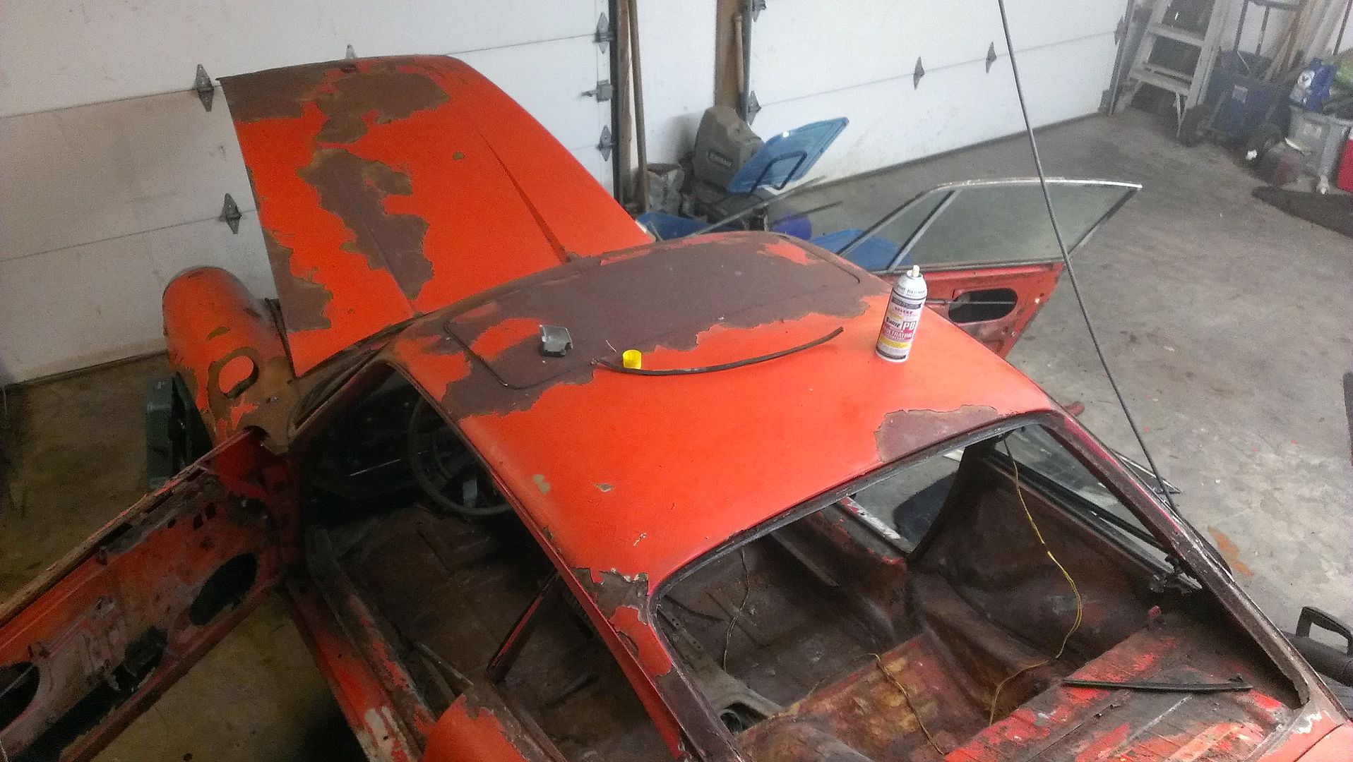

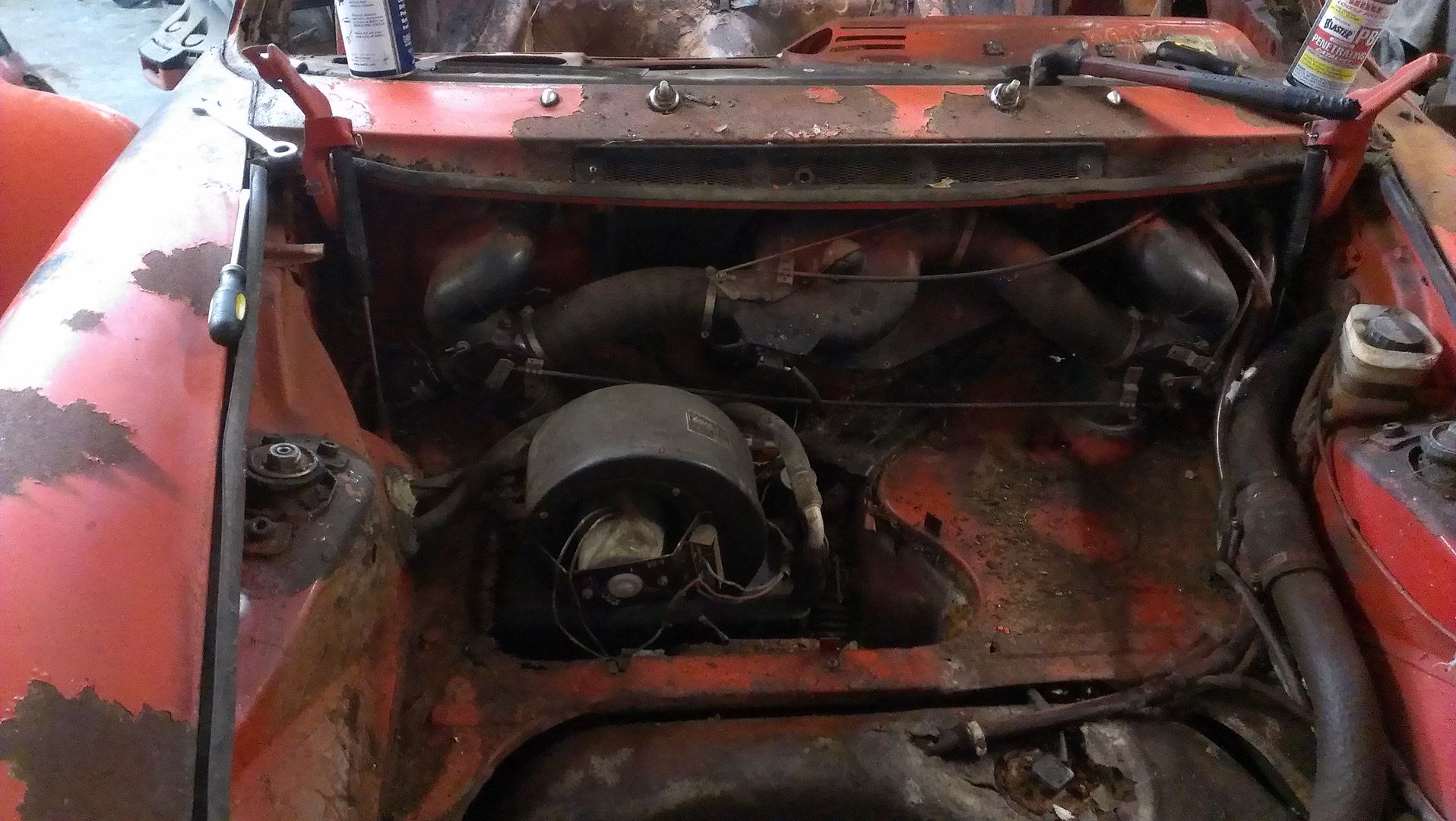

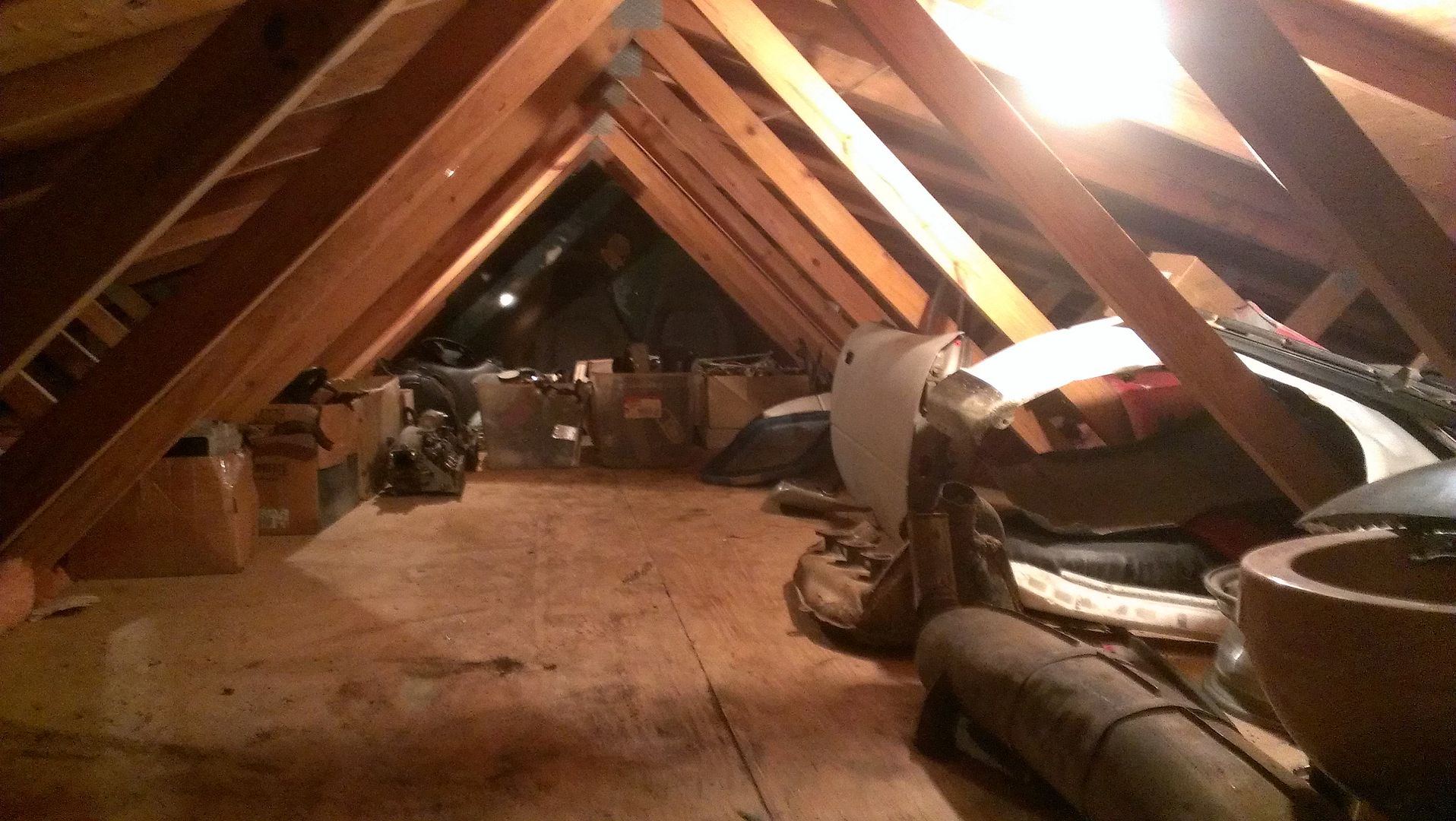

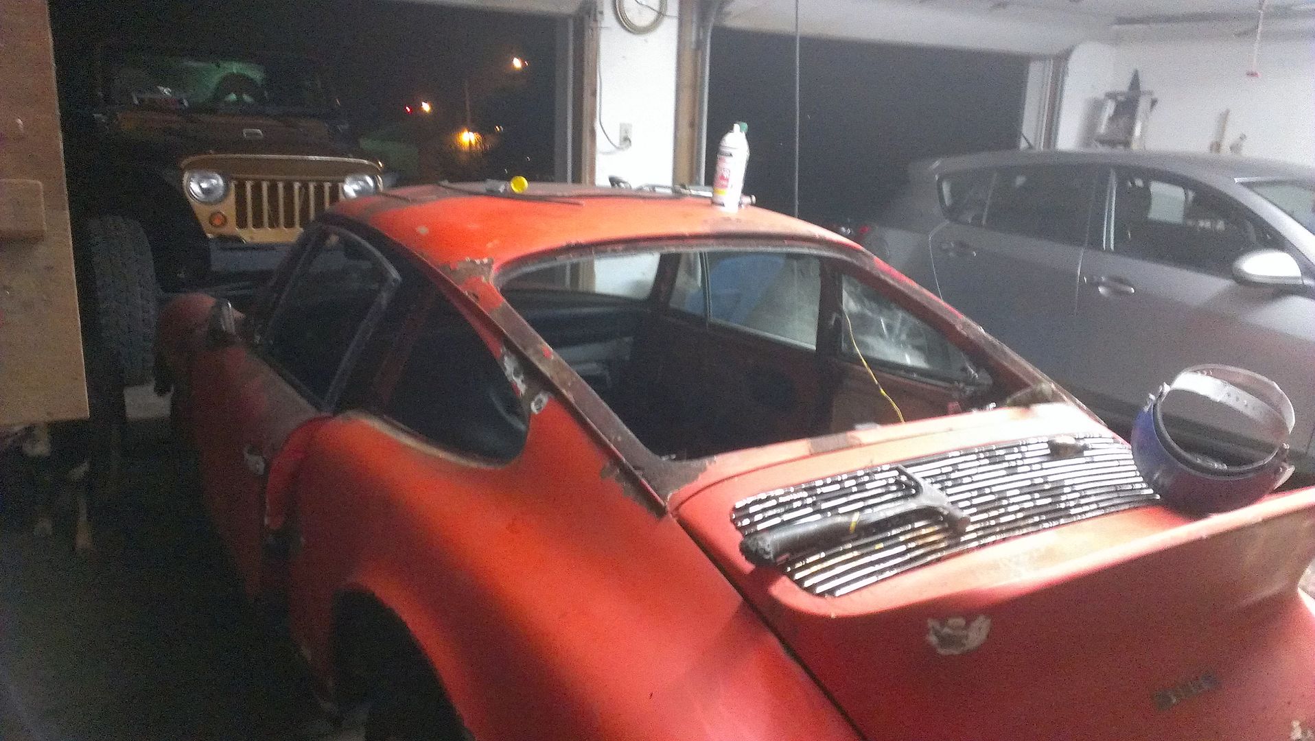

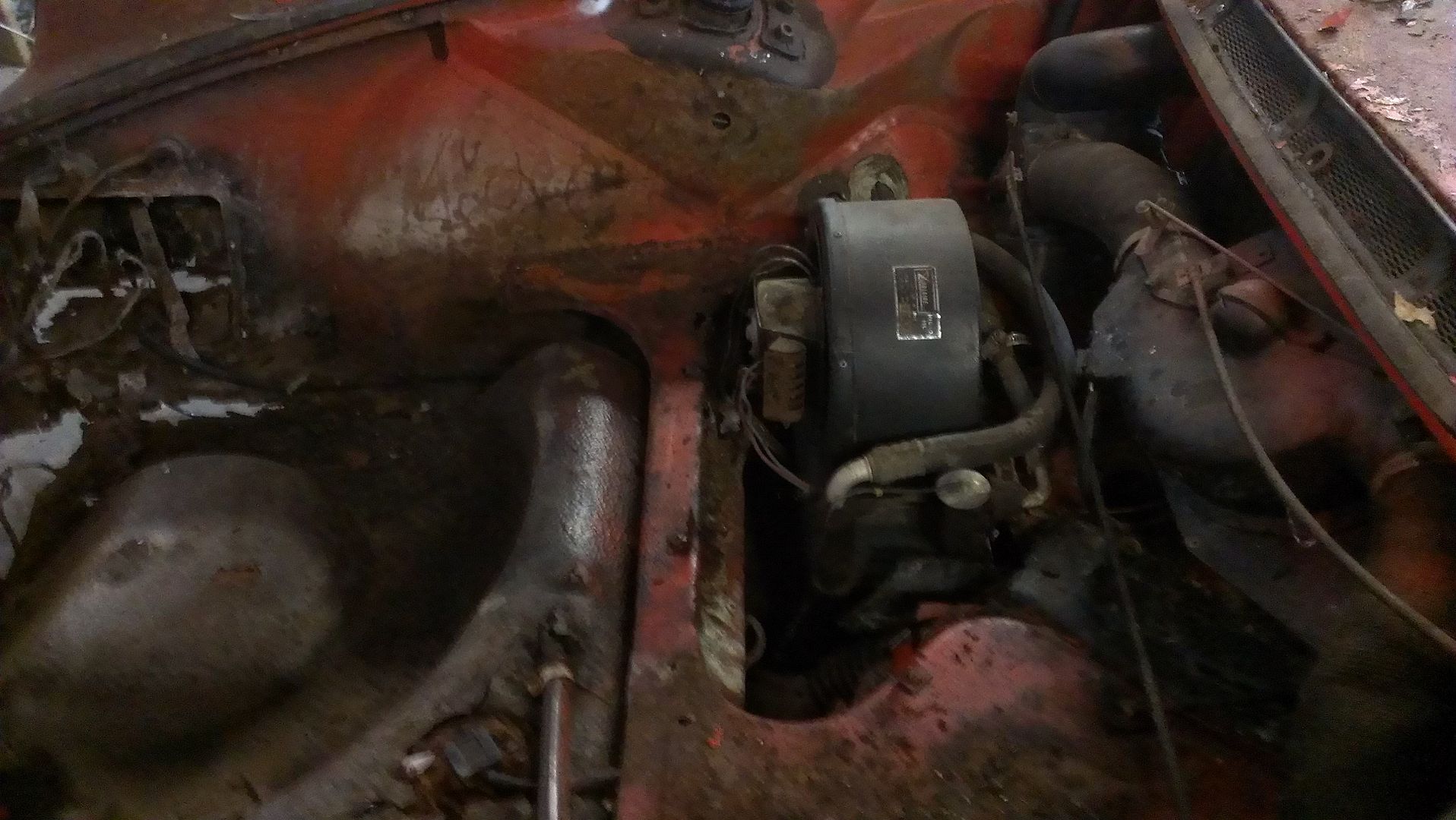

Made some room for more parts.

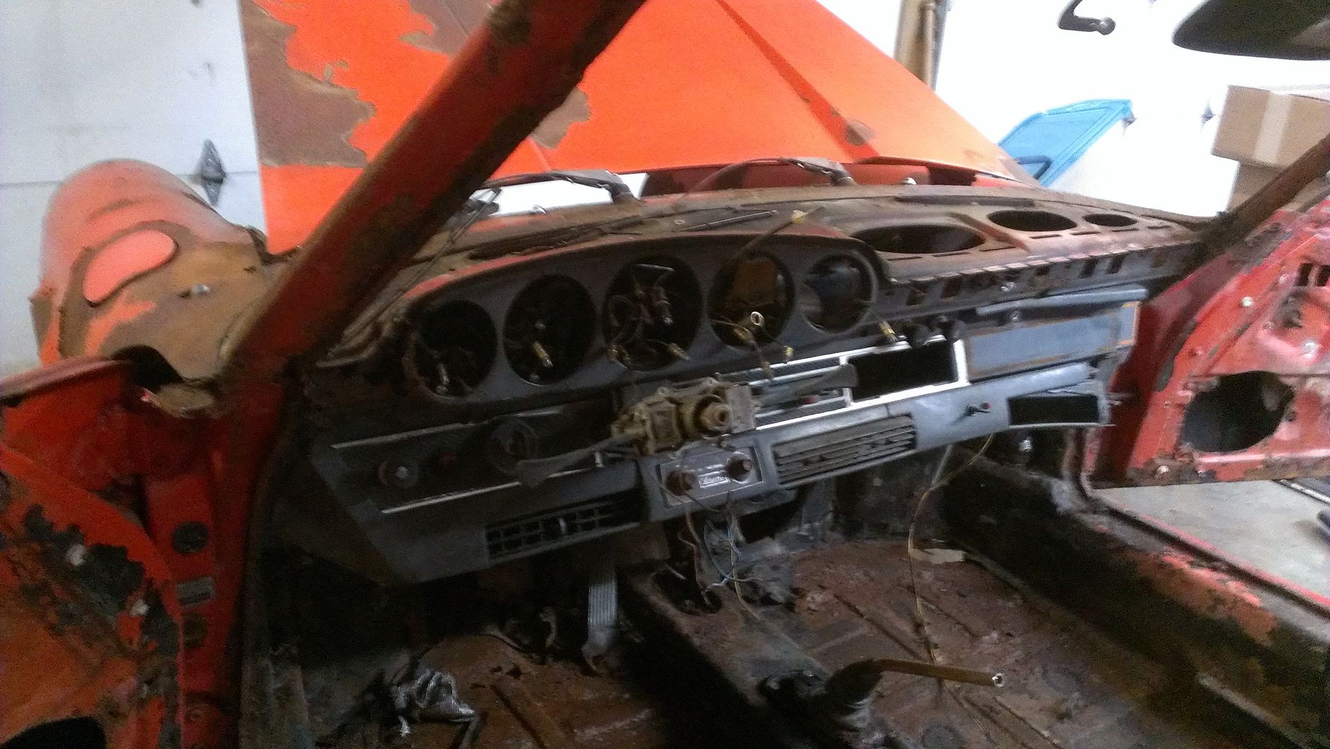

Removed the dash pad and found this.

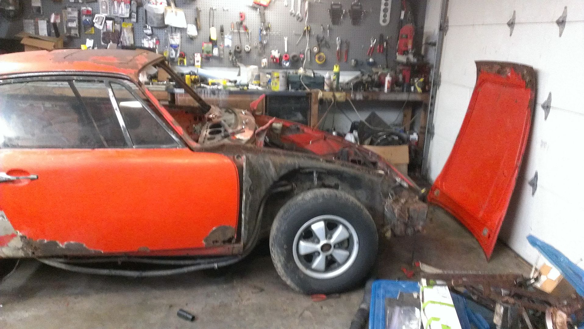

Removed the hood
Old 08-20-2014, 09:12 PM

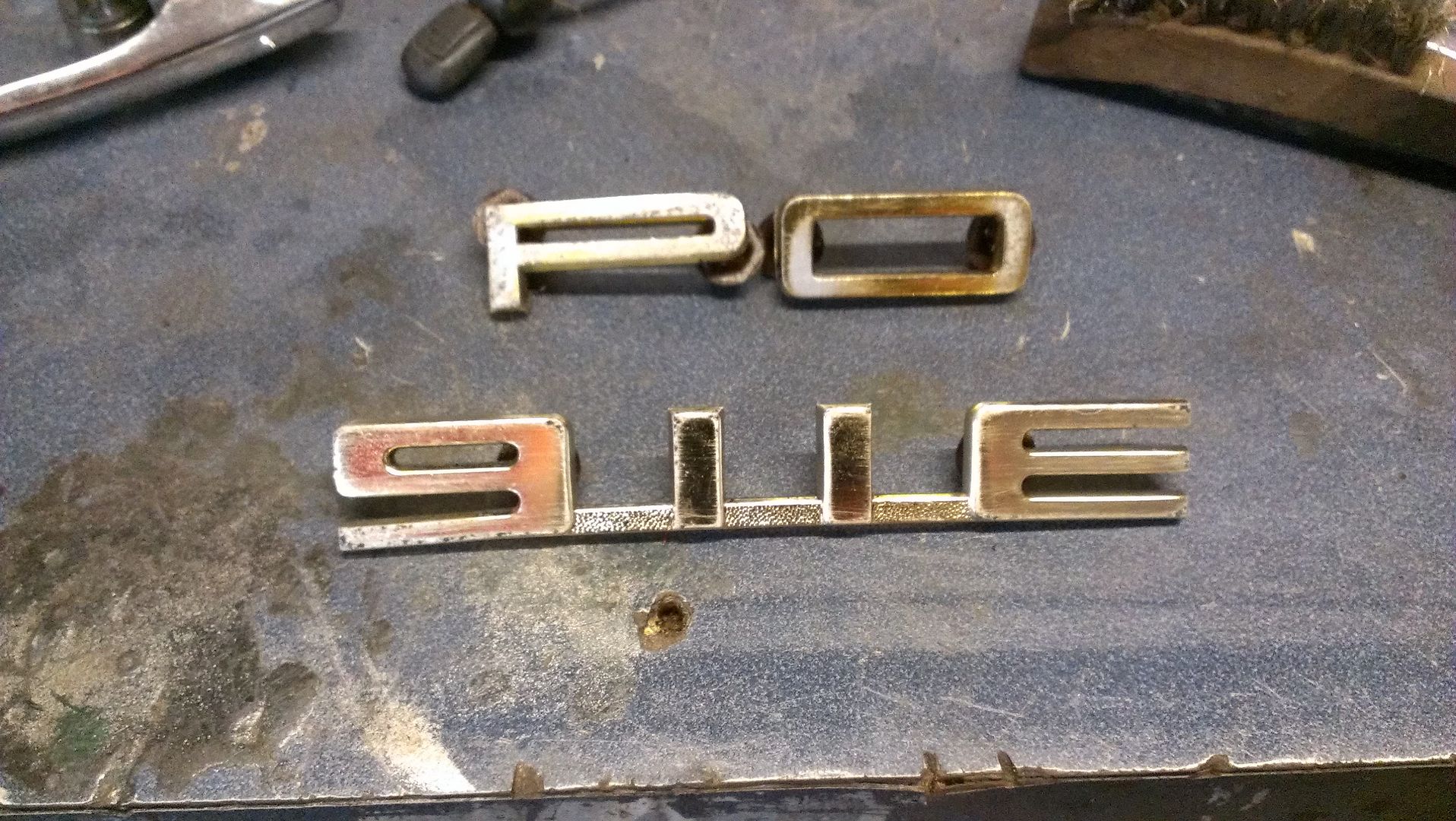

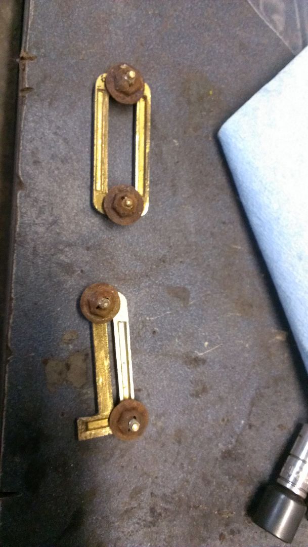

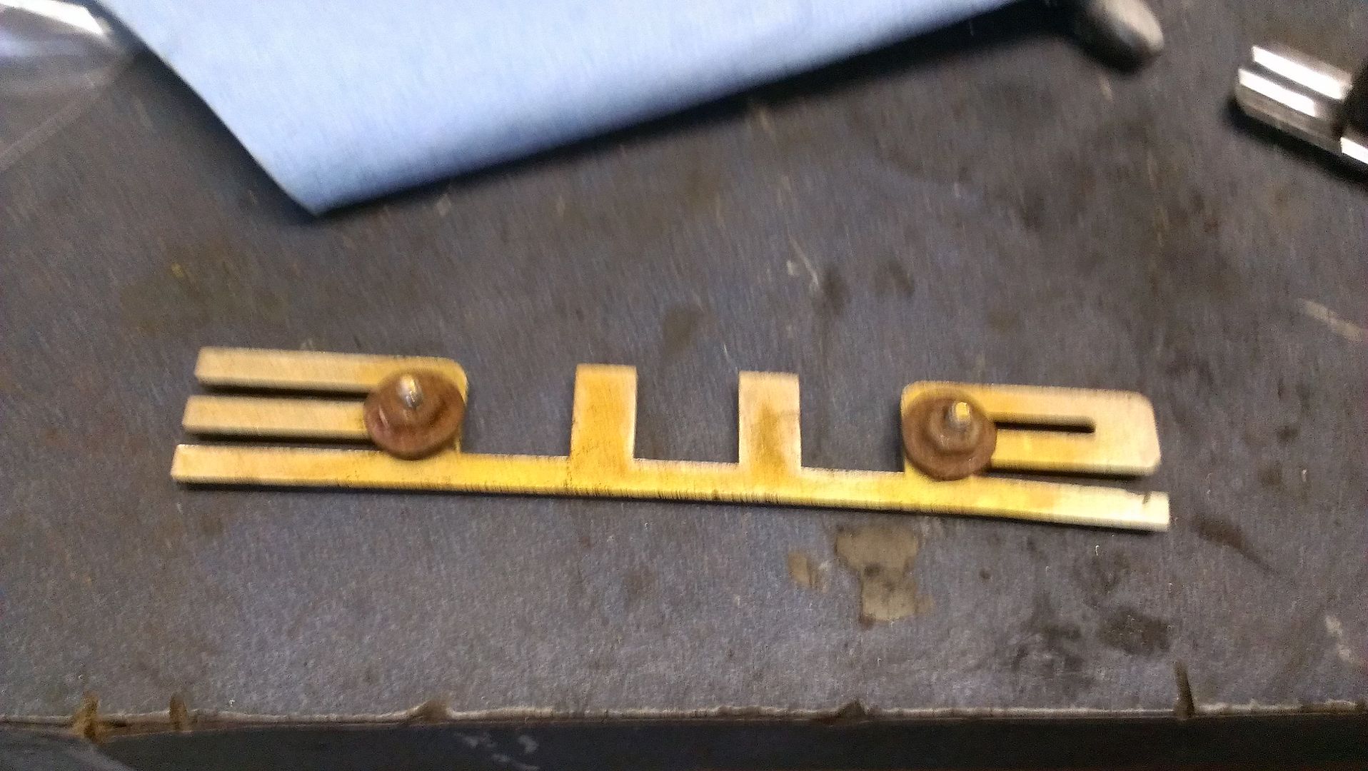

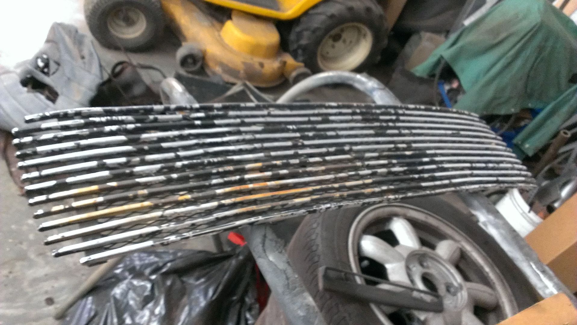

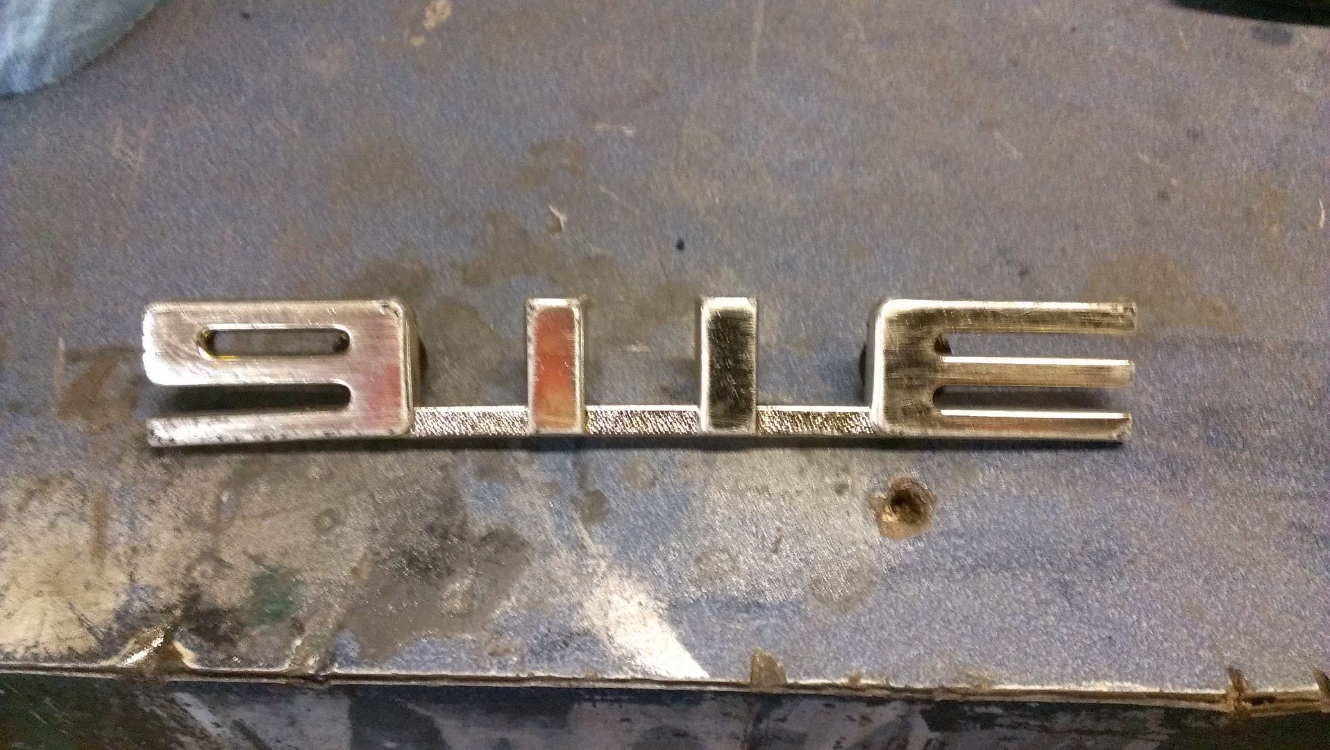

Finished the driver door. Now I need to buy the correct triple square bit set to remove the doors.

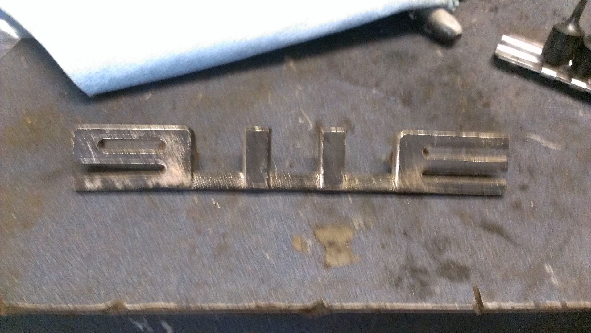

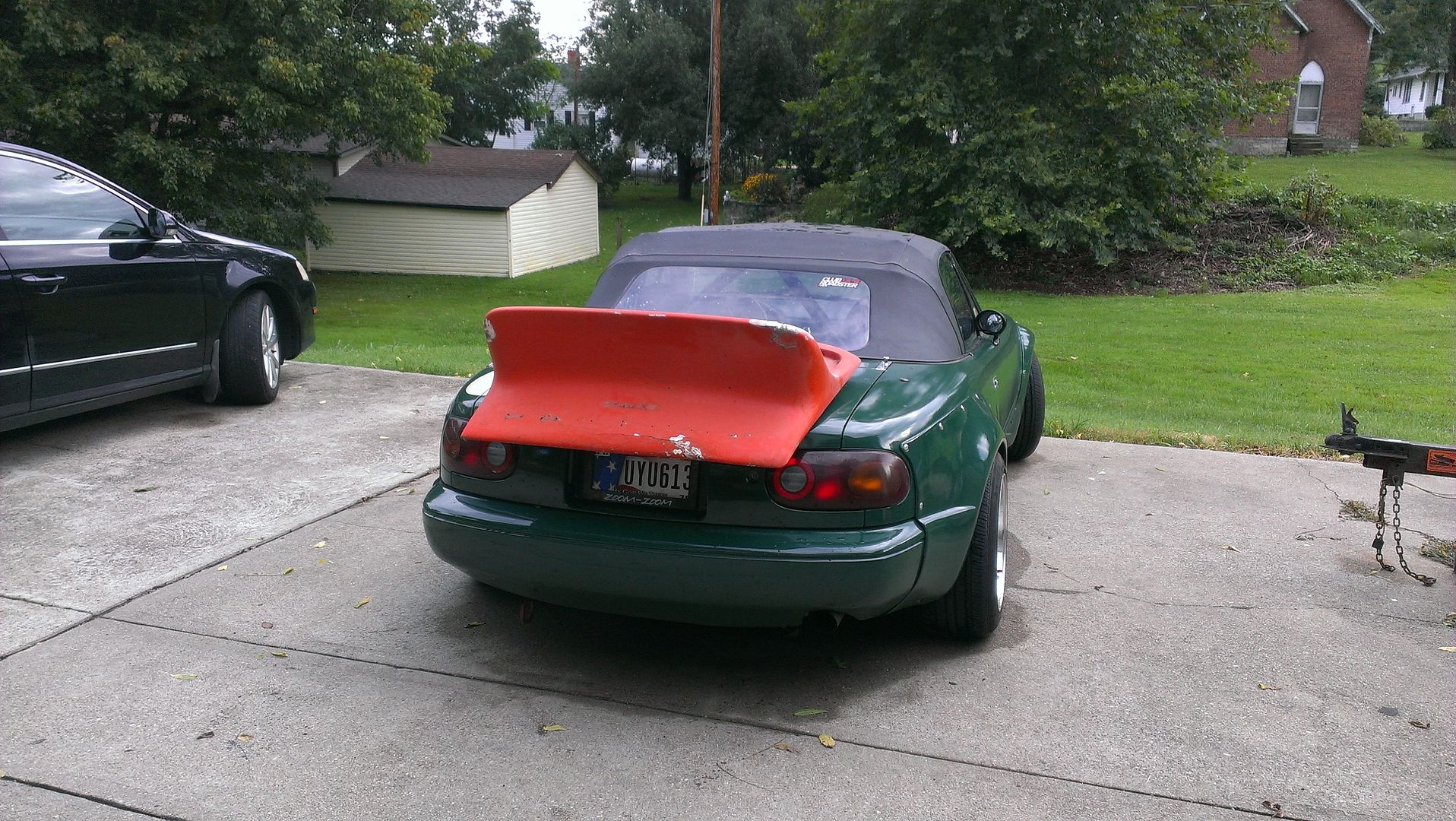

Dissembled and removed the duck tail and proceeded to install it on my other car.
looks like it had gold lettering.
I tried cleaning them up, but it looks like they tried to sand then down before painting them. The 911E does not look to bad however the P.O. had been sanded through in spots.
jarrodblake's Avatar
Join Date: Sep 2012
Location: patriot IN
Posts: 201

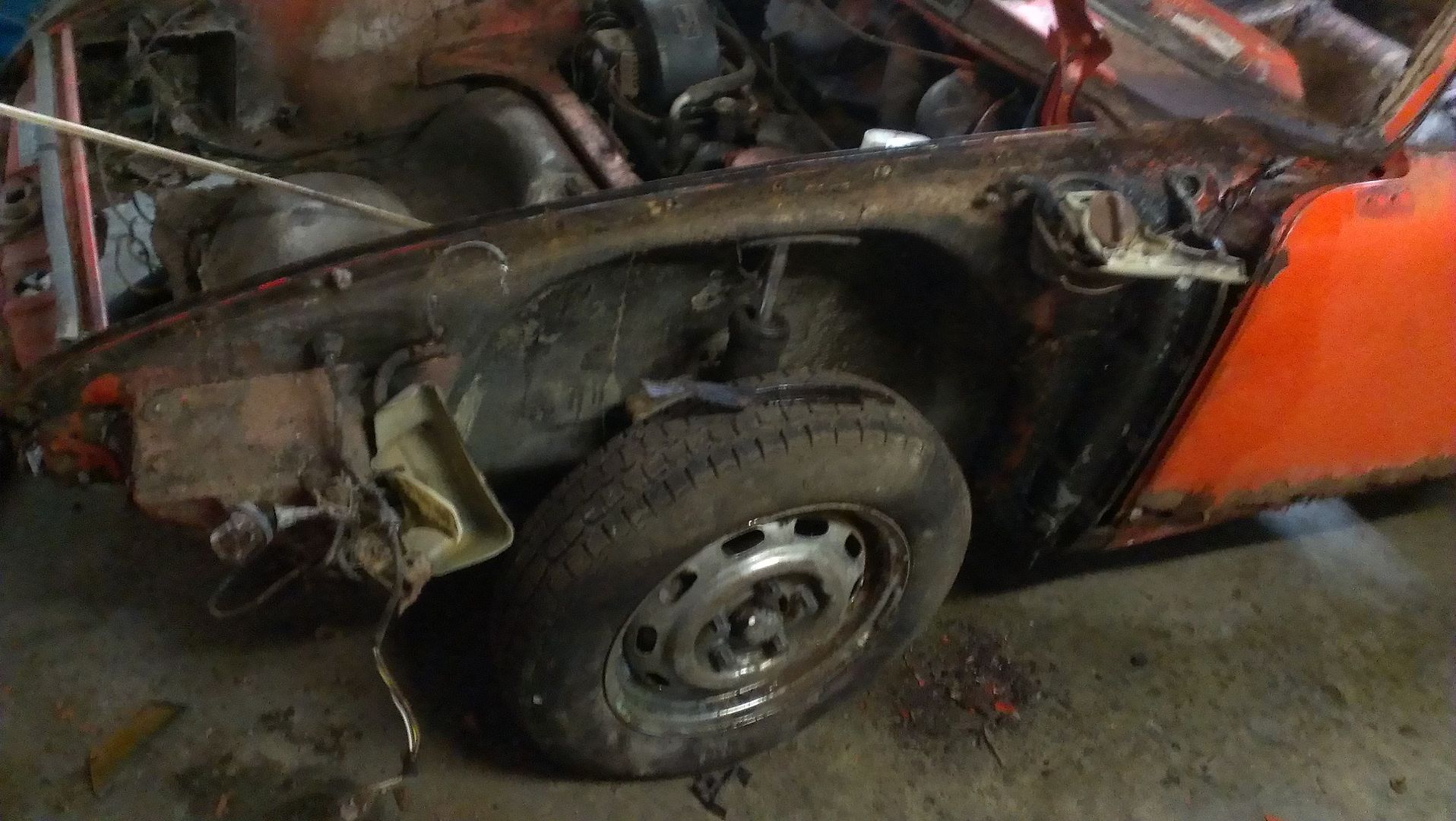

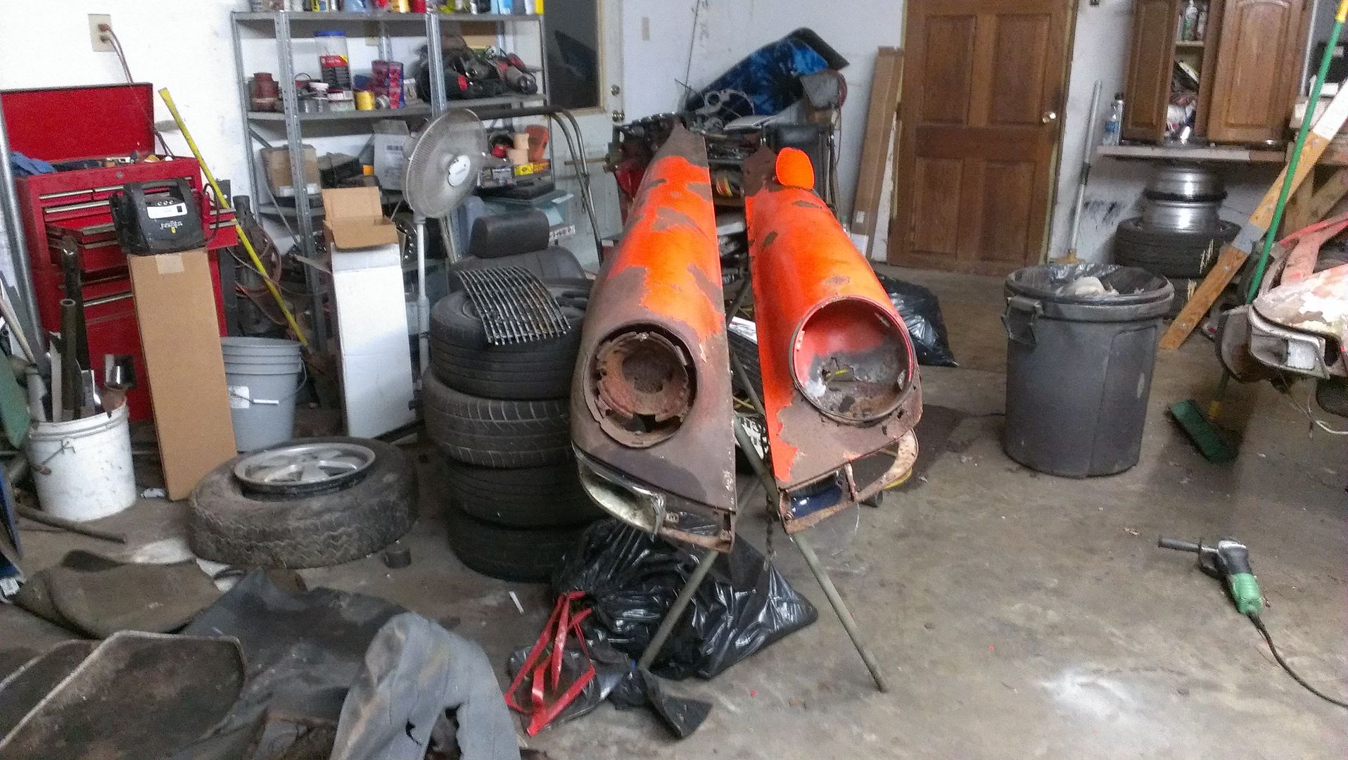

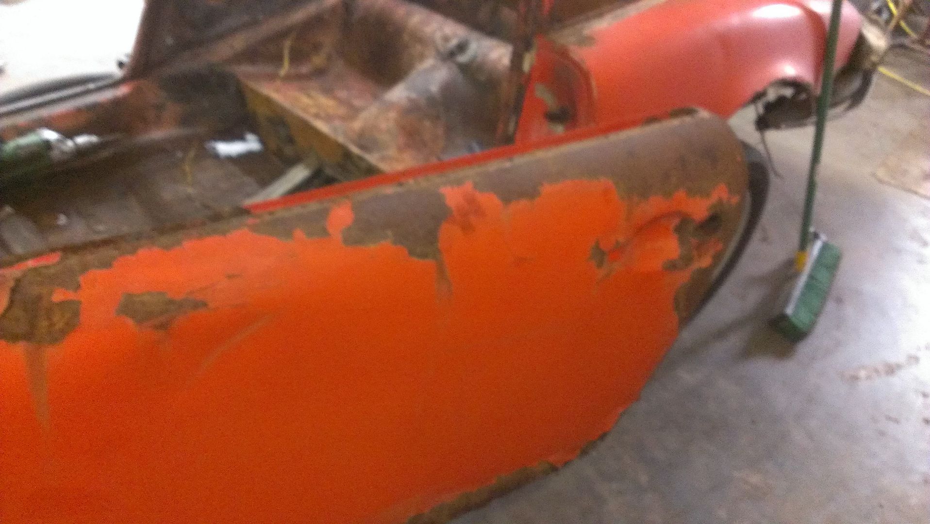

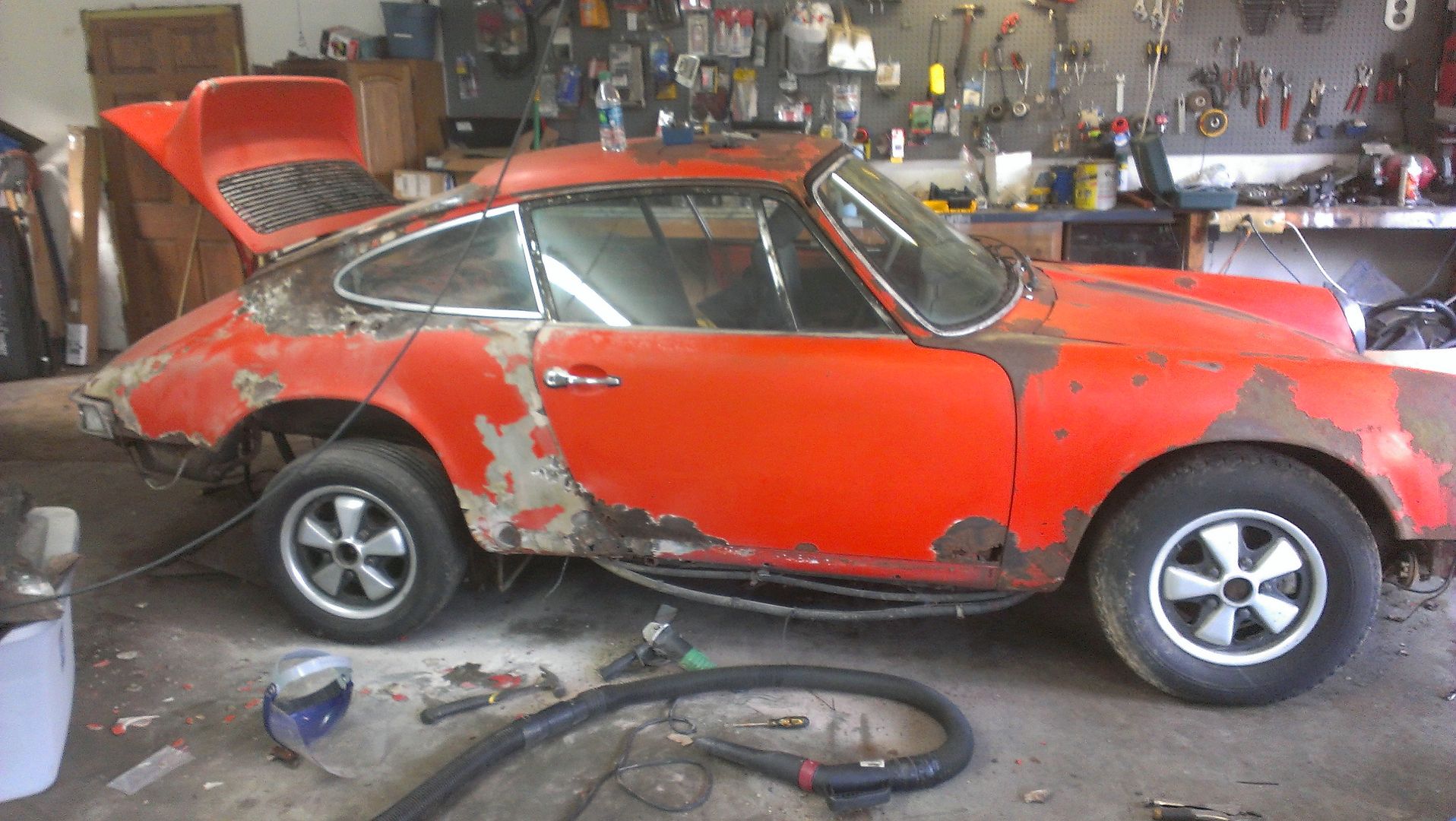

Removed the fenders.
Where I stopped tonight.
Hopefully this weekend I will finish striping it down. Then I will start building a car rotisserie for it, before I start media blasting it.

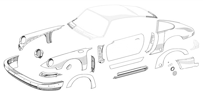

You might need this:
Here is the site for reference. I believe that once you find the parts you want, you can look them up and order them form our host.
http://www.restoration-design.com/mm5/merchant.mvc?Screen=CTGY&Category_Code=911-CHA

For now, don't unbolt the door hinges-- just pull the pins out. You'll want to preserve as much of the original panel fit (did I just say that?) as possible.
Old 08-21-2014, 06:20 AM
Dublinoh's Avatar
Join Date: Nov 2011
Location: Central Ohio
Posts: 784
Would it be wise to weld in some cross supports as well?

Love the porcelain passenger seat. Ha Great progress and great documentation.
