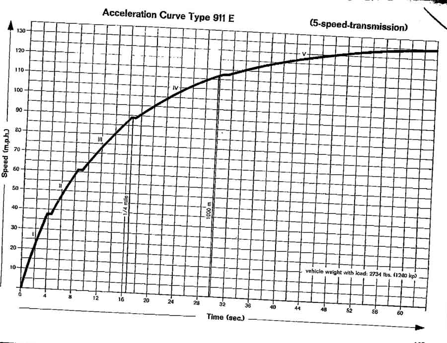

Question 2.0 E and S Horsepower Charts
Near as I can tell, the 2.0E and S models do not have HP charts published in any of the normal sources such as the shop manuals. While the peak HP and torque figures are commonly available, the graphs do not seem to be. Does anyone have an owners manual for either of these models? Does it have any HP graphs included? Could you scan or fax a copy to me?

Thanks to jstobo I've got a set of charts for the '69 2.0E. Comparing the HP chart to the earlier carb'd 2.0 with the same cams, it seems like the MFI makes for a flatter torque curve. So at least in this case the MFI car makes more torque both below and above the peak torque point then the carb'd version. BTW; the peak torque does not change.
Wow! Even with the 2 liter, the car is no sloutch with a 0-60 time of 8.0 seconds!
Does anyone have comparable data for the 2.0S?
