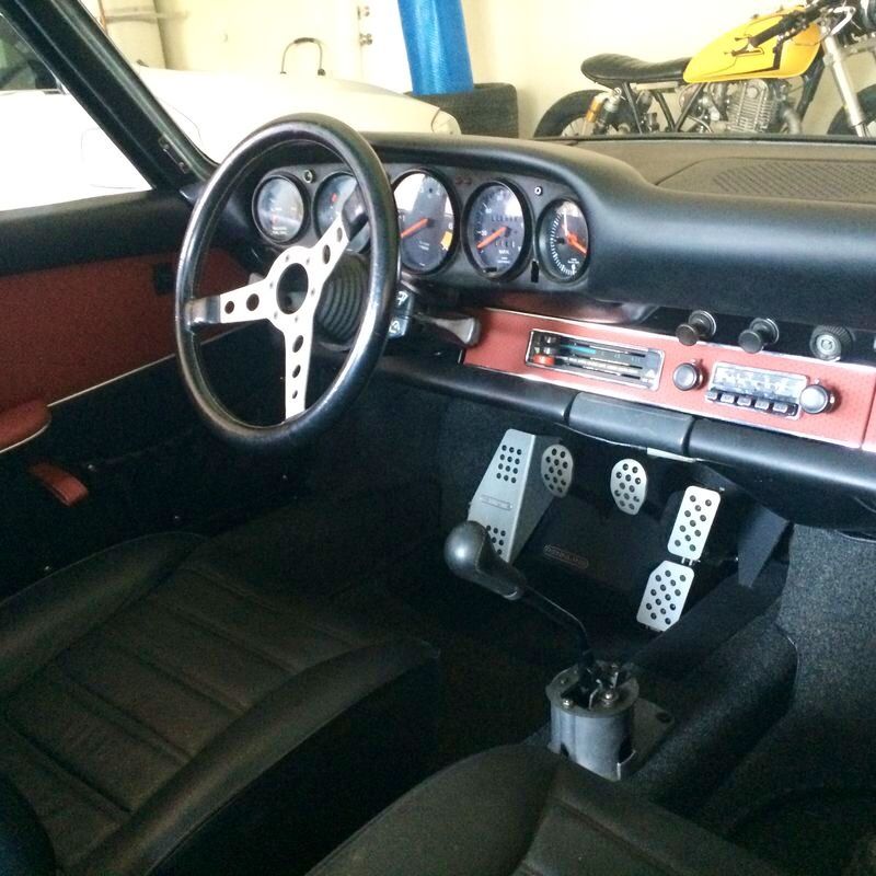

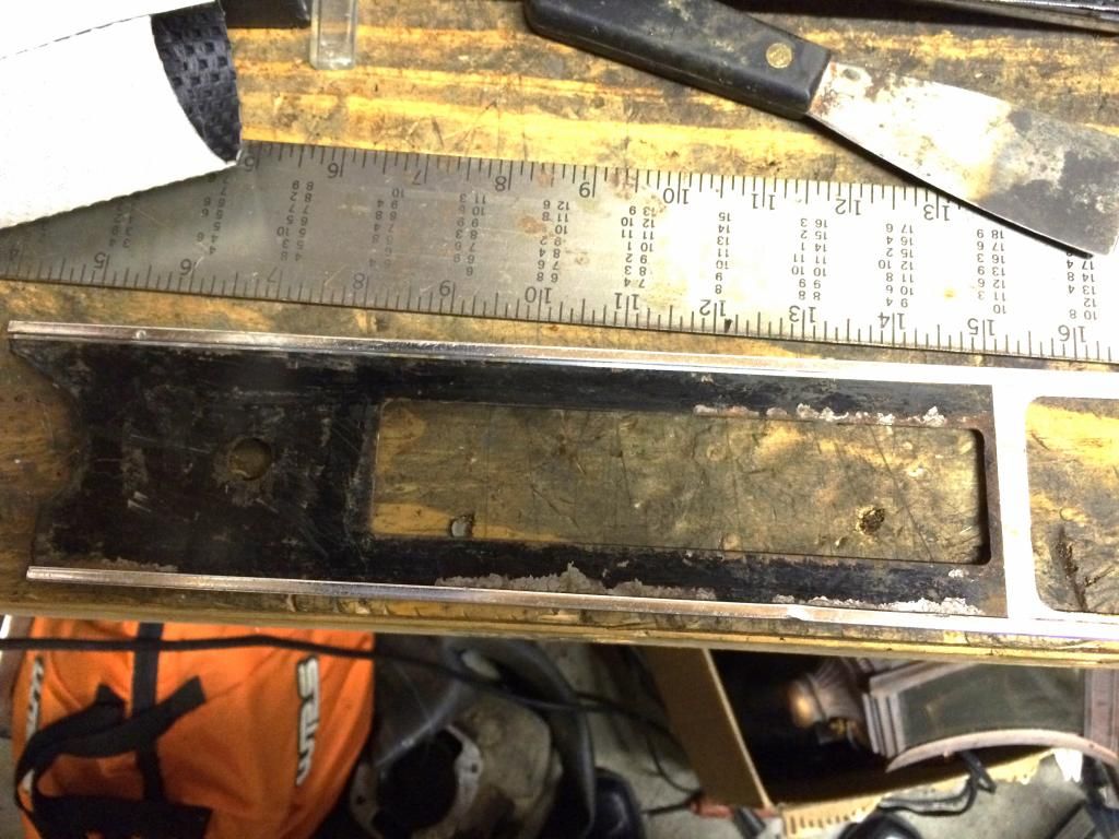

Here's the issue:
[IMG][/IMG]
The radio opening is so big, there isn't need the space to put down basketweave material around the opening. In the pic below that I took from someone else's post, there is a lot more space around the radio than my trim has.
[IMG][/IMG]fab_zps12e979b3.jpg.html][IMG]http://i592.photobucket.com/albums/tt7/TommyV9/White%201971%20911%20

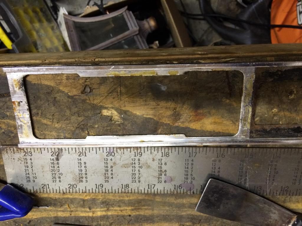

Here is the left side of the dash trim where the fresh air controls go. It has a steel plate that was glued to it on the face of the trim. Am I missing that piece on the right side for around the radio?[IMG][/IMG]

There's a backing plate for the radio missing. Just like the black plate for the heat etc. you can probably just fab one pretty easily.

I fabbed one for a radio delete on my 73.

Thanks, that's what I figured. I'm probably not going to do a working radio, but I may pick up a period correct non-working one to put in the dash. I just like the way they look. If I do music it will be iPod based with a bluetooth connection to an amp under a seat. I may have to buy the radio first and use it to get dimensions for the mounting plate.
