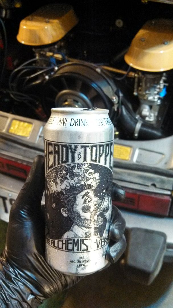

Can someone post pics of the throttle linkage connections coming from car to PMOs. Do you still use the stock throttle linkage plate that attaches to theblock?

83 911 Production Cab #10
JJ 911SC's Avatar
Join Date: Jun 2009
Posts: 10,535
No you don't. The linkage goes from a shaft located at #3 intake (inboard).
For a reference point, if you look at the left half of the picture you will see 2 of the 3 studs cover with red heat shrink where the old linkage was attached to the block.
Who Will Live... Will See
Old 01-28-2015, 03:11 PM
Join Date: Oct 2010
Posts: 124
Excellent picture, exactly what I was looking for.
