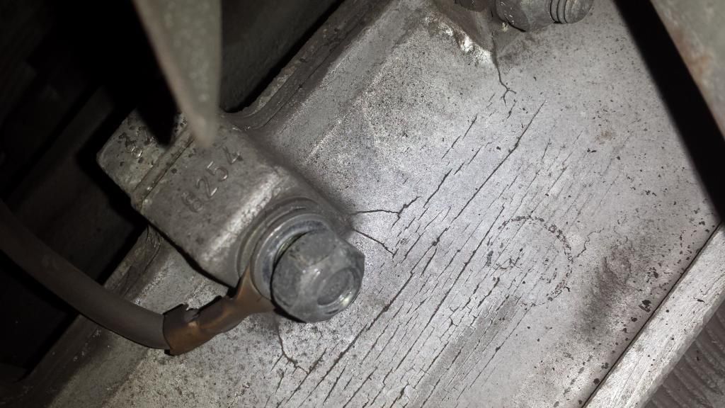

After a week out of town for work, finally made some progress! Last night the goal was to remove the fan/shroud, clutch assembly, and get it ready for the engine stand where I will work on removing the heat exchangers and cleaning it up.
Easy stuff first, got the shroud and fan removed. As you can see, it's becoming apparent I have a lot of leaky seals! Triangle of death, left chain cover, hydraulic tensioner lines, front main seal, breather cover.... these will all get replaced.
Should I be worried about these (what look like) hairline fractures in the case? Is this normal? Why does it look like this?

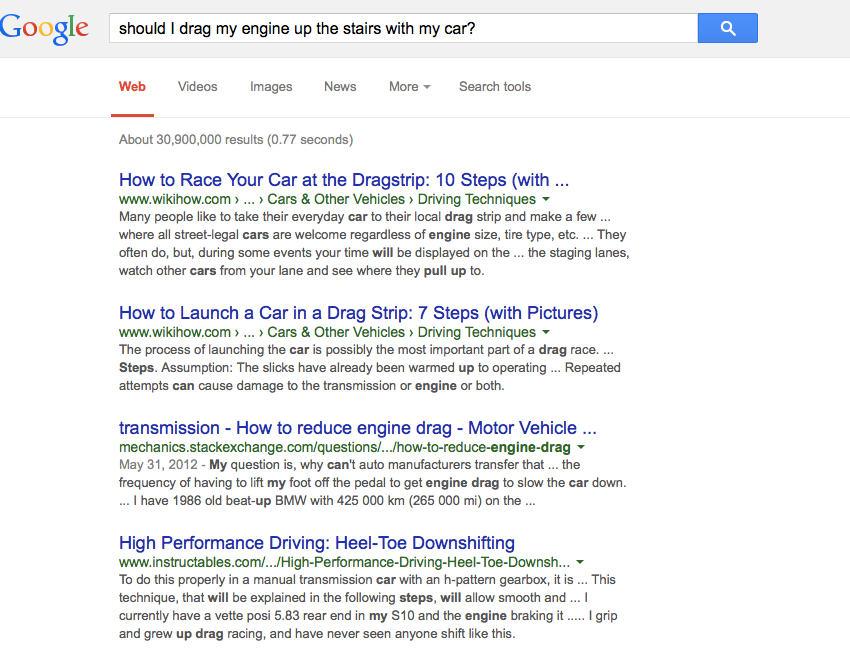

Originally Posted by Quinlan View Post
Get a good 4wd pickup with a logging chain. Hook the chain to the engine, leave LOTS of slack and hit the gas. One man job.
(I've never actually tried this, but in theory it should work. This IS the internet, right?)
Hmm... I googled it and the response seems to be positive...
