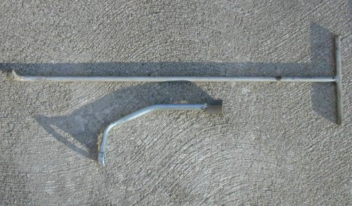

Bill Verburg 11-01-2002 12:41 PM
Here are 2 distributor wrenchs. The long thin 10mm at the top is the one that I used on my '69 boattail Alfa, apparantly they switched to a 13mm bolt sometime after '69. The lower one was a cheapie purchased at NAPA in '72, 13mm and just perfect for 911 distributors.

Thanks for all of the help. I tried with a universal but it hits the vacuum thingy. I will look at Napa for the bent wrench or flag down the next Snap On truck I see.
