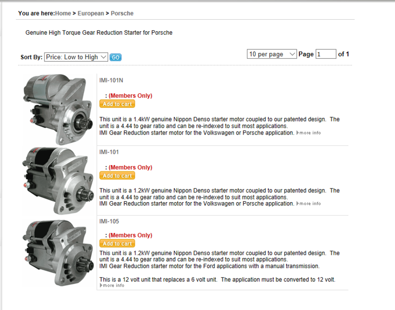

Model # of the hitorque starter
Good evening everyone
What model # do I need?
http://forums.pelicanparts.com/uploa...1541544701.PNG
