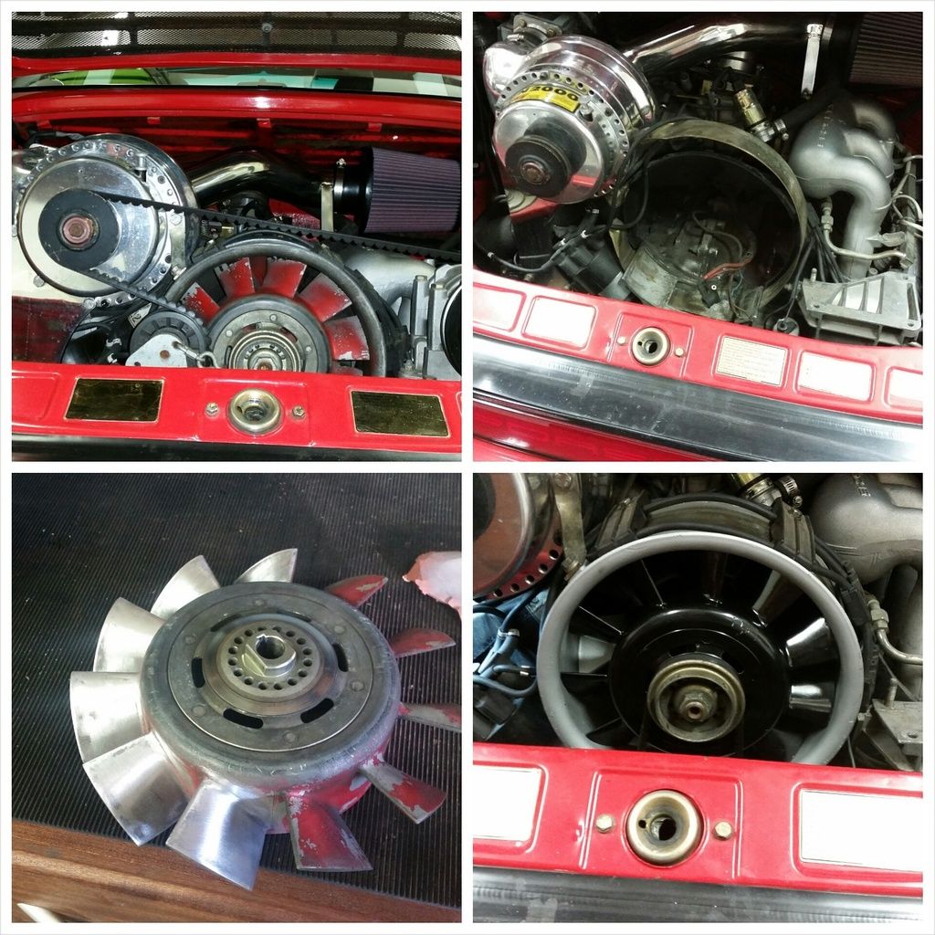

I had my fan shroud Ceramic coated in Cast Iron Gray. I chose Ceramic coating vs. powder coating because it is much thinner.
After that, I initially polished my fan but it looked to blingy for my taste and others on the board commented that it would be faded and back to original in about a year. Then I found a guy on this board (can't remember the name) who restores fans and that included beadblasting the fan, then clear coating, and then he removed the pulley and re-plated and then re-installed.
Cost of ceramic coating fan housing was $70 and cost of restoring the fan was about $125. Not dirt cheap but it looks fantastic and it was worth it to me.
Ceramic Coated Fan Housing:
Bead Blasted & Cleared Fan:
Put together - also ceramic coated the valve covers, same color:

Blasted, chromated and oiled:
