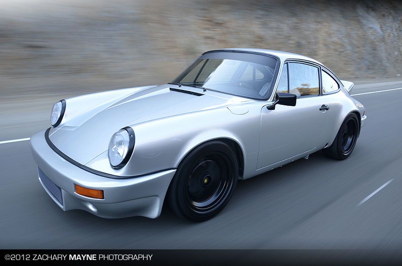

Tips for rocker panel delete in a 911 3.2
I am chasing this look.
Thing is, that is an SC, and I understand that the sheet metal around the rear torsion bars of a 3.2 are a bit hideous. Any solutions/experiences?
My plan would be to remove them, fill the holes, find a cosmetically satisfactory solution for the torsion bar, and then use Carrera side stripes to hide a respray of the lower portion (to cover up the patched holes).

Hi John,
The sheet metal around the TB covers is not that bad. It's worse around the jack sockets. To me it's not that bad. I got some pop rivets and painted them to match my car, then used them to fill the sheet metal screw holes. I chose a lower belt line to obscure the pipes and a/c lines and brackets and painted them satin black. It's not perfect by any means, but looks pretty good. Of course you could have the holes welded shut, body worked and then painted. That would be the best.
Your call.
Good luck,
Dave

This is an 84, my buddy welded up the little holes and I ground the welds flat. Minor prep and paint blend, we did the mirrors and sunroof delete at the same time.
The biggest thing is trimming the jack support hole, there is all this "stuff" around it that looks like a huge weld but its just some kind of foam. Clean out the foam and some careful work with a whizz wheel. Its really not too big a deal.
I have since stripped the oil coolant lines to their natural copper/bronze. I like it kind of a steam punk theme with the green.
I believe we had an issue with "blowing through" when welding up one of the holes, the metal is kind of thin. had to use a few tricks.

Originally Posted by Arne2 View Post
Yup, the change around the torsion bar holes was in '87 with the G50 transmission. An '84 looks exactly the same as an SC.
Great news! I was anticipating the fugly TB holes.
I expect having to re-paint under my rocker panels as it was a respray, and I highly doubt they were taken off for that. If this is the case, I will have the holes properly welded closed.
I too like the copper lines showing, and painting everything else satin black is a great idea.
Thanks everyone!

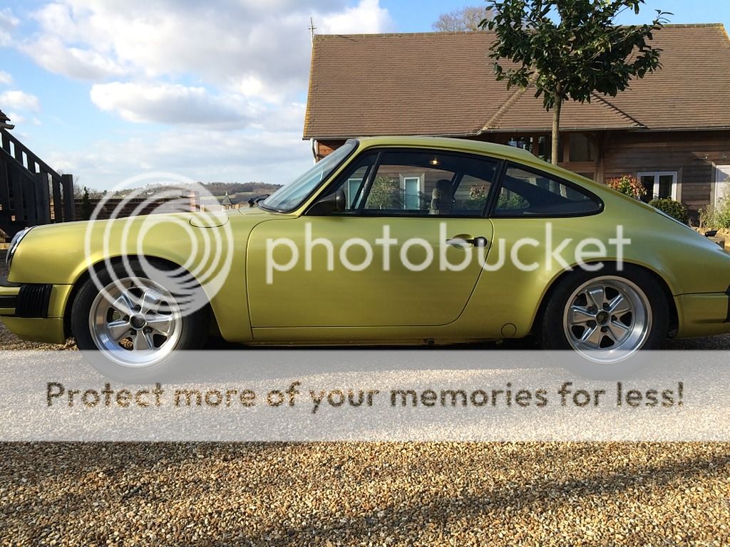

Jonny H's Avatar
Join Date: Jul 2013
Location: South East England
Posts: 1,706
Old 11-09-2015, 11:45 PM

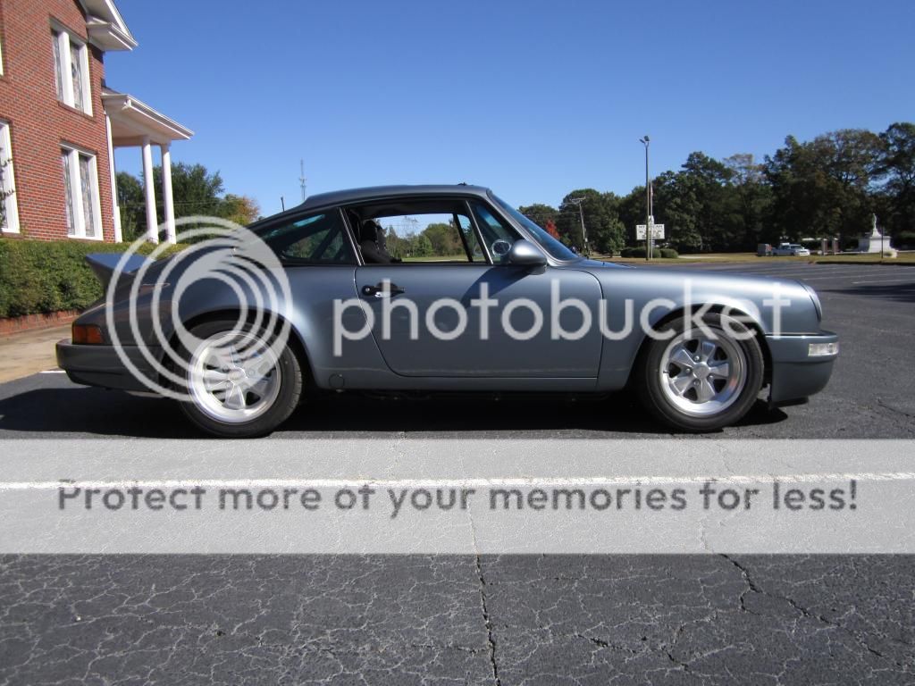

Originally Posted by Jonny H View Post
Stunner!!
Old 11-11-2015, 05:45 AM
Join Date: Jun 2015
Posts: 25
here's my SC

All these photos are helping me decide that my plan is an excellent one.
I like the flat black idea, but will see how my oil lines clean up. The carrera stripe will be needed to hide the lower paint work.
