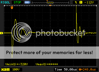

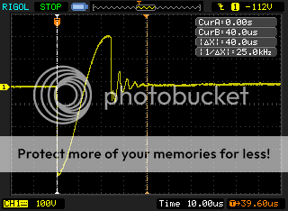

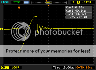

Originally Posted by wwest (Post 8906906)
The higher the pressure is in combustion chamber the higher the coil secondary voltage must rise in order to jump the plug gap.
Your statement implies that the voltage somehow increases to compensate. The CDI box design does not somehow magically increase its voltage and the current draw remains the same. In fact, if the resistance of the plug gap increases, the energy would decrease so less current if anything.
Here is a scope trace of the primary transformer (coil) winding of a Bosch CDI @ 2000 RPM. The first negative going (-360V) is the initial discharge, then the polarity swing to a positive (+200V). As there is no current flow at the top of the rise, the SCR switches off and the remainder of the charge is dumped (that's the wibbly bit at the end).
http://i804.photobucket.com/albums/y...psg7pnp7nd.png
Now, Bosch CDI @ 7000 RPM
http://i804.photobucket.com/albums/y...psktgjqkw4.png
What is interesting is that the primary voltage does reduce at higher RPM. I have seen some boxes fall to around 240V at the higher end. This is a shortfall of the Bosch inverter design. So more RPM ends up with a weaker spark in the Bosch design.
As you may know, my team (Classic Retrofit) have redesigned the CDI circuit from the ground up to iron out some of the shortfalls. Firstly our supply delivers a constant 300V at all RPM. This is 20% less than the Bosch design so puts less stress on the original coils. The coil does have to perform 'double duty' in our system as it is dual spark, right up to max RPM.
Classic Retrofit CDI+ @ 8000 RPM. Spark interval is 400us.
http://i804.photobucket.com/albums/y...pspiyhuzqb.png
But at 240V the spark voltage from the Bosch CDI is more than adequate as is the
spark energy (43 milliejoules - 1/2 X (240^2 X 1.5 x 10^-6)) at that voltage.

Jonny H 12-08-2015 10:16 AM
Porsche used the same CDIs as the production CDIs in all of its race cars without
any problems over the years. So to imply that the Bosch CDIs are lacking, is a
mis-leading.
I wasn't trying to suggest that the Bosch CDIs are lacking, just that the inverter design cannot maintain a stable voltage. I admire the designers of a piece of electronics that lasts 40 years!
I agree 240V is adequate but I'd rather know that the spark is the same all the time irrespective of RPM. Like you, I don't subscribe to the "more volts is better". If it is too high, you'll roast the coil and be susceptible to mis/cross firing if your HT insulation isn't 100%. Hence MSD require their own coil and aftermarket leads.
Anyway, you seem like a knowledgeable chap and probably know that already!!!
If 300V is enough to ALWAYS reliably fire the plug then the Bosch CDI will never have cause to supply more than that to the coil primary.

Jonny H 12-08-2015 12:01 PM
Originally Posted by wwest (Post 8909434)
Jonny, your lack of understanding of the theory of operation of a CD ignition surprises me.
For instance, why would you not at least recommend (require?) an upgrade to a E & I core transformer type "coil" when the advantages are so obvious...?
And: Perhaps the Bosch CDI starts with such a high initial capacitor charge so that the high RPM drop-off only drops to 300V..
That is not very nice insulting me is it? What have I done to harm you, exactly?
The original Bosch coil is a high quality item which is more than adequate. Many modern ones are poorly made in China, plus they look completely out of place fitted to our older German automobiles.
The Bosch CDI produces around 400V at idle and tails off up the RPM, so yes they designed high at low RPM because of that. We designed ours to be constant 300V all the time. Do you have a problem with that?
I'm not going to be drawn into a fight with someone who twists my own and their statements around to suit their own needs. I suggest you review what you said and present evidence (like I did) to back it up.
As a reminder you stated that the HT voltage rises with RPM and load:
"High compression, 40K volts.., idle, no load, 25K volts."
My traces show that the primary voltage actually falls slightly with RPM, from 360 to 300v. Given that the transformer is 100:1, the secondary e.g. HT voltages must be 36kV and 30kV respectively. So that is actually falling with RPM.
