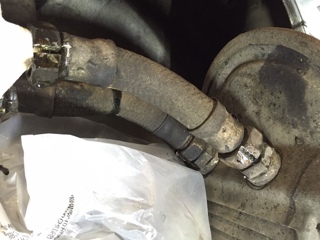

Tackled replacement of the flexible oil lines to the fender mounted oil cooler last week. Not an overly difficult job, but some parts were a pain in the butt as expected. The oil line nuts are steel while the oil tubing is brass and the oil cooler fittings are aluminum...this is a recipe for galvanic corrosion. You may have success with liberal heat, but the differences in metal would make this tricky; brass and aluminum will heat up much faster than the steel fittings potentially making them even harder to get off. I decided to just split the nuts in half using a cutoff wheel on a Dremel.

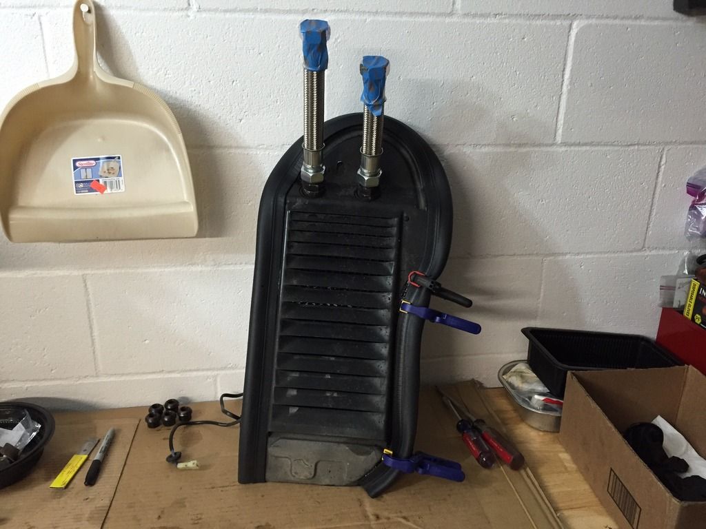

The parts used for this job...
-Griffiths oil cooler lines
-Seal for oil cooler shroud (OE or generic seal from McMaster PN# 12335A25)
-Lower temp fan switch from BMW, PN# 61-31-1-364-272-91-M36
-Foam seal around hoses PN# 930-207-361-00-OEM : This was probably not necessary to replace, my seal was in good condition still. I already had it on hand so i replaced it.
-Rubber oil cooler mounts PN# 930-207-239-02-M260 : Three of these are used, i broke one of them during removal due to a rusted nut. If you want to minimize downtime, consider ordering before hand. I replaced the two lower mounts as i broke one and the other was hard as a rock.

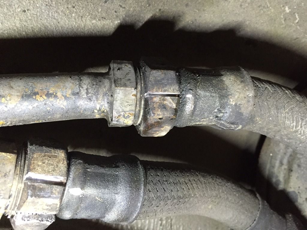

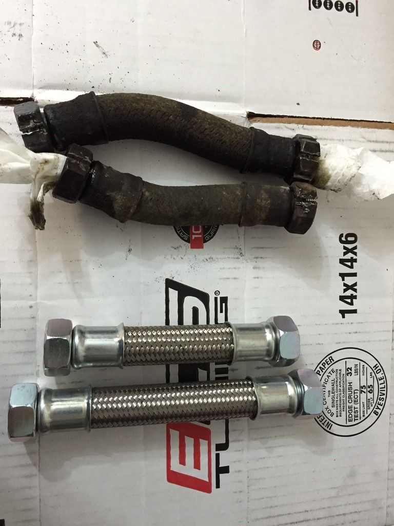

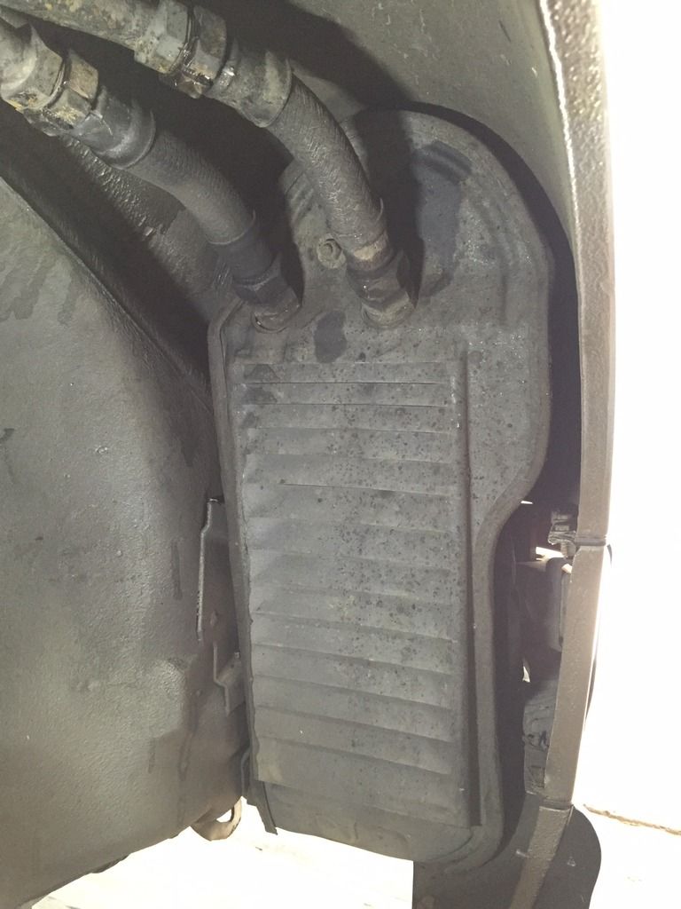

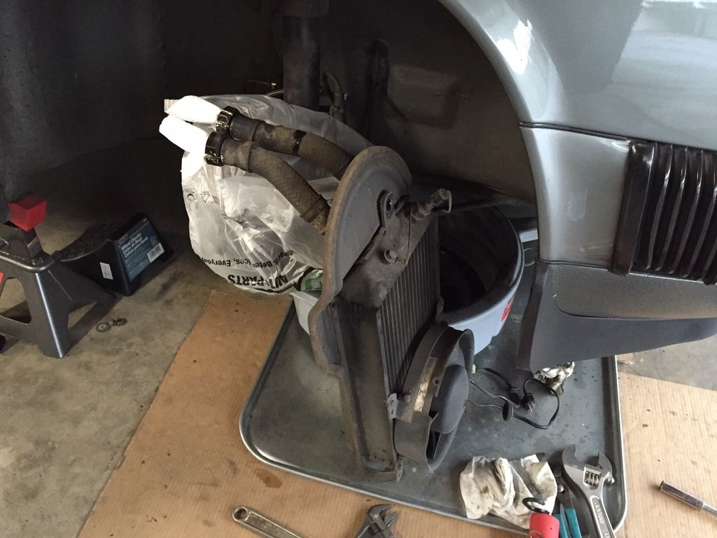

Here is what i started with; as you can see the shroud / seal was completely gone and the lines were original as far as i could tell. No leaks, but the return line looks like it was quite dirty indicating it may have been close.

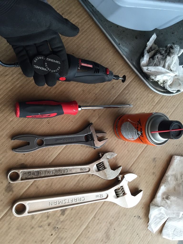

The only tools really needed for the job are a Dremel with cutoff wheels, 10in adjustable, 12in adjustable and a flat tip screw driver. If you have the proper sized wrenches though the oil lines are 36mm fittings, to counter hold the oil tubes are 30mm and the fittings on the oil cooler are 32mm. Also put a plastic bag over the hub / rotor / caliper as some oil will drip down on it.

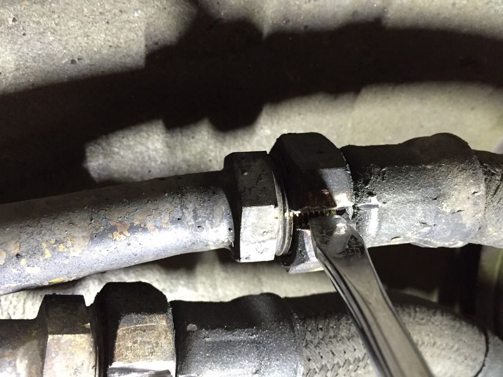

I sprayed Kroil on the fittings over a few hour period but still was unable to loosen the fittings with the wrenches. Space is limited and the adjustables offer limited throw, i decided to just cut the nuts in half using the Dremel. Here is the initial cut i made, i started on the tubing side first.
From this point, i kept checking every few seconds to make sure i didnt cut too deep. Here you can see i just barely started cutting into the threads on the tubing. Getting to this point took a little under a minute. Just go slow so you dont cut too deep into the threads.

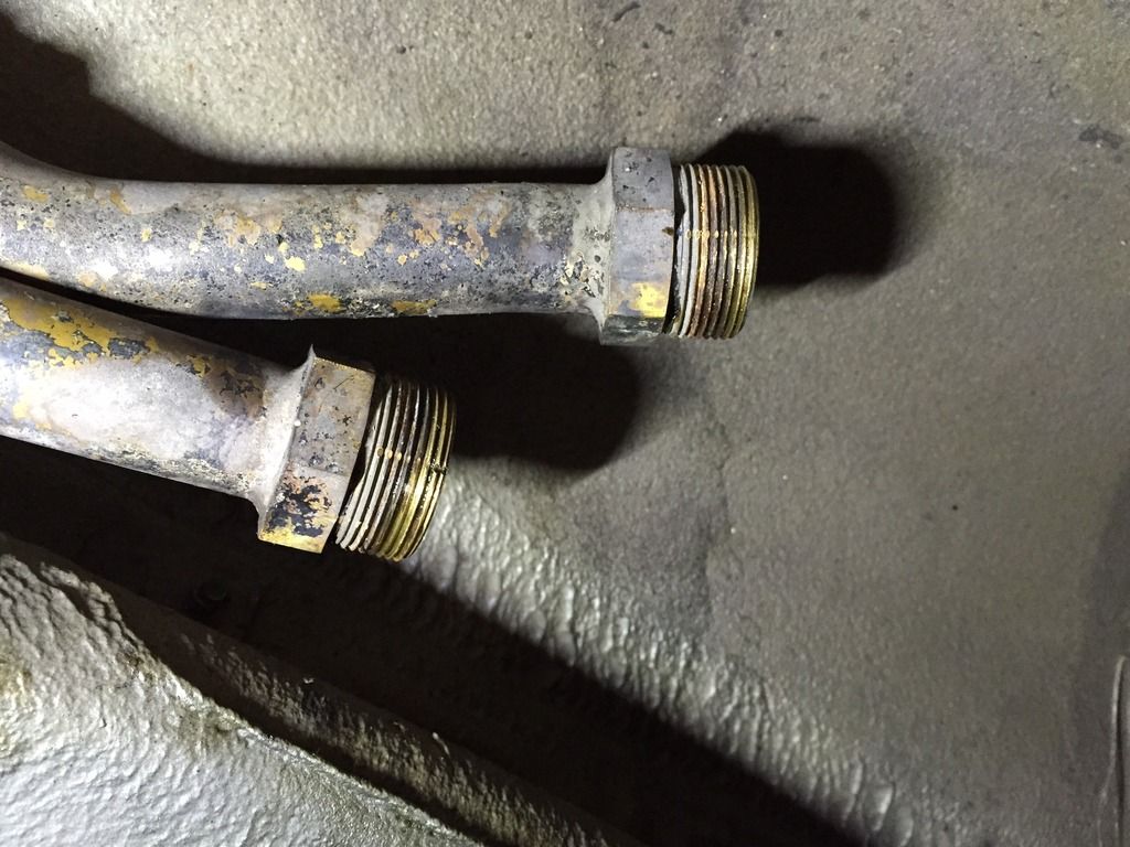

I think i made one or two more passes with the cut off wheel at this point, i stuck a flat tip screw driver in the slot and twisted, with very little force the nut split right open. With the tension off the nut, i was able to spin the fitting off the wrenches without much effort.
I had to cut a fair bit deeper on the cooler side in order to get the nuts to split.

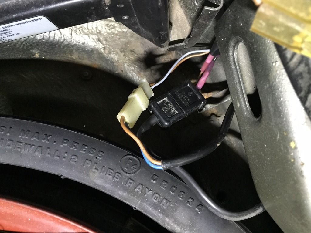

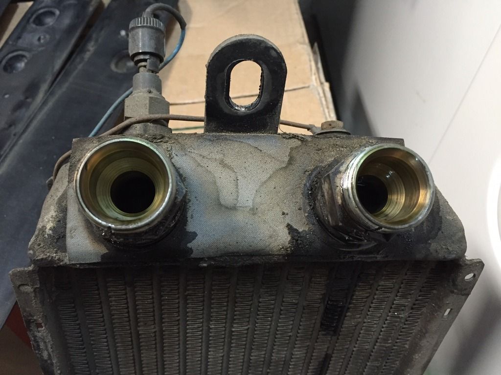

I removed the three 13mm nuts for the oil cooler mount, then disconnected the harness for the fan switch and the fan itself. Pictured are the connectors located by the spare tire. Once disconnected, push the wire grommets through and feed the rest of the harness through the holes in the body.
The harness / grommets as seen from outside the car.

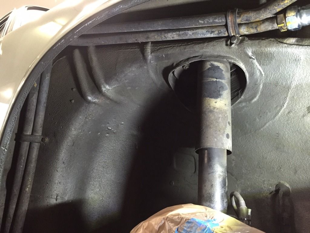

With the harness free, you can now wrestle the oil cooler out. Be prepared for the amount of sand / gravel that is going to drop out.

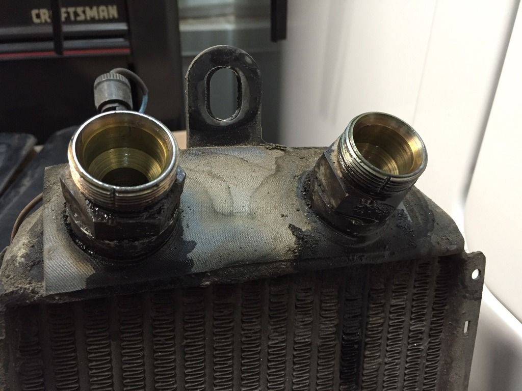

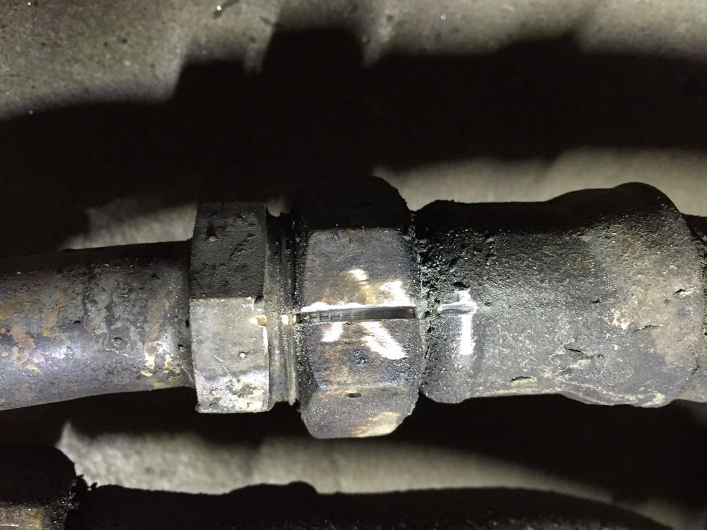

Shown are the cut marks left in the fittings. You can see on the brass tubing i just touched the threads and on the cooler i had to go a little deeper. The fittings are a conical seal, so this will not affect the integrity of the fitting.

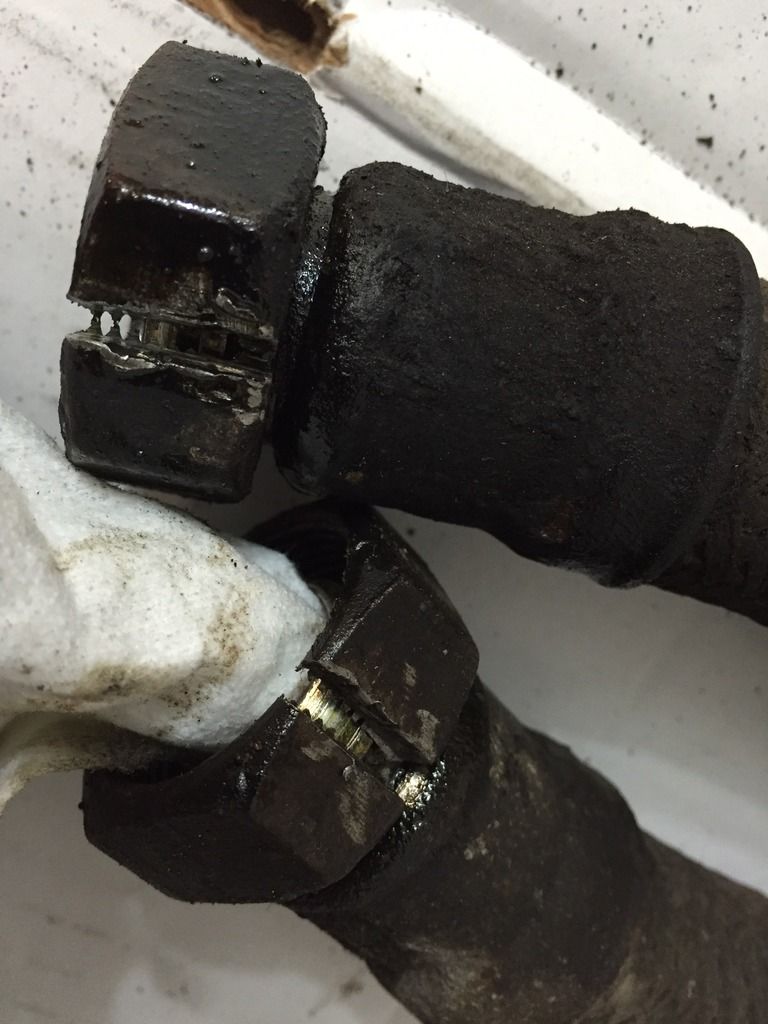

Close up of the cut nuts on the hoses.

The replacement oil lines are from Griffifths and are available from our host. The hoses are very good quality with German made fittings. I would flush both oil lines out sufficiently with water, i found a fair amount of metallic dust inside the hoses, probably from when the steel braided line was cut.
You can see i also replaced the fan switch with the lower temp one from a BMW; part # 61-31-1-364-272-91-M36 . This switch will turn the fan on at 196F rather than the stock 248F. To wire the switch, i cut the old connector off and crimped a spade terminal on. The original ground wire that mounts on the cooler was moved to the switch.

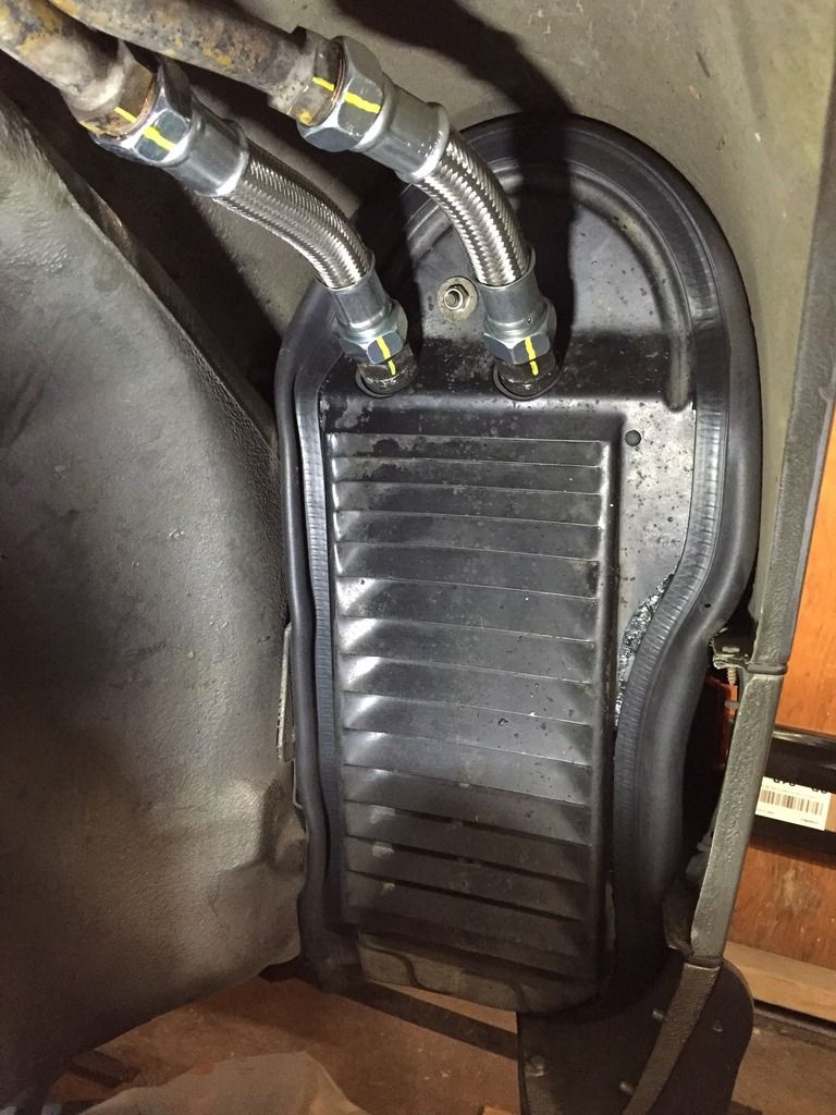

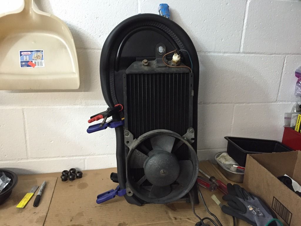

After reinstalling the cooler, i found that i had to remove the clamps for the oil tubing. This gave me enough flex in the tubing to get the new hoses connected. Once the hoses are threaded on you can refit all of the body clamps.
And here is everything back together. The seal for the shroud fits pretty well, but you can see it does not extend out far enough up against the bumper. I plan to use the left over piece of the seal to cover the last part. The OE seal is $100, so it comes down to if you want to save $80 or not.

Nice work. I noticed the little yellow torque stripes on nuts - I do the same thing with critical fasteners (common in aviation applications).
Did you use any sort of anti seize on the threads?

You can buy a small piece of backer bar to install in that hole. Backer bar is made to fill holes in log homes so you don't use as muck caulk. I have several feet if you want I'll send you a foot long piece.

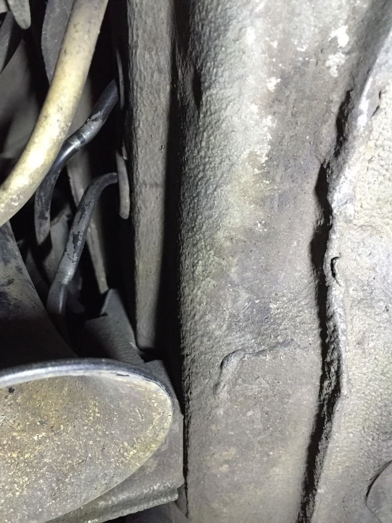

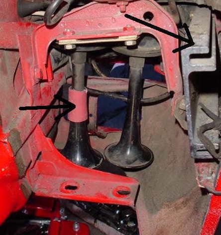

I can't tell, do you still have that big fat hunk of c-channel metal between the cooler and the bumper? I thought that kinda filled that gap up, and it doesn't look like you still have it.

KNS, i work with a lot of heavy equipment in my day job so its a habit i picked up. I have a bad memory also so i am usually second guessing myself if i remembered to torque something. I did use liberal amounts of anti-seize on the threads of everything. Hopefully this makes disassembly in the future easy if required.
Pazuzu, any pictures of what your referring too? It did not appear i was missing anything going off the part diagram in PET, but after 160k+ miles its possible.
From this thread:
'88 911 Bumper Removal
You can see a few pictures showing the big c-channel protection bar that bolts to the bumper and protects the oil cooler:

Thanks for the link, i am definitely missing that piece. Ill have to poke around for one. PET does show it as part #2 but does not list a part number or description. Anyone have any other info on that piece? Purpose or better picture? Looking at the PET diagram it appears it only wraps around 1/4 of the bumper on that side.
I found this also from a very old post, arrow on the right;

Lot of guy's don't reinstall that piece. It's there to reduce damage to the oil cooler during a accident. In 1974 the car's were mandated to withstand a 5 mph crash with little or no damage to reduce insurance claims. I may have one of those if you want it send me a PM.

I went quite a bit deeper on the cuts on the oil lines, unfortunately! Given the conical fittings, I am thinking the "cone" will support any loss of integrity by a cut in the threads. What do you think? How is your installation holding up?

Garment, no worries. The threads do not do any of the sealing so as long as you can still thread on the fitting you will not have any problems.
