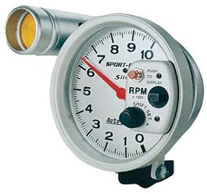

I wonder why they cut the wire. So weird.
obscene 06-07-2016 05:53 AM
to install one of these bad boys!
http://ecx.images-amazon.com/images/...VL._SX300_.jpg
