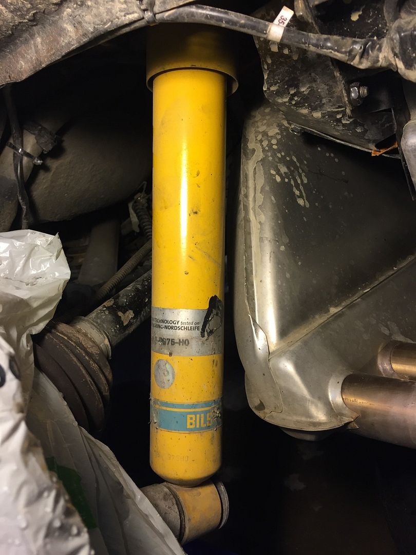

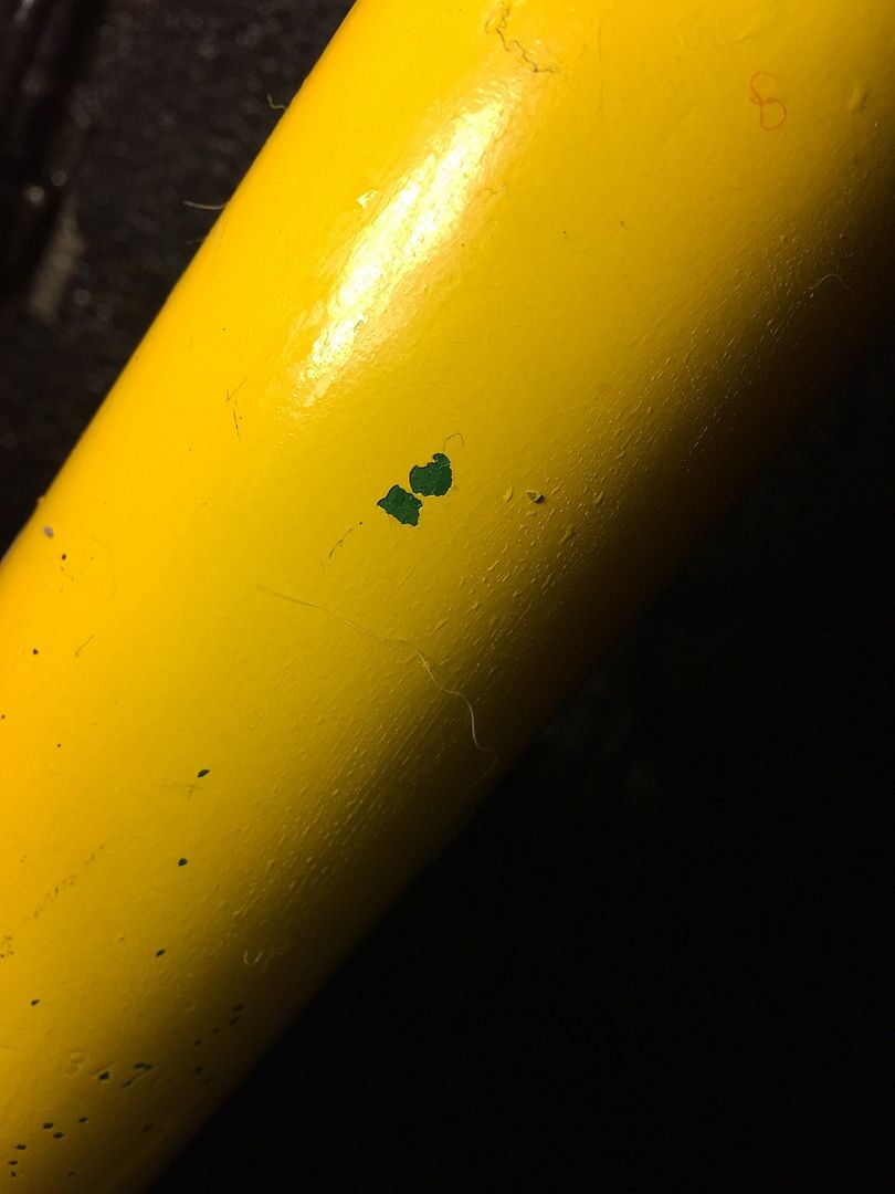

The 3.2 had a broken head stud and pitted cams. Clutch was ok but at end of useable life on inspection. Shifter was so out of synch that it was hard not to catch reverse shifting down to 4th. IT was so poorly aligned that the block out tab could not engage. Needed synchros for 2 and 4 soon, "fresh" RA1's were basically bald, he did his own valve adjust (remember, broken head stud), the reminder was about right. We are now questioning the torsion bars, but I will not jump on that. New bilstein sport shocks all round... well the rears looked new. the fronts were a bad repaint from green. There were only SS front brake lines. And it was a repaint frame damaged car, and the seller played dumb on the overspray.
So lets just say that I would not be surprised if my front shocks, and torsion bars were not as advertised. But who knows. I will find out.
on the topic of shocks... check this out.
front
http://i1168.photobucket.com/albums/...ps0qztzgfg.jpg
Bilstein?
http://i1168.photobucket.com/albums/...pslgw6rtpb.jpg
note the green under the chips. HD's are green, as are some front sports I understand.

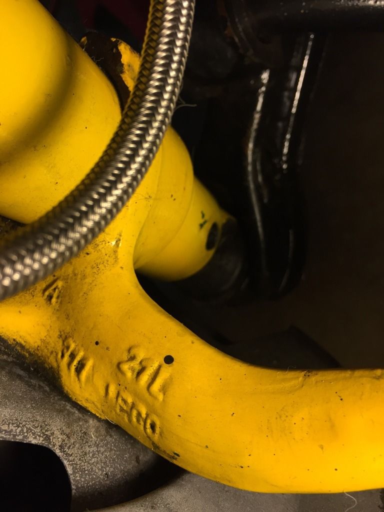

rears looking more legit. Wonder what that number means? just a production number? Any way to id sport shocks visually?
http://i1168.photobucket.com/albums/...psxmd8pdxl.jpg
Need to verify the front torsion bars when I have the time. If they are legit, I am more willing to believe the rears are as advertised also. Mind you, much of my car was not "as advertised", so all bets are off.
