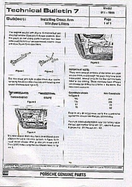

cary 01-05-2003 08:57 PM
Tech #7
I made a mess of that. LOL. Here is #7 from my parts book. Sharpened. We'll see.
It don't like me the second time. Say's TOO BIG. It's only 632. So I don't know what I did. ??
cary 01-05-2003 09:01 PM
One more time :(:( :(
I GIVE UP..........:( :(
cary 01-05-2003 09:09 PM
OK, I'll use the back door.
Using Multiplehttp://forums.pelicanparts.com/uploads/Tech7-22.JPG
cary 01-05-2003 09:11 PM
Still worthless..........sorry:confused:
RoninLB 01-05-2003 09:32 PM
I'll try
http://forums.pelicanparts.com/uploads/window5.jpg
