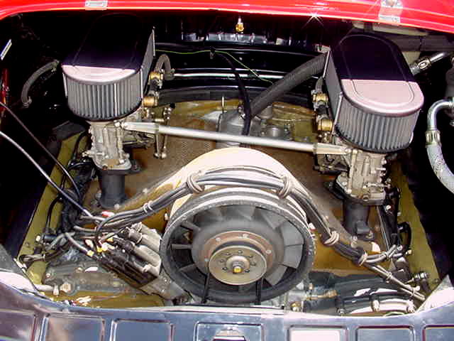

I've been browsing old posts about the 911R and came across this photo.
I only noticed because of my recent carb rebuild, but the intake manifolds are much higher than stock.
Why? What does the taller manifold do for performance?
Greg

Longer tubes are for peak horsepower at high RPM levels...at the expense of torque range. These look high enough to produce some harmonic wave technology as well, giving a bit of positive pressure just as the intake valve opens. Sort of like free turbocharging...keep in mind, at the expense of torque range...the 911R was really too peaky to be a street car.

Thanks Paul. Sounds like a cool effect, but only really functional at continuous high rpm, eh?

So if Irun the shorter manafolds on my rs spec 2.7 with S cams I will do better in the lower RPM torque range???

I think that the idea is right but you might have it backwards...
1) Longer intakes are tuned for lower rev's (relatively speaking). Why? Think of a trombone: longer pipe = lower frequency (pitch). This is why most EFI'd cars on the road have intake manifolds which curve over and appear to be at least 5 or 6 inches long -- and most car's on the road are not tuned for high rev's. Note that this doesn't take into account harmonics (2x the freq, 3x the freq, etc) of which there are more in longer pipes and fewer in shorter pipes. So it's actually possible to get longer pipes to be tuned to more places in the rev range then shorter pipes.
2) Why would a 911R have longer manifolds then a stock 911T?
a) Packaging? Note that the 911R doesn't have a full airbox over the carbs like a T does. Without the airbox they may have used longer pipes because they could.
b) I've been told that longer intakes are less prone to "reversion" which can be a big problem on cars with cams with lots of overlap (something that the 906 cams in the 911R had a lot of ). As I understand it at low rev's the pulses up the intake will hit a resonance and create a cloud of fuel droplets floating above the mouth of the carb - a bad thing! By making the intake track longer the frequency of the intake no longer matches that resonance and so the cloud disappears. At higher rev's this would not be an issue since the air would have a lot more velocity and inertia into the cylinders.
But keep in mind that tuning intakes is not a linear function. I recently read that Honda RA122E/B 3.5 Liter V12 F1 engine used variable length intake trumpets. But it was not as simple as long = low speed and short = high speed. Rather the funnels were raised and lowered over a 25 mm range (~1 inch) 3 times as they engine rev'd from 8000 RPM to 15000 RPM in order to fill in some troughs on the power curve. (Classic Racing Engines - Page 209. GREAT BOOK!!! It's also got at least 5 Porsche engines in it!)
By the way - going back to trombones. Trombone players can hit at least 2 or 3 different notes at each slide "position" based on how tight they purse their lips. So in engine terms, 1 intake length may be correct for 2 or 3 different engine speeds. (Forgive me if there is anyone on this BBS who plays or played the trombone. I spent my musical career as a drummer - so feel free to step in and correct me!)

PMO's custom intake manifolds are also taller than stock. More like halfway between the two extremes of stock & R as shown here..

Don't forget that by moving the carbs away from the heat source is also an effective way to stop fuel percolating.
